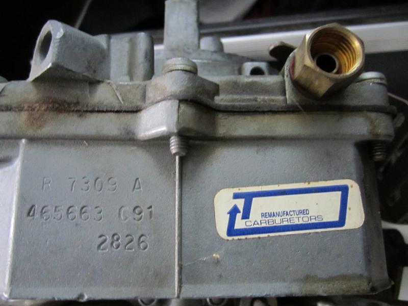

That's a Holley "Gold Box" electronic ignition, correct for the model year. It does not have breaker points or a condenser. So no need to worry about dwell angle adjustment. That is just a plastic dust cap under the rotor. It can be carefully pried up around the edge for inspection, but there's really no need to since the engine starts and runs.

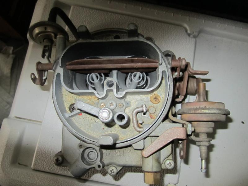

Abusive amount of pictures inbound! This 345 has been sitting since 2009/2010, health issues mean it lost the spot it was sitting at. Cleaning a bunch of stuff up and today was tear down and clean up the Carb while watching KOH day. Several posts of pictures inbound.
Starting off with some pictures of how it was set up in the truck. Firewall side
Drivers side

Working around to get a better picture of the choke controlled high idle cam
Vacuum idle control pot. I've got no use for it at the moment, it would be neat to use for high idle on demand though for whatever nonsense one could come up with :)

continuing to go around. Of all the silly things, I like the heat riser choke :lol: i've swapped all my electric chokes over to manuals, but this one gets to stay...it is juuust complicated enough to be fun. The vacuum nipple on this end is ported i.e. draws from above the throttle blades
