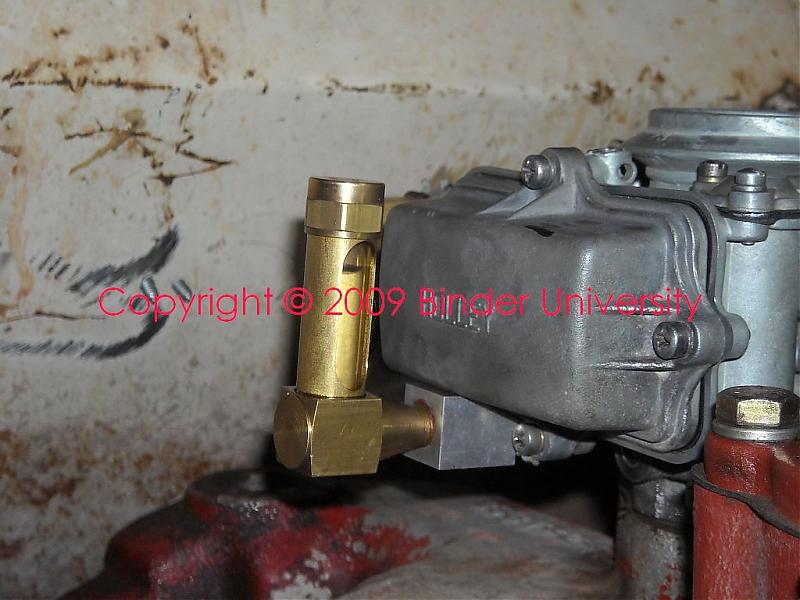

As for the "Ford" connection...the Holley 1904 was introduced to the oem world around 1951 as a mixer for the much more common in-line six cylinder engines of that era. And at the time...Holley corporate had a very strong connection with Ford that goes way back in history. Same for the Holley oem-supply connection with International Harvester (as well as with zenith). During that same era, the GM family was closely aligned with rochester, thus the family connection on the GM side.
The glass bowl version of the 1904 was a very unique product that allowed the actual fuel level in the bowl to be monitored in real time. In many cases...that variation of the 1904 known as the "visi-flow" mixer was used on many Ford apps, as well as other specific oem engines. But my research shows that they were never oem on any IH-related products but they continuously turn up since folks have rejuvenated boneyard versions of these carbs over time.
And normally, the visi-flow version used a cast zinc "extension" between the bowl and the main body to increase controlled fuel volume in the bowl, no doubt needed when those carbs were used on engine apps with increased volumetric efficiency (ve).

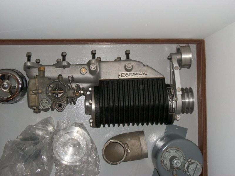

It is the picture / comments about this supercharger that got me here, but upon further review, it is not my supercharger. The dent in the carb is not in the same place and mine has been freshly rebuilt within the last few months. I am confident that the jsc in the picture is a model #190 for a 190sl. I would really like to find out who has it so we can compare notes. Does any one know the owner's contact information? What was the asking price? Can you tell anything about that carburetor in the picture? How does it compare to mine?
Yeah, I like your idea!! I used to have my tri-power on the coffee table as a conversation piece. Since we moved, I have yet to find the box that it is in!!!

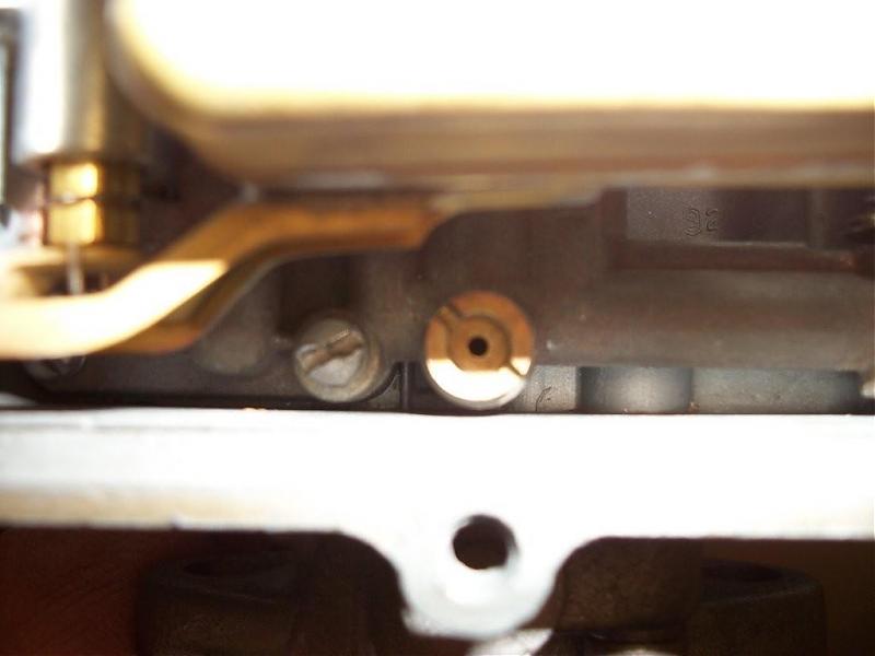

First off, yes...you did id the main jet correctly. So the carb I've prepped for ya has a #64 main installed now. Those jets are exactly the same identical part currently marketed by Holley, and the sizing system has never changed since the beginning. Some are manufactured in brass (older stock), later production are done in steel (to counteract the negative corrosive nature of methanol/ethanol, or today's e10 fuels).
The main jet simply screws in/out with a screwdriver that fits the slot properly. A major issue with these is a main jet which is "loose" allowing liquid fuel bypass, that is caused by the expansion/contraction of the dissimilar metals in the carb as it goes through it's routine "heat" cycles. If it's "tight" from the beginning, it will stay tight though.

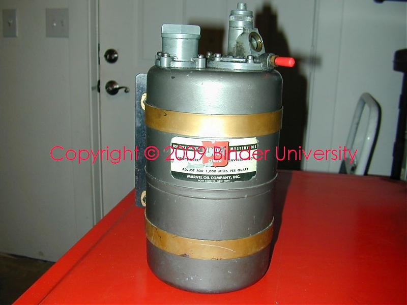

But...I see that you did get the marvel oiler with your system!!! Another piece of history that was a part of the judson deal, don't know if it was imperative on every kit install, but those were a very common add-on sold off the shelf in any parts house back in the day!
This shot is one that Jeff at ihon donated to our club for a raffle item a few years back, I see these fairly often on IH stuff up here that were installed on rigs from the early/mid-60's.

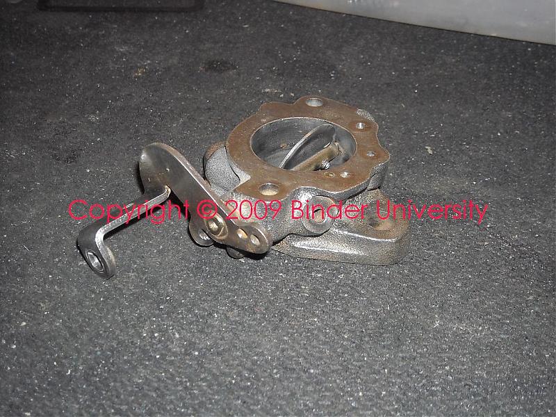

Here is a shot of a 1904 throttle lever/body as used on "most" (not all) ihc applications. This is the throttle body that I used on your fresh carb. These are very problematic in that where the lever is swedged to the brass shaft, they tend to loosen over time. So that is something I also "fix" in some manner when doing a rebuild, they all are crappy!
I'm just posting this pic so you and others can see some of what makes a "Ford" version of a 1904 different from some other apps!

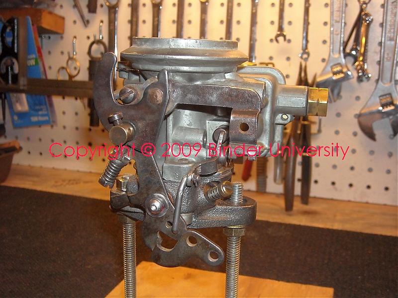

And this shot is the completed 1904 I have for you before installing for testing.
Notice the completely different throttle lever arrangement. And most especially, where the idle speed adjuster interfaces with the choke lever/fast idle cam. You cannot mix an IH throttle lever with the Ford choke lever if the "length" of the choke shaft itself is not a match.
Not all Ford versions of the 1904 were made like this, I have no methodology for identifying this stuff by list number, that is why I always need pics of what anyone has in order to determine "what" they got to begin with!
On that same note, compare this throttle lever with the modded version you have now. Appears that in the past, either judson or "someone" arc-welded that extension mount to the oem Ford lever. I'd say judson because you can see the same thing done on other examples of these parts I've found on the 'net. That could be done in a much neater manner though without welding!
In this shot, you can see that I drilled/tapped the throttle shaft and installed a stainless buttonhead to secure the throttle lever to the shaft, this one won't be giving any more problems! I'd do the same to your current carb when I build it.

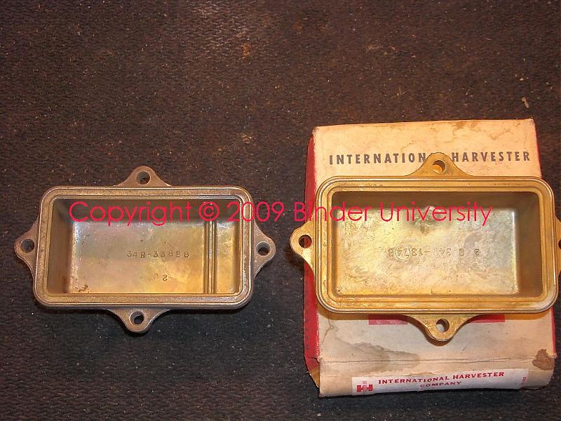

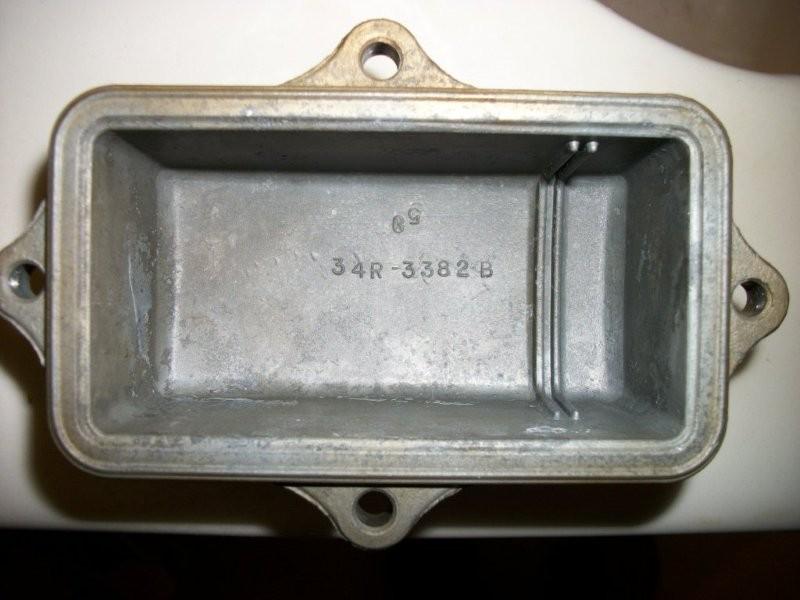

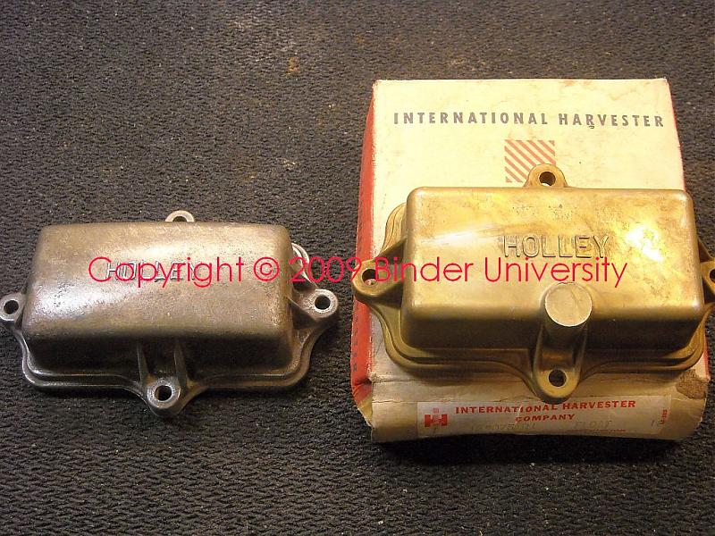

Here's a shot of the exterior of the two bowls I have available, you decide which one ya want.
I "think" that the nos bowl was originally cast for a tractor application that had a drain plug for the bowl. Or...it was used to mount an "adjustable" main metering system ("needle valve") so that the carb main metering could be adjusted for use with either gasoline or kerosene (or "drip gas"). So it is not an oem bowl for this exact carb if that matters.

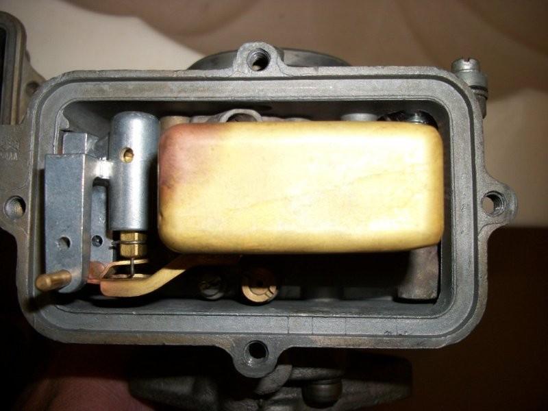

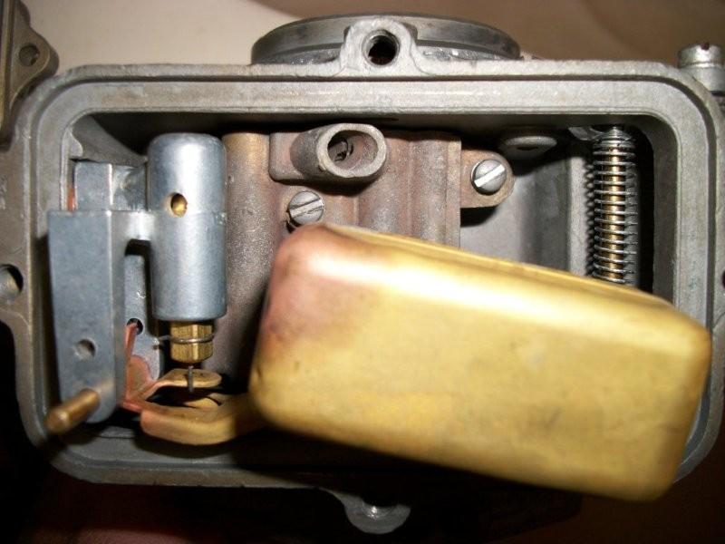

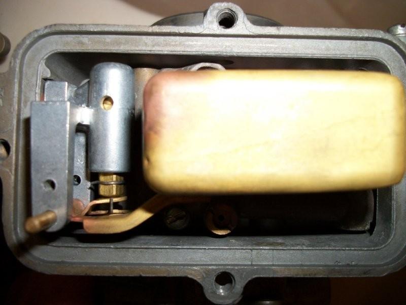

This shot shows the interior of both bowls, the used one is perfect, no water damage whatsoever and no warp!
The nos bowl should be saved for someone who is doing/needing a perfect carb resto and has a matching main body of similar condition. I have those on occasion, but none right now.

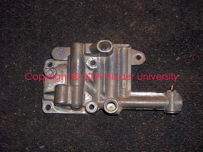

The main well for this carb is in perfect condition, though it has not been reconditioned by Robert since it does need his repair!
It has been totally disassembled as far as the main wells are concerned, along with having the accel pump inlet and outlet checks cleaned/replaced. This is the last good one I have on hand, all the rest are reconditioned units on the shelf at ihon.
By the way...Robert's background involves workin' with them flyin' wings too! So ya know he does purdee work! But he's kinda schizoid...works on junkiron along with high-end street rod stuff and vintage funny cars! But his junkiron is nice!

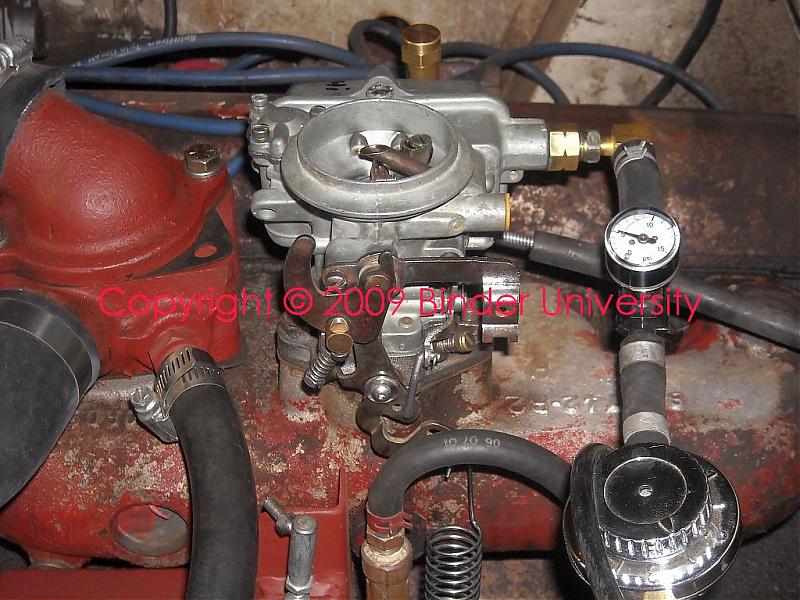

Here's the test run of the carb I'm pimpin' to ya Tom.
As ya can see, with a operational test inlet fuel pressure of 5psi, the actual fuel level is currently set to "high" (thus the note to myself written on the bowl).
When it comes off for the final install of the bowl you choose, the fuel level will be lowered before shipping.
This is simply a quickee install I do on my mule motor, no throttle cable connected, no choke cable connected, and a jury-rig throttle return spring for safety.

Here's the other side showing the linkage and all the busy work.
As ya can see, the el cheeepo fuel pressure regulator and gauge are set for 5psi. The pump on this motor will actually produce nearly 6psi...but the Holley-spec inlet pressure for these carbs is 5.5psi.
This is the last carb that will ever run on this intake manifold setup. Within a few days, a fresh, highly-modded intake manifold set up for a weber dgv carb will go on for final testing and leakcheck. Eventually, that intake system will be moved over to the 152 stroker (Robert calc's it to be a 172) I've got in progress right now, this motor is a 196c.I. Version.

No...the sight glass fuel bowl is not available...Robert fabbed two of 'em and they are both gonna stay on the left coast! But I hear he can dupe 'em all day long for $250 a pop or trade even-up for a judson kit???

Looks good!!! I think I will go with the bowl that is on the left. That appears to be the same as the one I have on the carb now. Clear acrylic spray sounds good, I don't like rust.

I am not certain, but I believe the oiler is mandatory to keep everything lubed properly.
It depends on where the line(s) are routed -- and if there is a return line...
On turbo-charged corvair engines, engine oil is used to lubricate the bearing in the turbocharger (metal line from oil pressure switch area). The oil "drained" into the passenger side valve cover after "going thru" the bearing.
If the seal failed, it was major mosquito abatement time...

A marvel oiler is designed for the contents to be inhaled by the engine and consumed in the combustion chamber. Those devices went away right after positive crankcase ventilation systems became mandatory by the feds around 1961 in the u.s. Market. In the case of the judson unit, the only way they could be lubricated was with the marvel setup.
A turbo must have a pressure-fed lubrication system, just like an air compressor system on a medium/heavy duty truck for air brake and accessory operation. The turbine setup in a turbocharger spins at a far greater rpm than the rotor or impeller set in a supercharger driven by the crankshaft in either under-drive or over-drive config. And a turbo...by design...reclaims and converts a tremendous amount of heat!
All ihc-produced I-4 and sv cylinder heads have a drilled/tapped/plugged port in one end which is for an oil return line for an air compressor-equipped engine app.
Don't know about that "pot" terminology in regards to this system??? But...when I first realized that these huffers used the 1904 mixer, I thought then that it was a strange choice of carb...but they were dirt cheap and plentiful at that point in time. The stromberg 48 and 97 mixers were considered to to be the hot ticket in a similar carb back then!

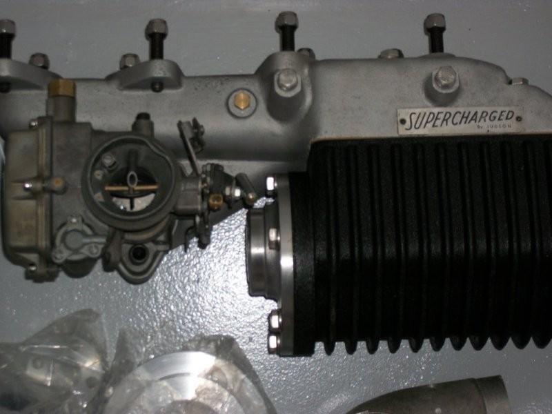

If you look at all the various vehicles that the judson system was marketed for, you can see that these were not an upgrade that enhanced engine performance to any great extent. For the most part, these vehicle/engine combos were very utilitarian , in many cases, the actual vehicles were extremely under-powered, these were the very first econoboxs way before that term ever existed. And even the "sports car" variations of that era used the same engines as the utility sedans, maybe with an increase in compression ratio, a slightly "hotter" camshaft, and multiple carburetion.
Keep in mind...europe was still emerging from wwii after 10>12 years, the motor vehicle industry was just beginning to come to life and exports of these vehicles to the u.s. Were still in infancy. A freakin' citroen 2cv was dangerous to take out of the neighborhood! A renault dauphine was somebody's cruel joke, same for the first beetles (30hp)! But then along came the 948cc austin motor that grew into the other variations for mg, et al, then the german Ford stuff, then the cooperized mini...and suddenly an entire hot rod/muscle car era dawned...euro-style!
Judson's "competiton" in the u.s. Marketplace was provided by mcculloch superchargers. The stuff they did oem for Ford, studebaker (even the chev corvair) was pure performance-oriented, had nothing to do with enhancing drivability. But the development of the "affordable" small turbochargers for the so-called domestic "compact" market (olds f85, IH Scout 80, corvair spider, etc.) killed the supercharger market since they were less costly to produce and did not have to have an elaborate drive mechanism such as Ford used. Mcculloch later evolved into the paxton system of centrifugal blowers.
the history of paxton automotive | paxton superchargers
A "gmc" blower is based upon the so-called "rootes" design. The judson is a rotary vane design, much like modern, high rpm air conditioning compressors used in the mobile hvac industry.
I f you go to the beginning of this thread and look closely at the pic in post #2, you will see the oil bath air cleaner adapter mounted on that example of a 1904. That one has an IH-pattern throttle lever/choke actuator, not the Ford-type.
