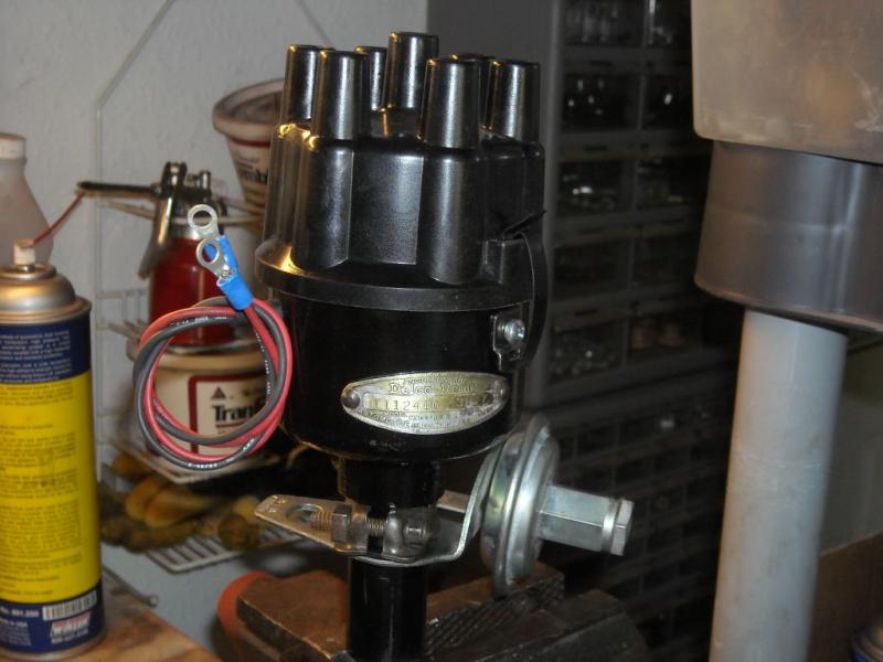

We don't have any exchange distributors ready to go right now for the IH six cylinder apps. So we'd have to rebuild your unit which is perfectly doable! If the vacuum advance canister is perforated, we can have that rebuilt by our source and it will come back looking as new.
The distributors themselves are extremely rugged and normally require only a good internal cleaning and light lubrication after verifying mechanical advance actuation. Those units don't have the same issues regarding wear that we discuss regarding the distributors for the four cylinder and the sv engines you see posted so often.
If you start a new thread for the ignition service, be sure to identify which distributor you have based upon the delco part number so we make sure we provide correct information.
Here's a pic of a similar distributor I did about a year ago. That vacuum advance was remanufactured for us and I installed a pertronix electronic trigger conversion.
