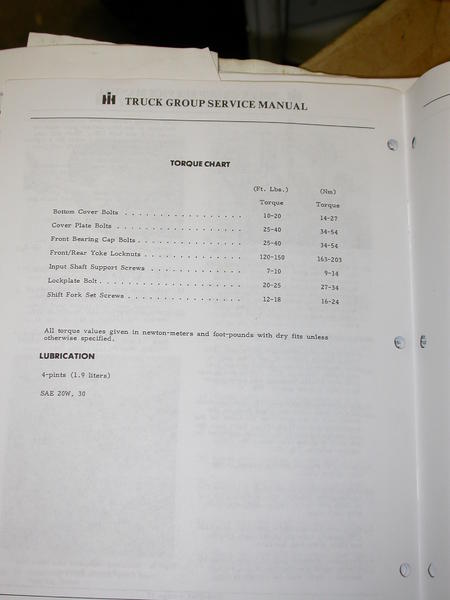

That's not really grease, it's redline assembly lube made for engines, had some laying around so decided to use it. Also just to add fuel to the what lube to use in the d300 transfer case fire, attached the specs from the 1980 Scout Dana 300 manual sae20-30. Sounds like engine oil to me.

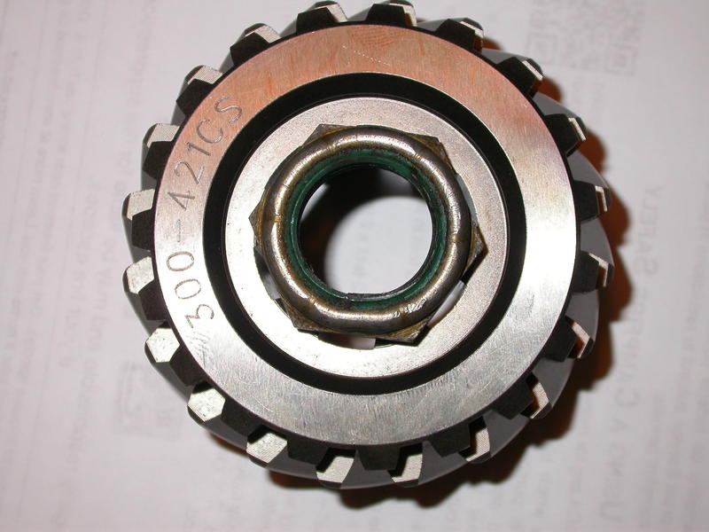

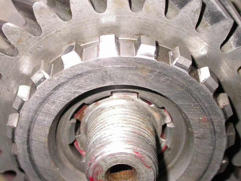

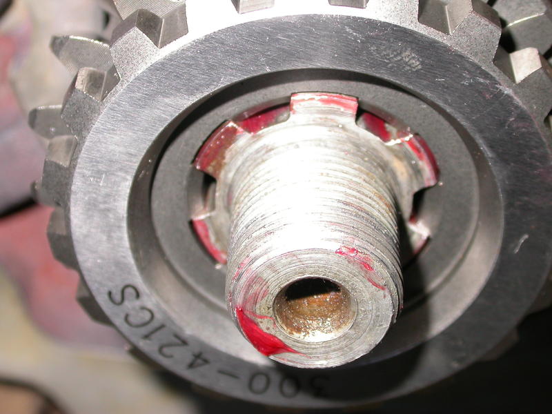

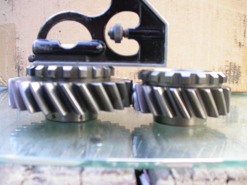

Have question about the t19 bull gear supplied with Dana 300 tera low kit. The splined hub on terra low bull gear is .070" shorter than the stock Dana 300 splined gear hub. When installed on the t19 output shaft, the stock gear hub extends past the splines on the output shaft, so when the retaining nut and washer are tightened onto the output shaft, the gear is compressed onto the shaft. The tera low bull gear hub is shorter, so it looks like the retaining washer and nut will hit the splines on the t19 output shaft before the gear is compressed. Has anyone dealt with this, or have any input/advice?
Haven't noticed that before unless it is purposely done to move the gear inline with the rest of the teralo gears. Regardless the way it is will affect the way the rear output is engaged. I would say a phone call to the manufacturer would clear things up. Possibly all that is needed will be a spacer behind the teralo bull gear to get things lined up.
It's been awhile since I have seen it, but I have actually seen a semi thick washer get placed between the bull gear and nut that holds it in place onto the output shaft of trans. The id was just large enough to slide over and clear the splines of output shaft, and just thick enough to clear them.
As Jeff mentioned, call up the manufacturer and see what they say.

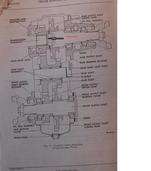

I like scooter's idea, but think that washer would be pretty hard to find, and the tips of the retaining nut would barely touch the id of the washer. Mine has a thick washer, but the hole fits the threaded end of the shaft. Am going with Jeff's idea. Ordered some .020"' thick 1.375" id hardened shaft spacers from mcmaster. Will install one between the back of the bull gear and the long spacer that the rear seal rides on. This is kind of no mans land between the tranny and the transfer case, but the IH d20 and d300 service manuals have cross sections that show the bull gears being a little longer than the splined section of the t19 output shafts, leaving a small gap as seen in my previous post. Think this is pretty important because both the stock d300 bull gear, and the new tl d300 bull gears actually rock a tad on the t19 splined shafts when installed without the nut. Think the 200-300 ftlb torque is to make sure everything is well compressed on the t19 output shaft, and ensure no endplay. Also would appreciate it if someone could please educate me on how to upload multiple pictures so they open with the post so you don't have to open separate attachments.
