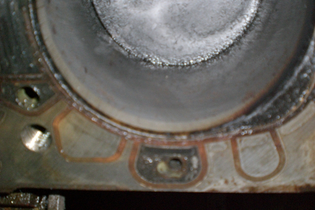

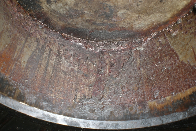

Here’s where it gets interested, when I pulled off the valve covers there was evidence of some corrosion on the rockers and push rods, there was a pretty good build up of white/rust colored gunk on the top of the rocker assembly and push-rods. This could suggest at some point in the motors history that water or coolant had contaminated the oil via a bad head gasket I'm thinking.
I continued to pull off the heads, I inspected the head gasket for any failure or defect which would allow coolant into the cylinder; everything looked normal. When I inspected the tops of the cylinder’s I discovered all the bores where very clean with the exception of the # 7 hole; I’ve attached a picture which shows what looks like some serious damage, more than just bad corrosion. I looked at the # 7 intake valve which had evidence of rust on it. Somehow water must have gotten into the engine and the #7 intake valve happened to be open and water ran into the hole.
The puzzle to me is that I did ran this engine 4 weeks ago before I had it pulled out of my Scout II, so I’m not quite sure how since that time that it has seized up. I did find out that after it was pulled it was steam cleaned; I don’t think any provisions to keep water out of the carb which sounds like eventually made it into # 7. Looking at the damage however looks a lot more serious than just some surface rust, that’s a fairly large gouge in the wall and it appears to me that the piston is wedged in the hole. The cylinder walls are very clean in comparison, virtually no scoring, wear, build-up; I’ve attached a picture for comparison.
One other interesting thing, I noticed on the flex plate that material has been removed via drill as if it has been balanced. When I took the heads off it appears that the deck has been taken down to zero. The bad thing is that doing a quick measurement on bore size, it appears to be close to 3-15/16 which would suggest it’s been bored .06 over if I have the original bore size strait of 3.875. So at this point, I don’t know what my options are. What do your guys read of it?

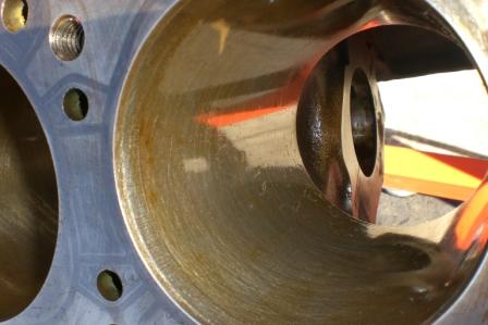

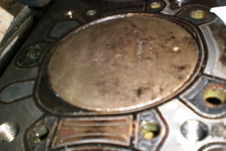

Ari, sorry for the bad news. Not what you wanted to find.:sad:
as you said all of the corrosion and white residue you found says water has been in the oil.
By the looks of the deck surface the engine had steel shim type head gaskets on it. They can be troublesome if not correctly installed. They can weep coolant but not show obvious signs of the leak. I would have the head for #7 checked real close for cracking also.
Is the piston really at 0 and truly flush with the deck? If so that is setup incorrectly for shim head gaskets. The gaskets are only .020 thick after torquing and would leave your quench distance (piston to head deck surface when piston is at tdc) at .020, it should be at .040-.050 so the piston does not hit the head. For the shim type gaskets the piston would need to be set .020-.030 in the hole.
The bore at .060 over is ok as it was normal to bore sv engines to .080 at the IH rebuild shops. I doubt the bore on the bad cylinder is going to clean up with out going up another size. May even need to go up .020 more.
no, not exactly what I wanted to find but I think there is a glimmer of hope in what you say. I was a worried that I wouldn’t be able to find off-the-shelf pistons for .080 over, and I agree, I don’t think it will clean up without going bigger, so as long as this is the case, I’m not completely heart broken.
The gasket did measure in at .0225 at tdc according to the marking on the wall of the cylinder has about the same thickness as the gasket, if we say that the total quench distance at tdc is .045 (would need to be accurately measured), I’ve heard that the chamber cc’s is 68cc, a bore of .08 over @ 3.955, stroke of 3.218, piston volume of zero, I come up with a total of 9.4:1 and 317 cu in, again, everything needs to be measured up accuratly.
If a po owner has gone though this much trouble of machine work and pistons, surely they swapped out the cam, I’ll be looking at this today. My brother bought the Scout 2 years ago, I always felt that the engine was very strong and had a ton of power. Riders would always be impressed; they would always ask if the IH motor had swapped the motor out for a sbc. I guess the downside, as obvious is that the motor has probably taken some abuse. It will be that much more important to have all components properly inspected.
If just that one cyl is bad you can have it sleeved then bored out to match the rest of the cylinders. The 392 thats in my pickup has 5 sleeves.
Ari,
after looking at the bad cylinder image again, I would pull the bad piston. Buy a bottle brush type of hone 220 grit +/- and see what you get after a quick licking with wd40 being sprayed as you hone. The rest of the cylinders really look good and if you can get the rust out sooner than latter it May be shallow enough to leave only fine localized pits that will not hurt engine life. Leaving the rust will make it worse.
Removing the stuck piston: soak with a penetrating oil of some sort for a few days. Remove the bad cylinder rod cap and rotate the journal away from the rod. Then using a wood block drive it down first, enough to clear the rust from the upper portion of the cyl, and tap out through the top. The piston is most likely fine needing only a good cleaning.
Ps be sure to keep the honing run-off from contaminating the rest of the engine.

I was finally able to get back at it on Saturday morning. I ended up tearing the entire motor apart since there were seized pistons on either side of the block; I couldn’t pull the cap and rotate the crank away from the rod in the stuck cylinder.
No. 6, 5, & 7 were completely stuck in the holes and it took some hard persuasion to get them out. I pre-soaked everything for a week in penetrating oil. On # 7, the worst of them all, I had to remove the crank and work the piston in and out of the hole applying penetration oil to try and get the walls lubed up. I ended up having to place the piston in the bottom of the hole and throwing a hone in the hole to knock off the build-up of rust. A couple more back and forth movements and more oil and it finally came out.
Bore came up standard at 3.875, contrary to my original thought it had been bored .06; mains and rods were standard. I’m a little nervous about re-using the pistons giving the effort that it took to get them lose and given the rust issue, I think it’s probably best to have it bored given the conditions of the bores.
At some point the entire assembly was balance past what I believe came from the factory. There’s material that has been removed from the fly-wheel as well as the counter-weights and new pistons would mean re-balancing.
I’d like to know what you guys think of it.

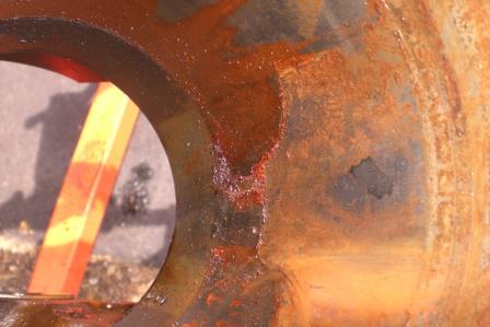

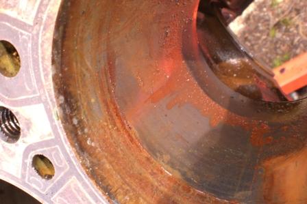

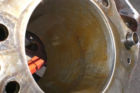

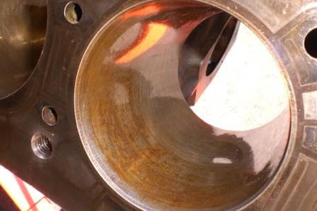

#5 Before Hone.jpg N0. 5 before hone
# 5 After Hone.jpg No. 5 after hone
#7 Before Hone.jpg No. 7 before hone
#7 After Hone.jpg No. 7 after hone
Typical wall after hone

if it were my engine and it was in the condition yours is in, with the corrosion in more than one hole. I would bore (probably .020) it and not fool around with questionable parts. Just not worth the time to do it again in a few years.
As always cam, rod and, main bearings. Have the rods checked for big end bore roundness, twist and squareness. Pop out all freeze and gallery plugs before taking it to the machine shop so everything gets clean. Then reclean the oil gallery's with solvent and compressed air before re-assembly.
If you have any question regarding the cam, replace it and the lifters..
Just my mo, not everybody's.
Those cylinder surfaces are deeply etched. Those will never do.
Bore it and hone the cylinders to finish diameter and be done with it.
There has been water (coolant) in the engine, all finely finished bearing surfaces must be carefully inspected for etching. No doubt the cam bearing babbit surface will be etched too.
