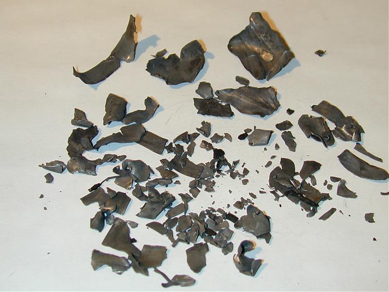

And here's worst case...cam bearing material that has taken a hike. And this is just one of the five cam bearings, this is the one that feeds oil to the passenger side rocker assembly.
In my experience, it's nearly always the passenger side (number 4 cam bearing feed) that is affected for some reason, I ain't figgrd that out yet! It goes into failure mode first...but if it's goin' south, ya can bet the driver side is in failure also, it just ain't got there yet!

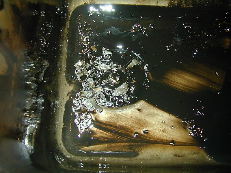

And here's shot of the cam bearing debris after fishin' it out of the pan, these are the big chunks, not the little stuff that was not easily picked out.
This is only one of several cam bearing failure modes which might be experienced.
Another common scenario is that the babbitt layer simply peels off the base material and looks like a wadded up chewing gum wrapper laying in the pan.
Worst case is that one or more cam bearings actually seize to the journals and then "spin" in their respective bores. In that case, the bore(s) in the block are now badly distorted.

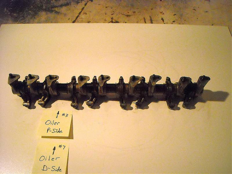

Continuing on...here ya see the entire rocker assembly removed from the cylinder head.
The intake rockers are different parts from the exhaust rockers, they do not interchange with each other. In this particular assembly all the rocker stands are the same part number/design...but that is not always the case. There were at least three different rocker stands produced, each slightly different from the others. The important thing is...that the stand which passes lube oil from the cam bearing, must have the "oil hole" present, and that hole must not be blocked with sludge/carbon.
And the rocker assembly must be assembled in the correct order shown, otherwise it cannot actuate the valves correctly and severe damage will result.
By the way...these are the rockers referred to as the "welded" or "cast" rockers. They dam sure ain't a "cast" part, and they are formed from a complex sheet metal stamping that is folded and then spotwelded, the pushrod ball and the valve actuator pad are then pressed into the piece, then a bronze-lined steel bushing is pressed in. These rockers were supplied to IH by federal mogul.
Both the ball and the valve tip are hard faced for wear resistance, but must constantly receive lubrication when the engine is running.

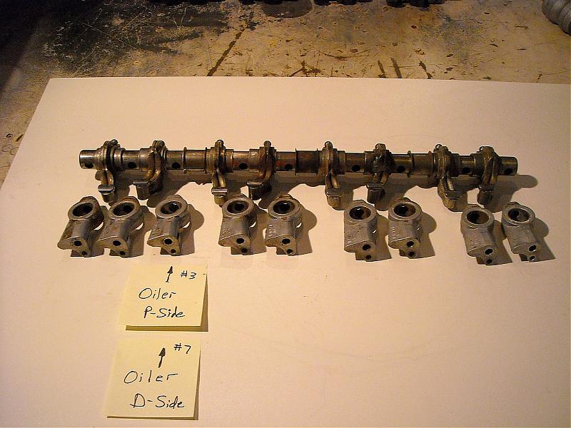

Here we have the individual rocker stands removed from the assembly in order.
Notice the "l" shape to the bottom pad which seats against the head surfaces. In some cases, you will find some of the stands do not have that pronounced "l" shape, but are rather triangular. Those stands will never contain an oil hole that has been machined in.
Those "blank" stands May be used in any position on the assembly except...the "oiler" position...and the third position from the front of the rocker shaft. The "head" of a head bolt in that position will prevent the stand from seating against the head inna proper fashion. So a "cutaway" rocker stand must be used there also. And that is the third type stand sometimes found, it's made just like the oiler stand, but has no lube hole!
Bottom line...ya must pay attention to the correct assembly sequence here, especially if mixing and matching used parts!

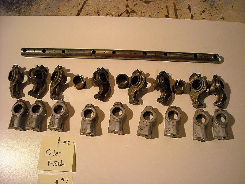

Here's the entire rocker arm assembly taken down to component level.
Every component shown here is available today in either a new part, or remanufactured piece. Same for the corresponding push rods.
This single rocker assembly is used for all I-4 (both 152 and 196) engines, along with both sides of the 266, 304, 345, and 392 apps. The oiler stand must be in the the third stand position from the rear of the engine.
When the rocker assembly shown here is flipped end-for-end, it becomes the driver side assembly for any sv engine app. The driver side oils in the third rocker stand from the front of the engine.
And yes...there is only one cylinder head assembly used for each sv engine displacement, they interchange side-to-side, there is no "left" or "right" head.
Confused??

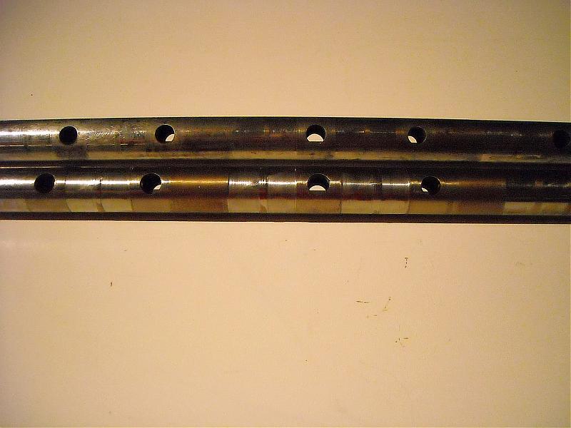

We're almost to tha point whee we can start fixin' stuff, but let's look at one other "diagnostic detail"....

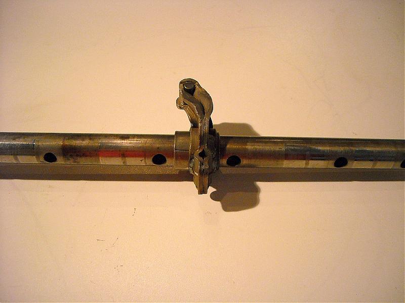

This pic shows the top of either rocker shaft. Notice the smaller holes as compared to the larger holes.
The small holes at each rocker pivot point must be oriented in the up position when the assembly is installed to the head.
Once the rocker shaft is completely filled with lube oil from the cam bearing/journal feed, it begins to stream from each of the eight spit holes and into the rocker shaft bushing.
See the small "notch" at the end of the rocker shaft? That is the indicator that the shaft is correctly oriented when re-assembled. That notch is present at both ends of the shaft. Always verify correct assembly before installing the rocker assembly, which is...notch up!
If the rocker shaft is installed upside down, then oil simply drains away and an insufficient quantity will emerges from the bushing area to drool onto the pushrod cup end, and also down onto the valve tip interface. The oil is channeled through that groove formed when the rocker stamping is folded together and then spot welded.
And both ends of the rocker where the hard face tips are inserted must be clean and sludge free. Ya gotta see daylight if ya look at the tips! That is the only way oil can reach the hard tips!!!! Very simple piece of engineering!

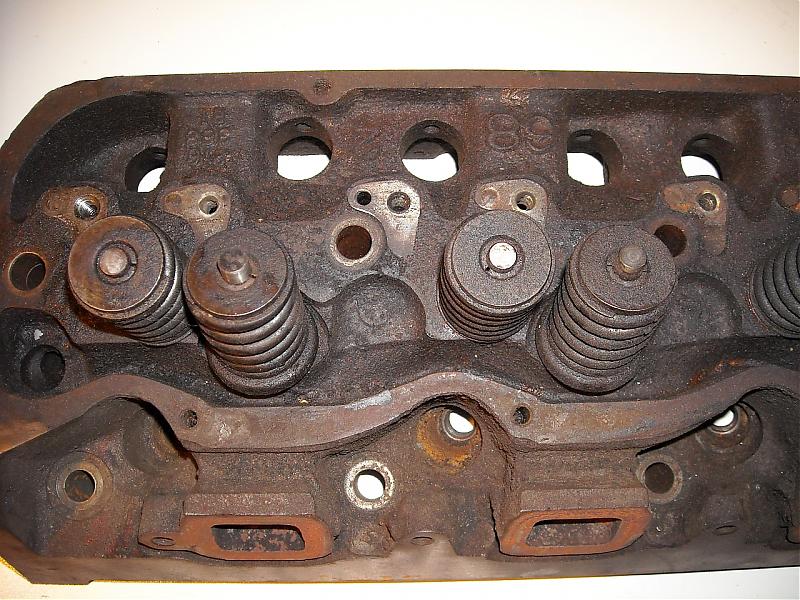

Now let's take a quick look at a typical I-4/sv cylinder head.
We already know that oil is delivered from the cam bearing/journal inna "timed" fashion to that small port and travels through the oiler stand to reach the rocker shaft assembly.
This pic shows that hole. It must be free of sludge. And the oiler stand must fit tightly against the head at the machined boss. Other wise oil will be released from that interface and never reach the critical component which is the rocker shaft assembly.
Fairly often I find motors that have had some kinda "sealant" applied at that point! That is a definite no-no and a sure sign that someone has been into the motor who did not know what tha hail was goin' on! Any amount of "sealant" applied there is certainly going to squeeze out and block that very small orifice! It does not need any help to seal if the rockers stands have not been previously botchinated!

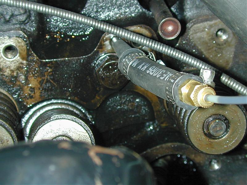

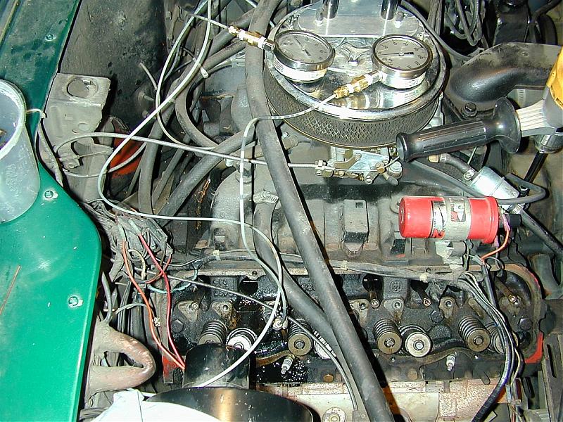

Once the rocker assembly has been removed from that motor, we can apply the "pre-oil" procedure described in that document I posted.
This pic shows an oil pump drive tool (ihon has those in stock) and the drill motor attached which I use. Ya gotta spin that oil pump with at least 1200rpm to make it squirt, and...the camshaft position in regards to the bearing spithole must be in proper alignment. Again...review that document so ya fully understand how critical that alignment is.
Here ya see one pressure gauge connected to the main gallery where the oem oil pressure ending unit is connected. That allows oil pressure at that point to be read when the drill motor is spinnin'.
The second pressure gauge is connected to an "adapter" I fabbed to allow oil pressure/flow to be measured at the critical feed point in the cylinder head simutaneously.

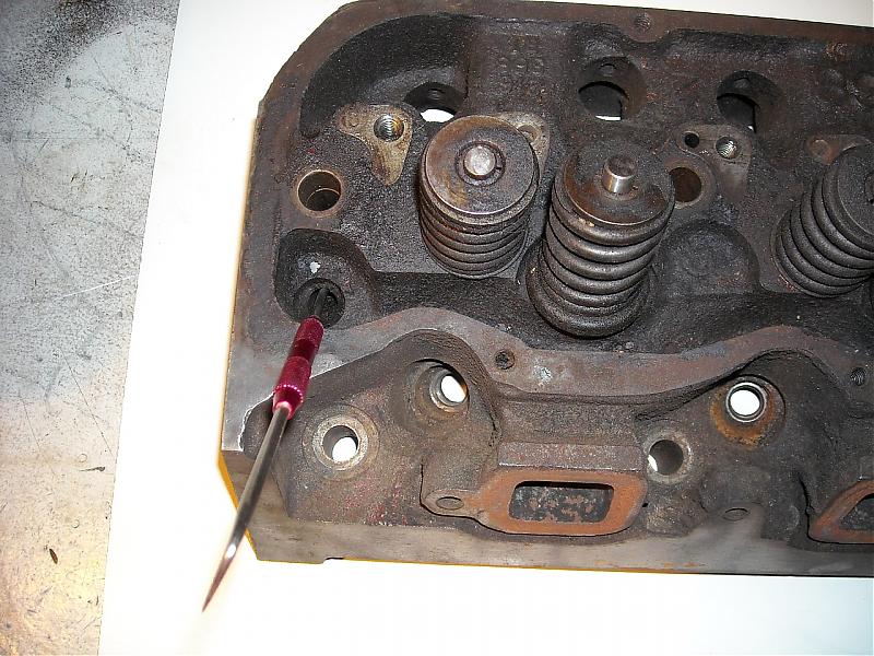

Ok...before we start in with repair, let's see how all that oil in the valve covers that accumulates gets back down into the sump for recycling!
Each head casting has a "drainback" hole at each end. That way, the head can be used on either side of an sv application.
And that hole mates with a similar passage in the block casting, and is sealed by a penetration in the head gasket.
The diameter of that return passage is calculated to allow a controlled return (by gravity) of oil pumped through the rocker assembly, to the oil pan sump.
If that hole becomes restricted because of sludge/carbon, accumulated valve cover gasket debris, rtv/gasket sealers, etc., then oil will not drain out of the rocker chamber under the valve covers! The result?? Much "windage" in that area, aeration of the oil, inability of the upper end of the engine to breathe through the pcv system, valve cover/bolt oil leakage, etc. And in the case of the Scout II oil pan system, a "shortage" of oil being returned to the sump for pickup by the oil pump at higher engine rpm.

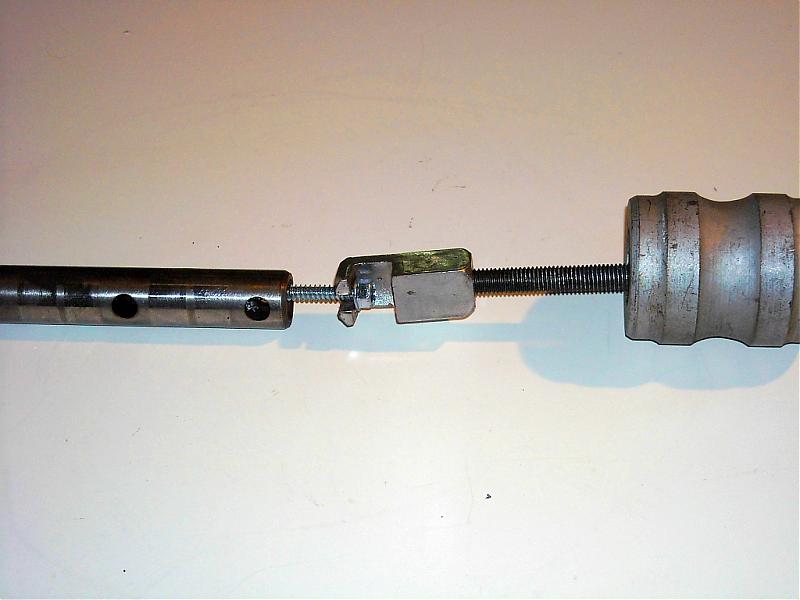

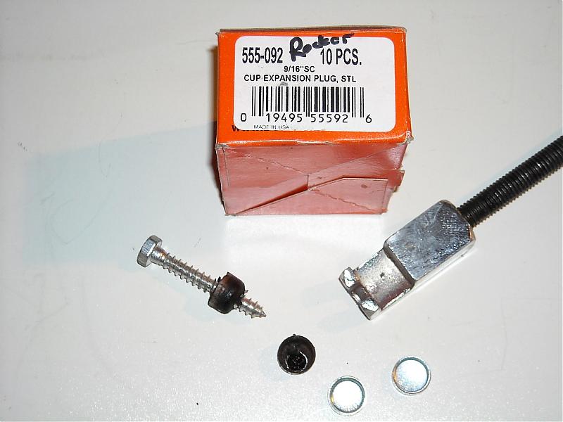

Now let's clean out the rocker shaft...one more reason why tha bitch May not be oilin'!
In each end of the shaft, there is a small cup plug inserted. These plugs keep the rocker shaft full of oil whenever the engine is running, that in turn supplies oil to the rocker bushings, push rod tips, valve tips.
But in these old poorly maintained crapball motors, those rocker shafts are gonna be badly plugged up with sludge and carbon accumulation from overheated oil. If those eight small holes can't allow oil flow, then the rocker will actually momentarily seize to the shaft. Or...a valve will seize in it's guide (most common) and hang partially open.
The stuck valve then allows the push rod to jump out of it's proper position, or sometimes the push rod is whacked by the rocker and simply breaks into a couplea pieces and falls down into the lifter chamber. When that happens, the affected cylinder goes dead. Many valve jobs and head gasket jobs have been done for this simple root cause! And doin' a head gasket replacement will do nothing to correct a plugged rocker assembly!
This shot shows a sheetmetal screw having been driven into the cup. Then a small slide hammer witha "puller" has been rigged on the head of the screw and then the cup plug is extracted. Do the same on the other end!
Once both plugs are removed, then the interior of the shaft can be inspected witha light. You will be shocked at what ya see in there!
I clean these shafts either by using solvent and an engine oil gallery brush set, or a 20 gauge shotgun cleaning kit, including the bronze bore brush followed by the swap. Also individually clean each oil spit hole. This shaft must be sterile before installing the new plugs.
Here's a shot of the grungee cup plugs extracted.
The replacement dorman cup plug is also shown, it's a 9/16" callout and should not be substituted for some dam metric "equivalent" plug!!!
The plugs are the "shallow" design and not exactly the same as the oem. That does not matter, what does matter is the nominal diameter. These plugs are designed to be a fairly "tight" interference fit inside the shaft hole, use no sealer when installing these plugs!
Using a suitable drift, knock the fresh plug into position. It should be driven in so that trailing edge of the cup is just past that first rocker stand hole...no deeper. If ya don't drive it deep enough, then the hold down bolt won't go through the hole.
Repeat this process for the other end.
That tool I use is perfect for seating these plugs, it'sa push rod from a '62 corvair flat sixbanger!

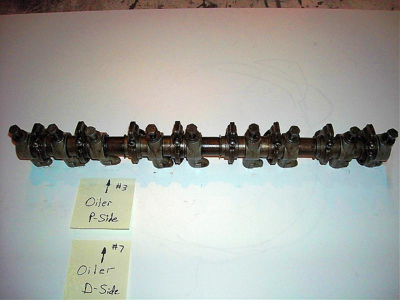

Now let's reassemble the rocker shaft.

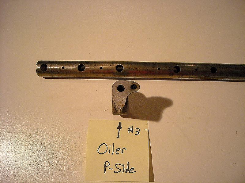

Here we see the correct orientation of the rocker stands for the nine stand assembly. The set of stands I've selected here is a mix of the three different part numbers, so you can see that the foot of each stand which mates with the head has a slightly different shape. There are two points here that are critical...
1) the third position from the left hand end must have the "oiler" stand installed in correct orientation!
2) the third position from the right hand end must have a stand installed that has the "cutaway" foot, so that it will not interfere with the cylinder head bolt head.
The type of stand installed in the other seven positions is not critical as long as they are clean!
Here I've turned the critical stands upside down so ya can see the shape of the foot.. Notice that the oil hole on #3 from the left has been cleaned out.
The spacers are also seen in their approximate position. And the oil spit hole for each rocker bushing May be seen in it' proper orientation which is up.
One last point to verify so we don't have to tear this apart and redo it later.
The shaft itself must be oriented with the end that has the two stand holes closest together to the left. This shaft is not symmetrical and May not be swapped end for end, nor can it be turned upside down!
Ya gotta clean and inspect each rocker arm for the following:
...condition of the ball end which engages the push rod socket.
...condition of the pad end which engages the valve tip.
...cleanliness of the lube holes at both the inserted rocker tips.
...condition/size of the bronze rocker bushing insert.
Those tiny spit holes at each tip of the rocker must be sterile! Very important. If they cannot drip oil onto the push rod socket or the valve tip, extreme, rapid wear will occur at those points. As the wear increases, the lifter can no longer compensate for varying valve assembly geometry and lifter noise will begin and continue, it will not go away due to this wear!
Once the engine is running, you must observe oil drool from all of those rocker tip interfaces, it it does not drool, then ya gotta correct that!
