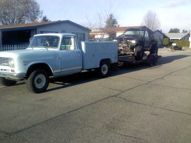

This is a picture of the tow rig and the wheeler by the way!

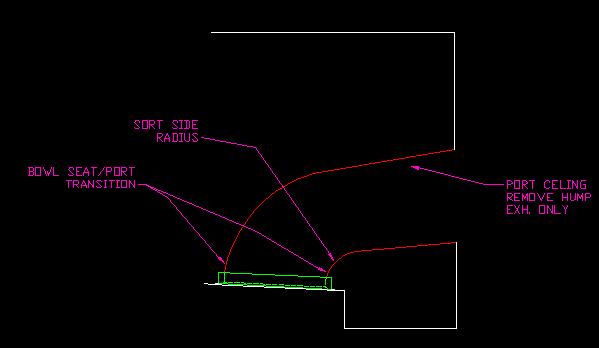

Porting the exhaust will help as will some deshrouding of the valves in the combustion chambers. Let me post a picture to show you what I mean

Mark you sound like you are experienced enough to accomplish the porting but heads can also be ruined just as easily. Other then blending you won't gain much at your expected rpm range
the exhaust port ceiling where the air tube goes should be smoothed. Eg remove the hump so the roof is flat and contoured.
The valve bowls should be smoothed and blended seat to port.
The intake short side radius needs special attention. The bowl to port should be free of corners and as large a radius as reasonably possible. Posting a basic port drawing to show what I mean.
As an exercise you could cc the cc's. :gringrin:
could be used to dial you in on cr.
Depending on the operational altitude a compression ratio bump will help. I don't recommend head milling but do recommend "0" decking to accomplish the desired cr. You'll be very near 8.6 with a composition gasket and 0 deck. Steel hg, leave the piston in the hole .020 at tdc.

Thanks Robert! I had a port and polish thread on bp and the info there was basiclly the same. Port and polish is a waste of time. No real noticable gains in hp or tourque on these engines. This engine and it's purpose will probably never see 4000 rpm and has no purpose over that. I am using 4000 rpm as an extreme example as well.
But will take your recomendations into account and May do that mild work as we have the engine apart and it's a learning opertunity to my son. I have done about 10 sets of heads in my life. None IH and all with positive results because of my learning opertunities from others at a younger age.

Probably only thing I May do and I don't know if it were mentioned here or on a port and polish question I had going on bp because I knew it would draw out Tom mandara. May remove hump from exhaust port if there is one. No body was sure if it was there in 72?

Port hump? Thought you had the heads off? If you have air tubes then you have the hump. Either way the exhaust port is the big restriction on your heads.
