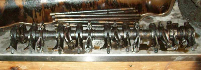

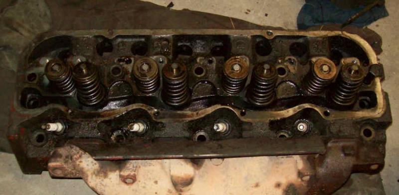

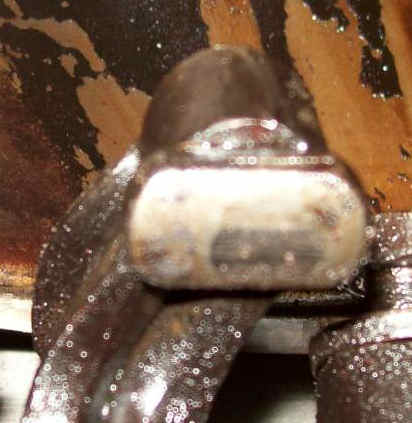

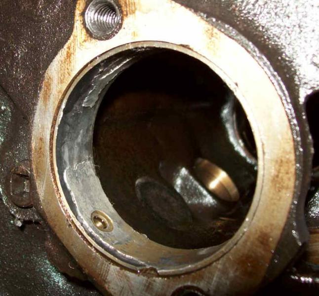

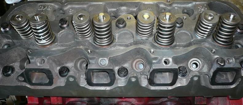

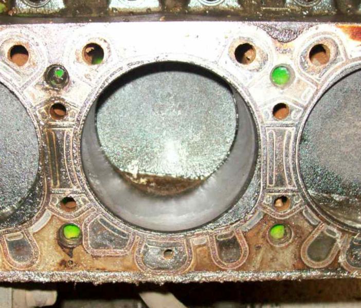

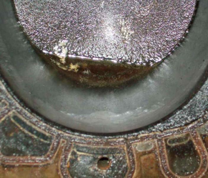

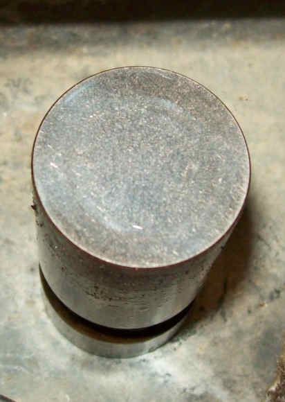

Good pictures Mark,
1) need to measure the bore to know for sure but in general if after cleaning the carbon at the top of the bore you can feel the lip even if barely it probably has more then the allowed wear/taper.
2 the bad cam bearings are hard on the rocker assembly. Both sides need a complete tear down and cleaning.
3) lifters and cam are toast by the lack of a outer ring with no wear. Must have dishing and that would indicate lobes are done.
4 good thing on those e heads is I see exhaust seat inserts. They will handle unleaded fine.
You're off to a good start for sure. :thumbsup:
Appreciate the feedback Robert! I knew I was going to get it, yours seems promising and that's what I see here is a good motor to rebuild.
Block is coming out in the next couple days so I will have more information.
Hearing the heads are a good choice and I already have them is encouraging!

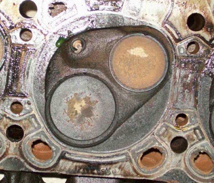

Will tear down rockers, thoughrough inspection, then pictures for advice here. But I see no bad wear. I see barly wear. Tops of valves look like no wear!
Cam and lifter were going to be replaced with a performance cam anyway. Yes they are dished, but no critacal damage. So the performance cam recomended ealier in thread from IH only? Comes with lifters or I have to order them with it! But what about valve springs? Use the IH springs? Other?

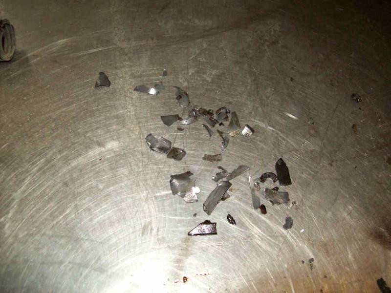

Ok the suspense is killing me as my son dismantles the engine.

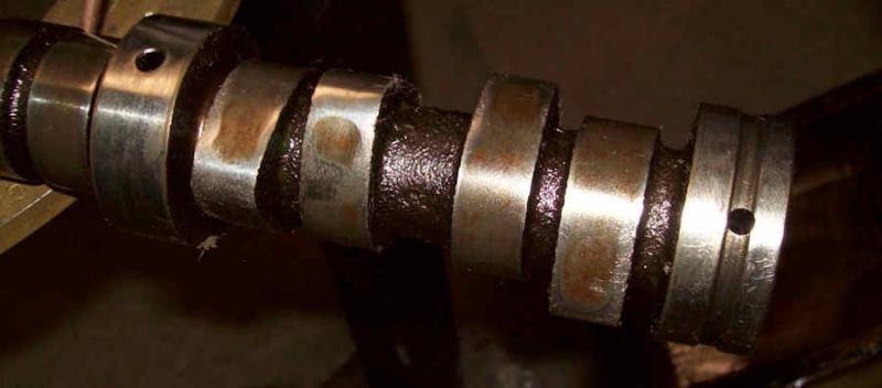

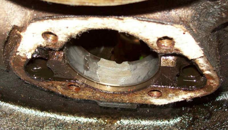

Cam is out and doesn't look to bad but definatly has wear. Front cam bearing has failed and is missing the top layer on about half! Taking off the rear cam retainer plate now to see how bad the rear is...
pictures!!! :gringrin:
I feel like I have been spanked... :icon_eh:
front cam bearing.
attachment.php
Rear cam bearing.
attachment.php
Cam.
attachment.php
Hope you know it is all in fun. Nothing to serious here..
Wow it sure did shit them didn't it? I would say by the look of those bearings, they are factory originals. Shells will be stamped IH. Same on the rods and mains.

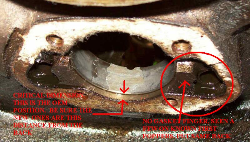

Had to use your nice photo to make a few points for reference.
So the rods are stamped with numbers? Mine are and I thought that was a sign of a past rebuild?
I've seen them on first time poppers many times. I have never opened up an IH that was not marked. Doesn't mean they were never built unmarked but I have yet to run into one.
Well like I said they were all marked 1 through 8. Rod bearings and main bearings all have an IH emblem on back side and marked std. No signs of crank damage. No signs of rod damage. No signs of block damage. No signs of valve damage. No signs of rocker damage but I have not taken them apart yet. Pistons show a little skirt wear but from my experiance machinist usually say they look good the way they are but have to mic the cylinder bore to determine if indeed it needs a bore.
So overall we have all good parts to rebuild. Actually if it weren't for cam bearing failure and resulting oil pressure loss this motor would probably have gone another 100 to 200k miles.
Now comes the nickel and dime damage... :winky:
edit: went back and saw your notes on my rear cam bearing! Thanks! What your saying about the gasket not being there is critacal? Sign of origanal engine or good IH rebuilder? From everything on here it looks like an origanal.

Porting the exhaust will help as will some deshrouding of the valves in the combustion chambers. Let me post a picture to show you what I mean

Been really busy lately so have not got around to the picture I promised. But after more thought regarding your build and application here is what I suggest.
Mark you sound like you are experienced enough to accomplish the porting but heads can also be ruined just as easily. Other then blending you won't gain much at your expected rpm range
the exhaust port ceiling where the air tube goes should be smoothed. Eg remove the hump so the roof is flat and contoured.
The valve bowls should be smoothed and blended seat to port.
The intake short side radius needs special attention. The bowl to port should be free of corners and as large a radius as reasonably possible. Posting a basic port drawing to show what I mean.
