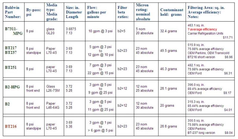

Another possible point of confusion I had to clear up before recommending this filter was its only listed application, carrier refrigeration units. This could have meant it’s intended to filter the refrigeration compressor’s oil on the refrigeration units of large high-rise office buildings, which would render it useless for our vehicles. But baldwin assured me in an email that was not the case, but rather it’s the filter for the engines that drive these refrigeration compressors, especially in semi-trucks. And they assured me it’s used in other truck engines too. It just happens to initially be designed for the engines that drive the carrier refrigeration units.
This is the only baldwin filter with no average efficiency rating because despite its very fine particle filtration, it’s off the scale with its flow-ability rating at normal operating pressures.
oem notes:
anytime you see the word oem in the attached tables, it means baldwin is the original equipment manufacturer for that filter . wix won’t tell you that kind of info, but I suspect wix at one time was the oem for IH with its 51452 filter . no proof, just a hunch .
synthetic filter notes:
Here is a quote about synthetic media, but don’t recall where I got it from: “an engineered synthetic media is course on the outside and progressively finer toward the inside effectively increasing its filter area by "filtering in depth". All filter media to some extent filters in depth but the synthetic media can be so much more uniform in thickness and spacing that not only are comparisons between cellulose and synthetic area based on visual inspection or area meaningless, but visual comparisons between different synthetic media also can not be done”.
I would change that slightly to read “meaningful visual comparisons can not be done without a microscope”. That’s why engineering data like baldwin provides and wix won’t is so important when choosing to upgrade your engine’s filtration system/filter.
by-pass valve notes:
our engines definitely need a filter with a by-pass valve (which should be 8 psi) . this allows oil to flow through to the engine when the filter becomes too plugged-up with debris to allow the oil to flow through its filtering medium . and the by-pass valve allows the oil to flow through to the engine when the oil is too thick or cold to flow through the filtering media, which frequently happens when the engine is first started on a cold morning with a paper filter . unfortunately every time the valve opens to allow the oil to flow through, that oil is unfiltered, dirty oil .
there are two schools of thought regarding the best location for the by-pass valve . one is that the best place is at the top of the filter so the unfiltered oil does not wash across the dirty side of the filter first, collecting more contaminants before entering the engine .
the other, held by baldwin, is that actual testing has determined it really doesn’t matter where the valve is located . the contaminants are lodged in the filter medium, and either way the valve is below the threads, and the swirling, pulsating oil will still pull any loose contaminant not embedded in the filter’s medium and pump it through your engine in addition to the other unfiltered oil when the bypass valve is open . and if your filter is so loaded with contaminants that it’s not all imbedded in the filter medium, but rather sitting loose at the bottom of the filter can, then you should have changed your filter long ago as it’s now in a fully loaded state where the filter is already mostly operating in a state where the by-pass valve is always open .
just another reason why it’s important to replace your filter regularly .
I was going to describe the specifications about each filter and why I ranked it where I did, like I did with the first filter, but I can see now, if I did that, this post would be 20 pages long. So open a second window for the attachments as I refer to them for filter specification details and I’ll keep my remarks to a minimum, only stating my reasons for ranking it where I did. For flow rates I did not list all the test points in the attached tables, only the top and bottom published flow specification for each filter.
bt217
bt237
these are exactly the same filters in every way, per baldwin, except they have different part numbers for marketing/oem purposes .
I ranked this set of filters second because of their good flow rate but especially because of their exceptional ability to hold a lot of “dirt”, almost 50 grams with 515 sq . in . of filter paper . and the only filters with substantially finer filtration than these two filters (other than the b7311-mpg) are the two b2 series of filters, but their flow and filter capacity can’t compete, so that leaves this set of filters as my second choice .
bt251
I ranked this third because it doesn’t have quite as much contaminant holding ability as the previous set of filters. However it does flow better than the above filters because it doesn’t have a standpipe or as much filtering paper stuffed into the can. And if you consider the better flow (less pressure drop) to be more important than the extra contaminant holding ability, I see where you could easily rank it above the bt217/bt237 set of filters. But these filters all flow so well, I don’t know if the pressure difference would be noticeable until they start to reach the limits of their dirt holding capacity. Perhaps someone some day can try both and let us know if there is any noticeable pressure difference between the bt251 and the other filters.
b2-hpg
this comes in at the top of the 5 inch filters because it has good flow, great contaminant filtering ability and the best dirt holding capacity of any 5 inch filter .
b2
With a little better flow (less pressure drop) and about the same or slightly worse filtering ability than the b2-hpg, but because of much less contaminant holding ability, I rank this below the b2-hpg. But here again, if you consider the flow/pressure drop more important, I can see ranking it above the b2-hpg. But at this point I don’t know if the very slight difference in flow characteristics would equate into a noticeably different engine oil pressure reading. I suspect it would not until the filter begins to approach the limit of contaminant holding ability. That’s why when things are nearly equal I will go with the filter that can hold the most contaminants.
bt216
I debated if I should include this filter in the list of the best of the best at the top of the post . it appears to have almost double the flow of the other 5 inch filters above, and the same contaminant holding ability as the best 5 inch filter, the b2-hpg, both very important to the ranking of the filter . but it achieves this by doubling the size of the holes in the filtering medium compared to the other 5 inch filters . and based on my premise that the most important requirement of a filter is to filter, is the reason why I did not put this filter in the list of the best of the best . but study the specifications in the attached tables as you May find you would prefer it to the other filters if you have to run a 5 inch filter . it has the same filtering rating as some of the 7 inch filters .

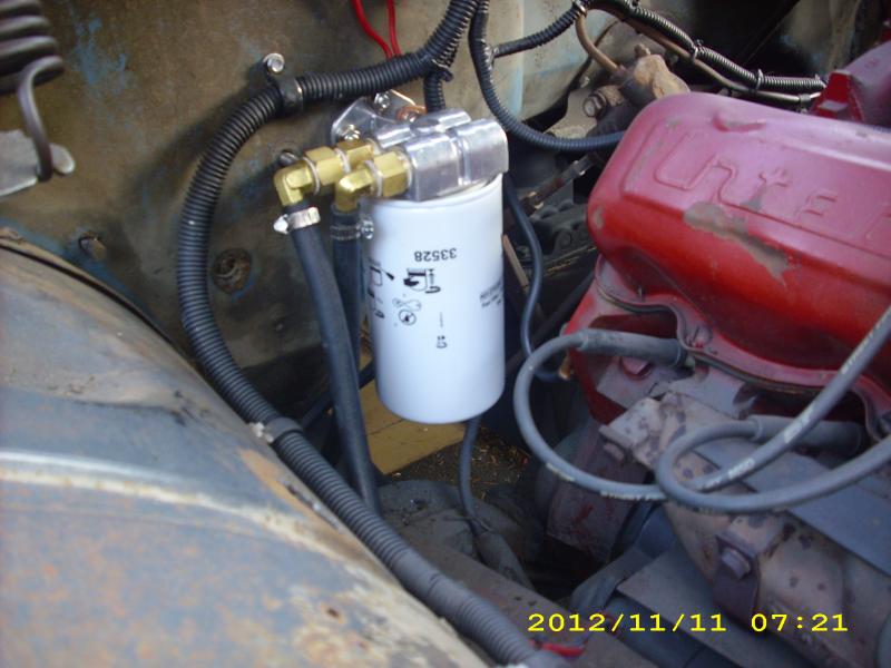

Hi,

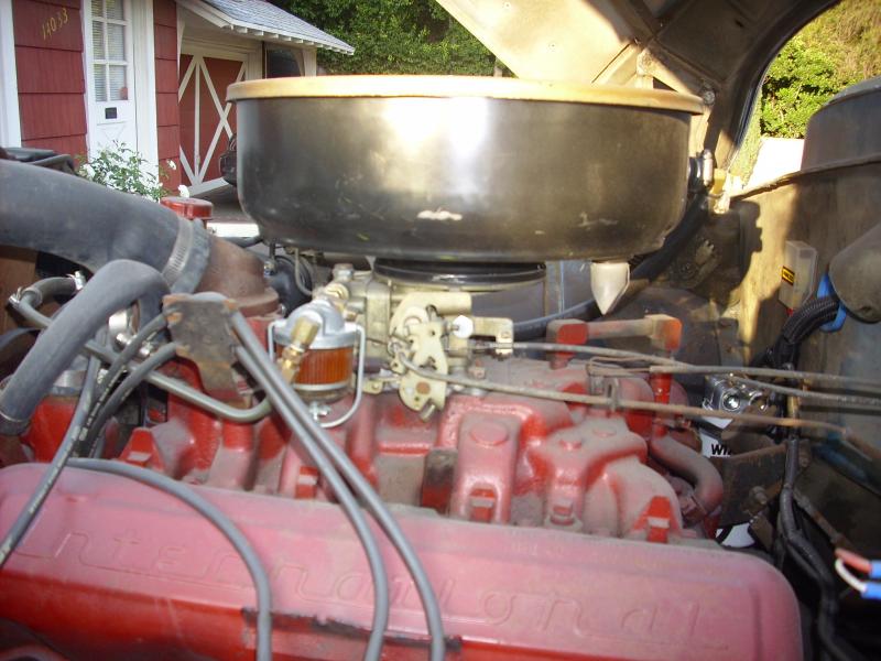

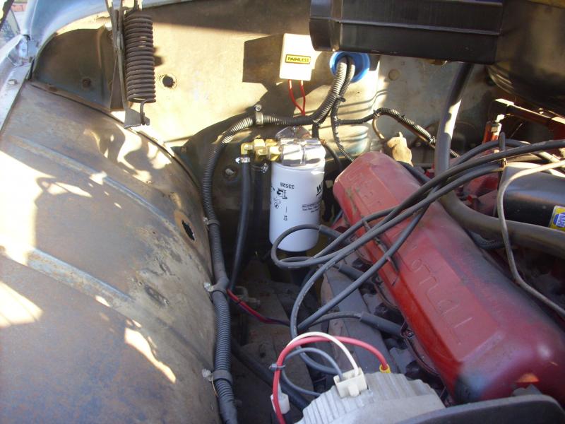

just thought I'd post a couple pictures of the fuel filter I added to my truck. I spoke a little about them on the previous page - how it has between 2 micron nominal and 5 micron absolute filtering, and holds 25 grams of dirt, rust, etc as opposed to the little inline filter people usually use that has a big 140 micron nominal filter rating and unknown absolute filter rating.
I must admit I have not had any more stuck-open carb float needles since installing this filter, and I have never cleaned out my gas tank, and by the looks of it, neither has the previous owner. I run my truck at least once every other week.
The last picture is of a little fuel / water separator filter I added to the carb's inlet. It let's me see if there is any moisture in the fuel, and the general condition / color of the gas.

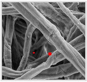

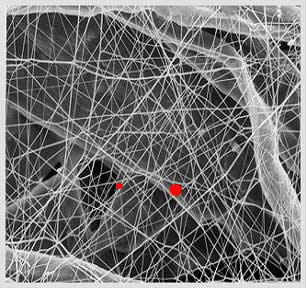

I don't agree with that. Recently, with the use of new nano-technology, the all synthetic filter is very much improved over the previous paper/cellulose filter. Both baldwin and wix each had two synthetic filters applicable to our engines with the baldwin b7311-mpg coming in far superior to any other filter, and the two wix synthetic filters coming in last only because they had no specs or applications listed for them, so their performance is really unknown.
Below is a picture of traditional cellulose filter media and the newer synthetic nano-technology filter media. The red dots represent in size a 2 micron and 5 micron particle. This was taken with a scanning electron microscope magnified 1000 times. Unfortunately these newer synthetic filters cost about double what a traditional filter costs.
First picture is of a cellulose/paper oil filter media, compared to a synthetic oil filter media.

and seeing that I feel safe with my oil lasting maybe 4 or 5k miles as it is not stop 'n go; 2 filter changes is a good way to keep it clean that long . the single biggest factor that owners of very high mileage engines that still work good and don't smoke has been consistent regular oil/filter changes and maintenance .
yes, exactly, I totally agree with all you just said !

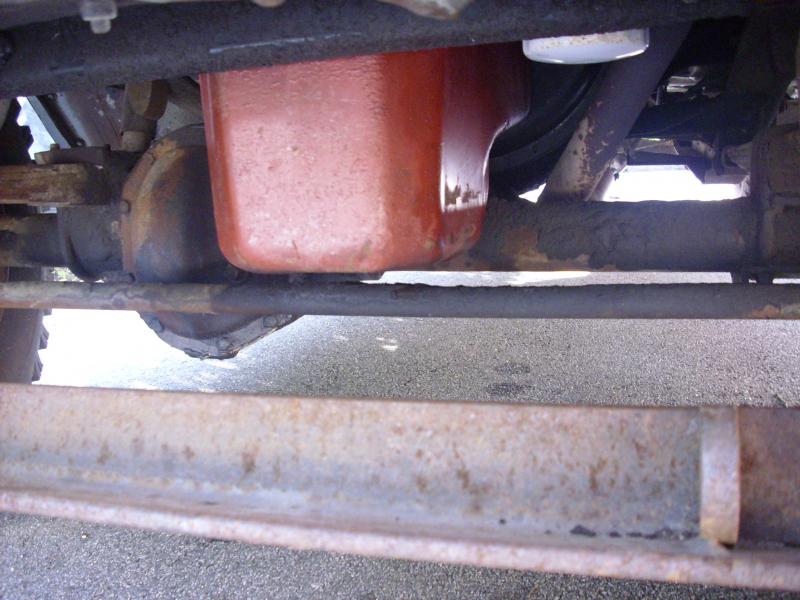

do you have an extra deep or high capacity pan ?
yes, and I wish there was some way to track down the original use or origin of this engine . is there some serial number somewhere on this engine unique only to this engine assembly ? the po told me it came from some old low mileage military vehicle, but who really knows .
here's a picture of my very deep oil pan, with less than two inches clearance to my tie rod

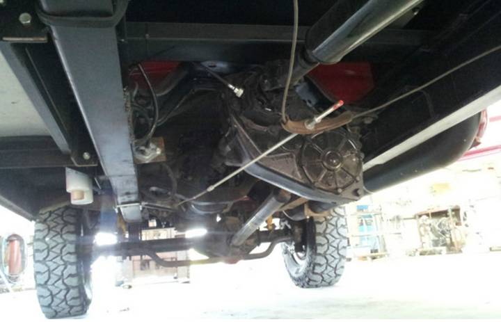

Btw, how deep in inches is your oil pan from flange to bottom? (outside is fine)
ooh yeah! That's what I like about toyota air filters for the wife's landcruiser. They're very rugged, high pleat count, and deep. Almost similar to a donaldson filter for contruction equipment.
Hi,
I believe it's an old style loadstar type oil pan, but not sure. It's about 9 1/2 inches deep at the front, and the front sump part goes back about 9 1/2 inches, a little less at the bottom, and a little more at the top of the sump hang-down. If you count the drain plug, and pan part around the drain plug, it would be a little deeper than 9 1/2 inches but the tie rod has pushed (squished) that part of the pan upward, so the drain plug is even with the rest of the pan's bottom. Makes it very difficult to fit a socket to change oil. Eventually hope to upgrade to a Dana 70 so the tie rod will be behind the axle, like in the picture below.
