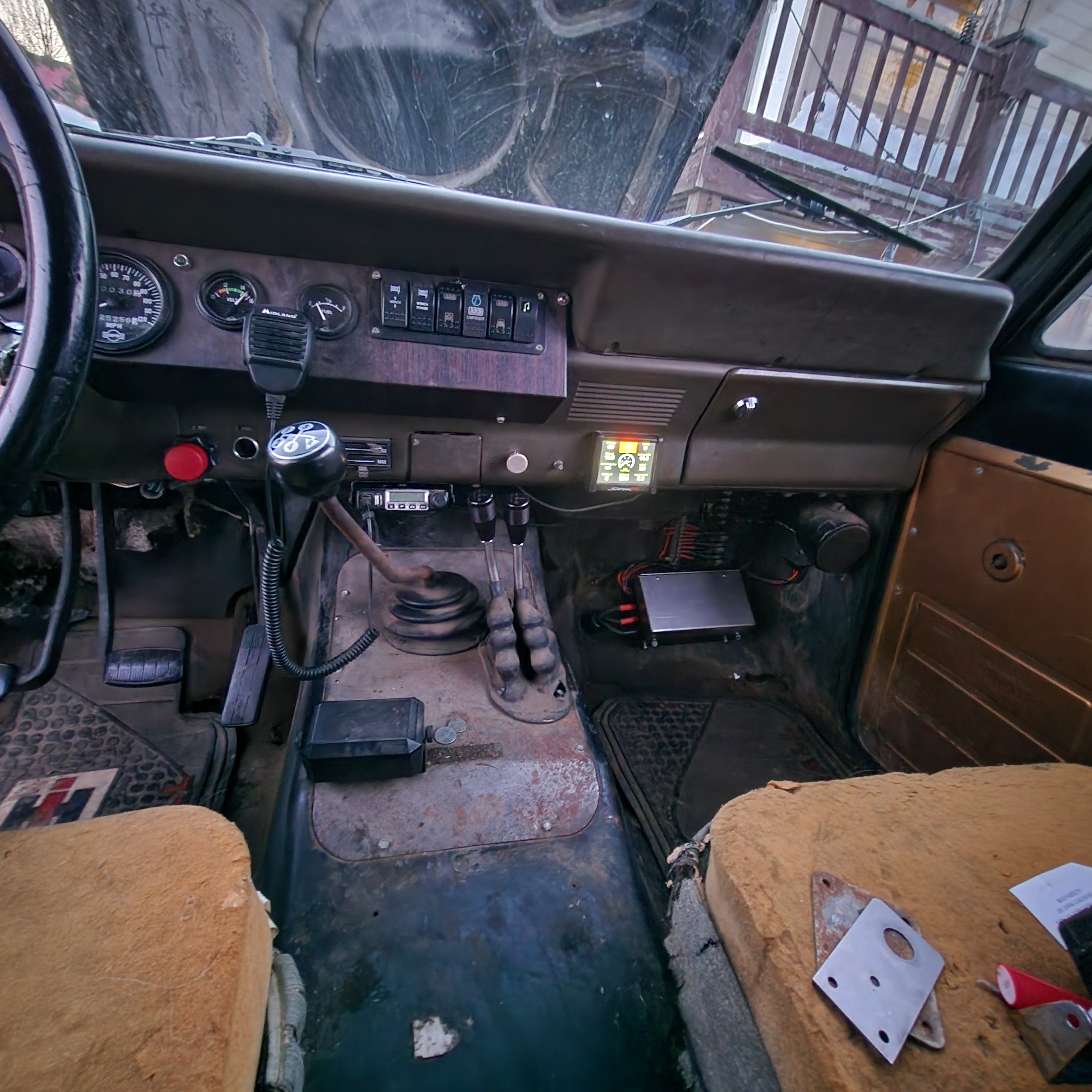

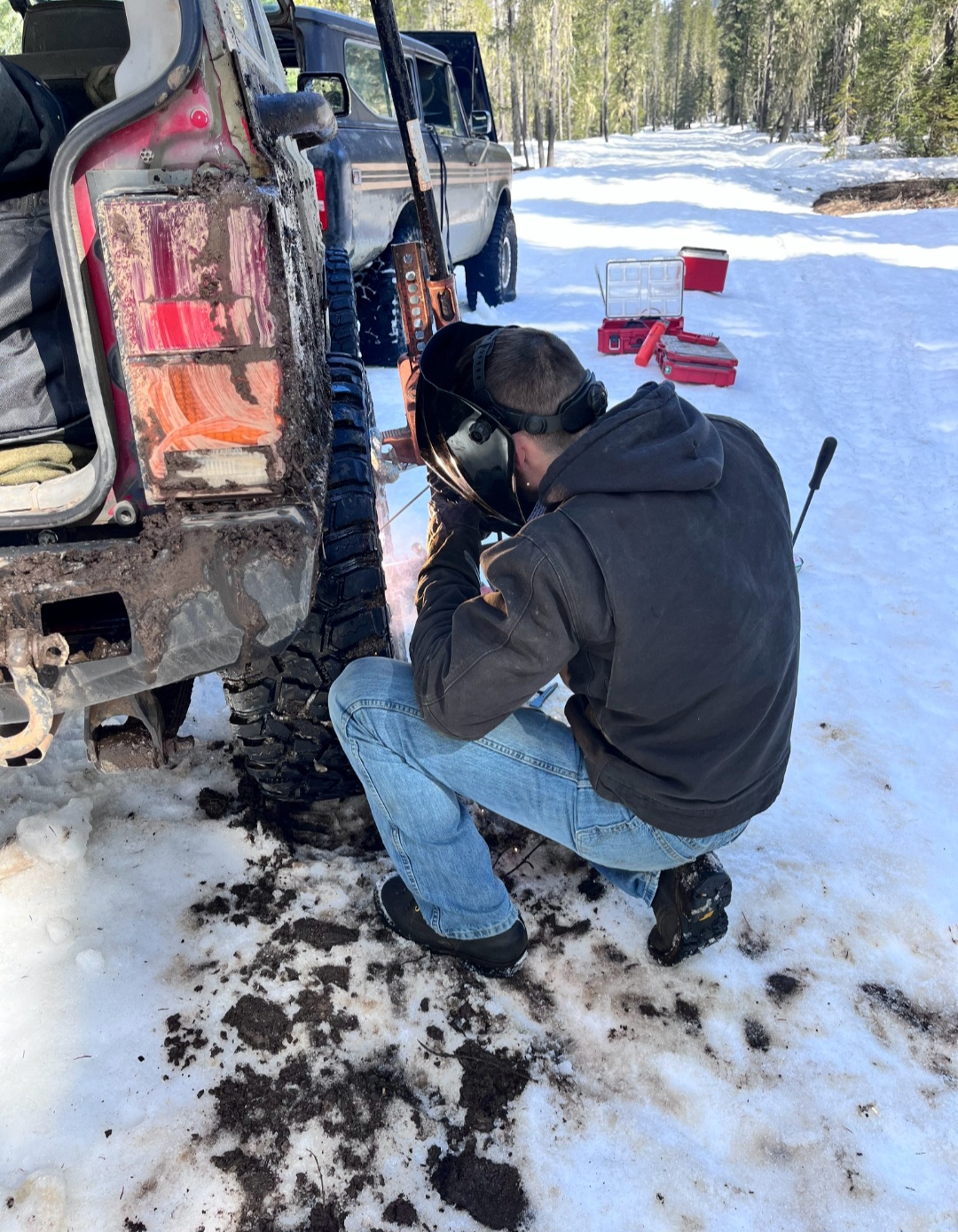

Got the Premier Power Welder all installed. Such a nice piece of equipment. Can't wait to practice some welds with it.
Are they waterproof? Scouts love to leak water there, I'd be concerned about shorts.

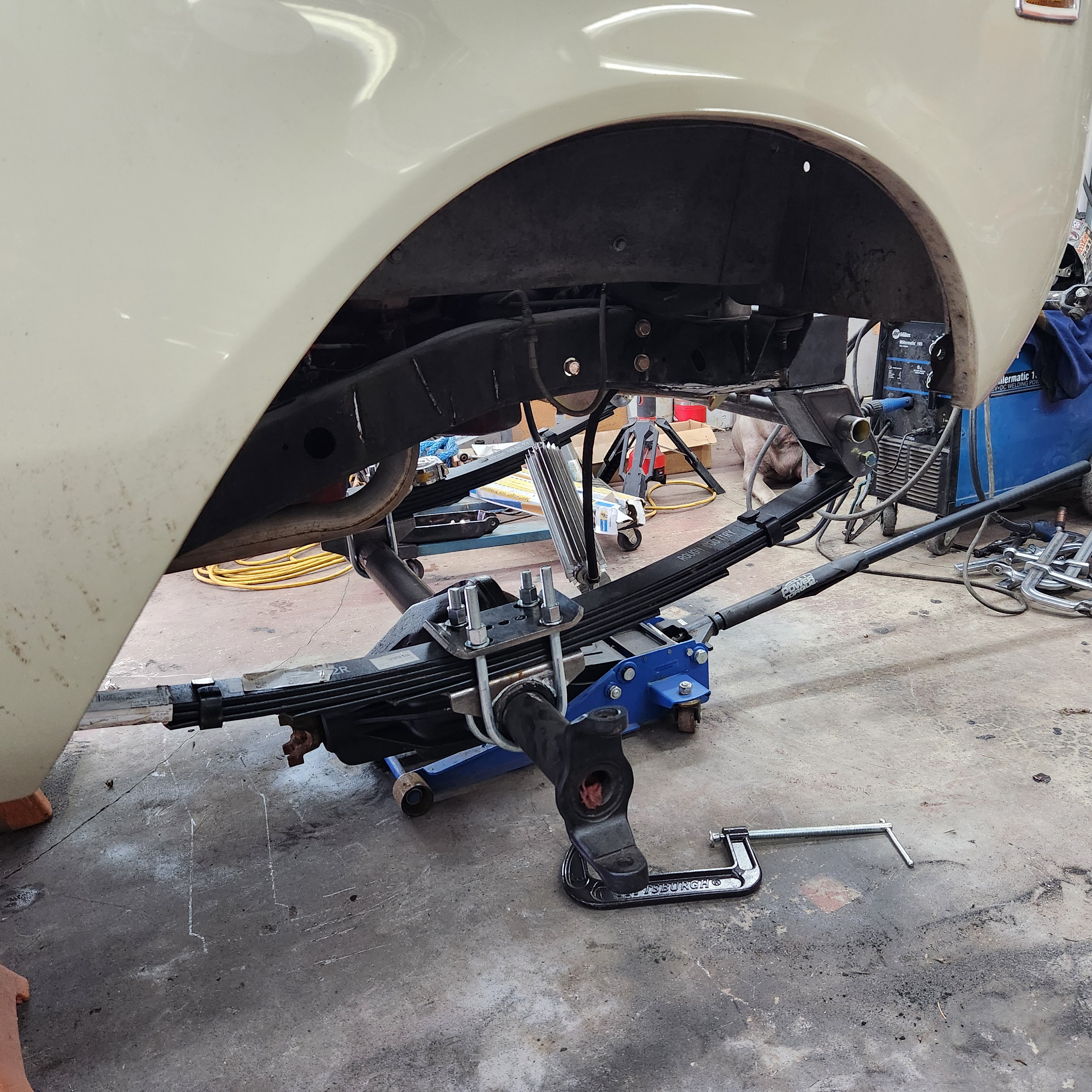

Helping my friend Cam out with the CPT Long Travel kit. Super nice kit and makes me really want to put one on my scout in a sua configuration. Very nice!

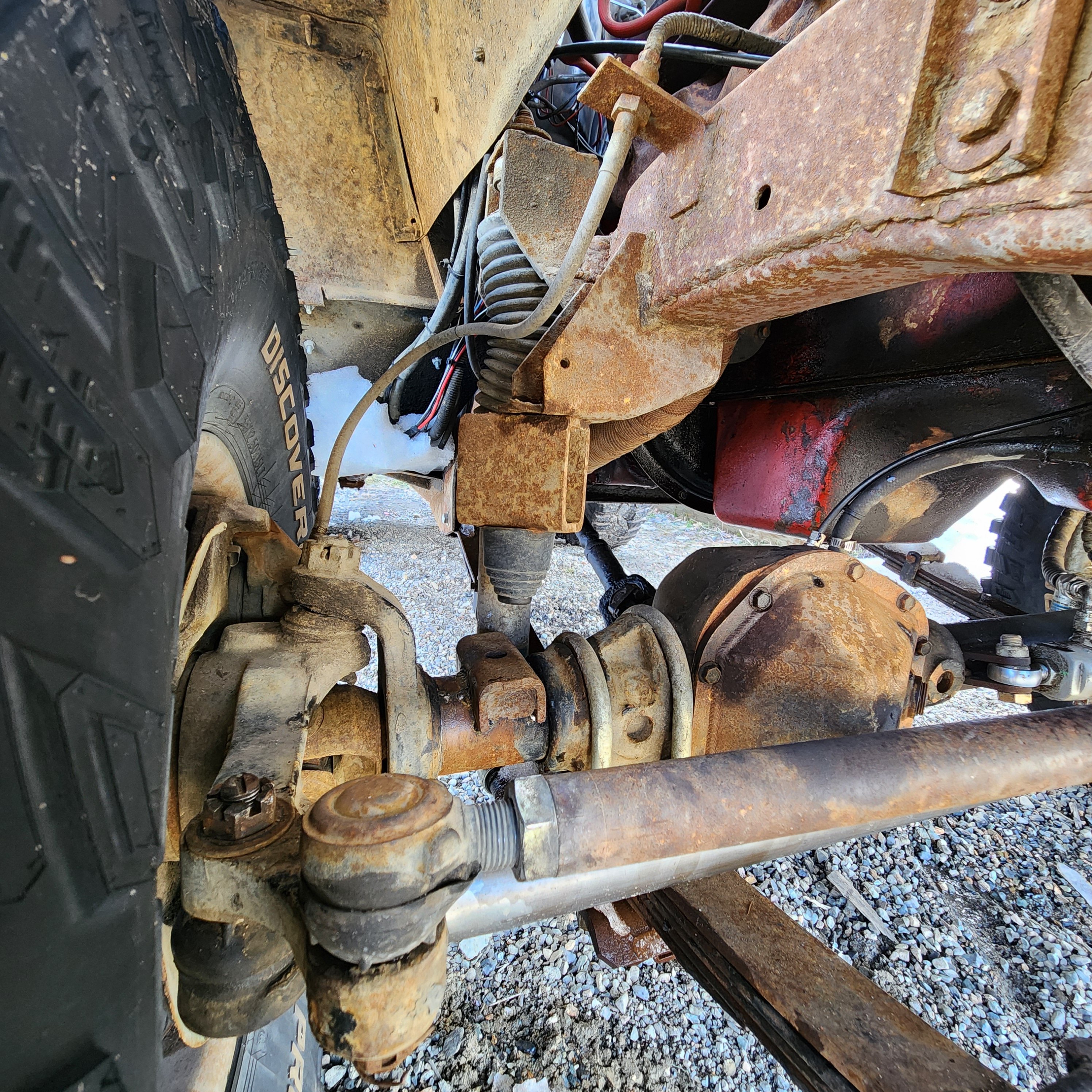

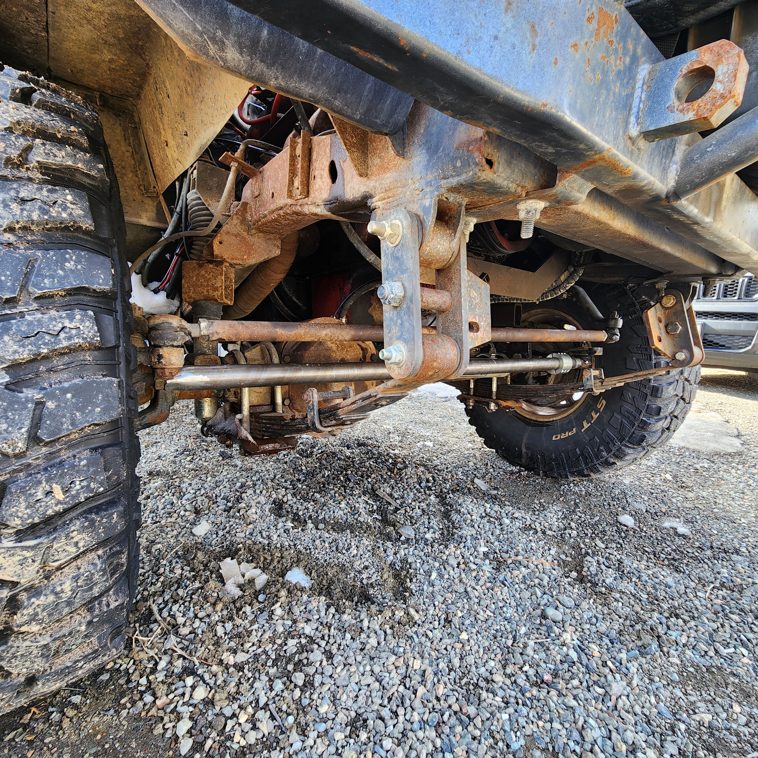

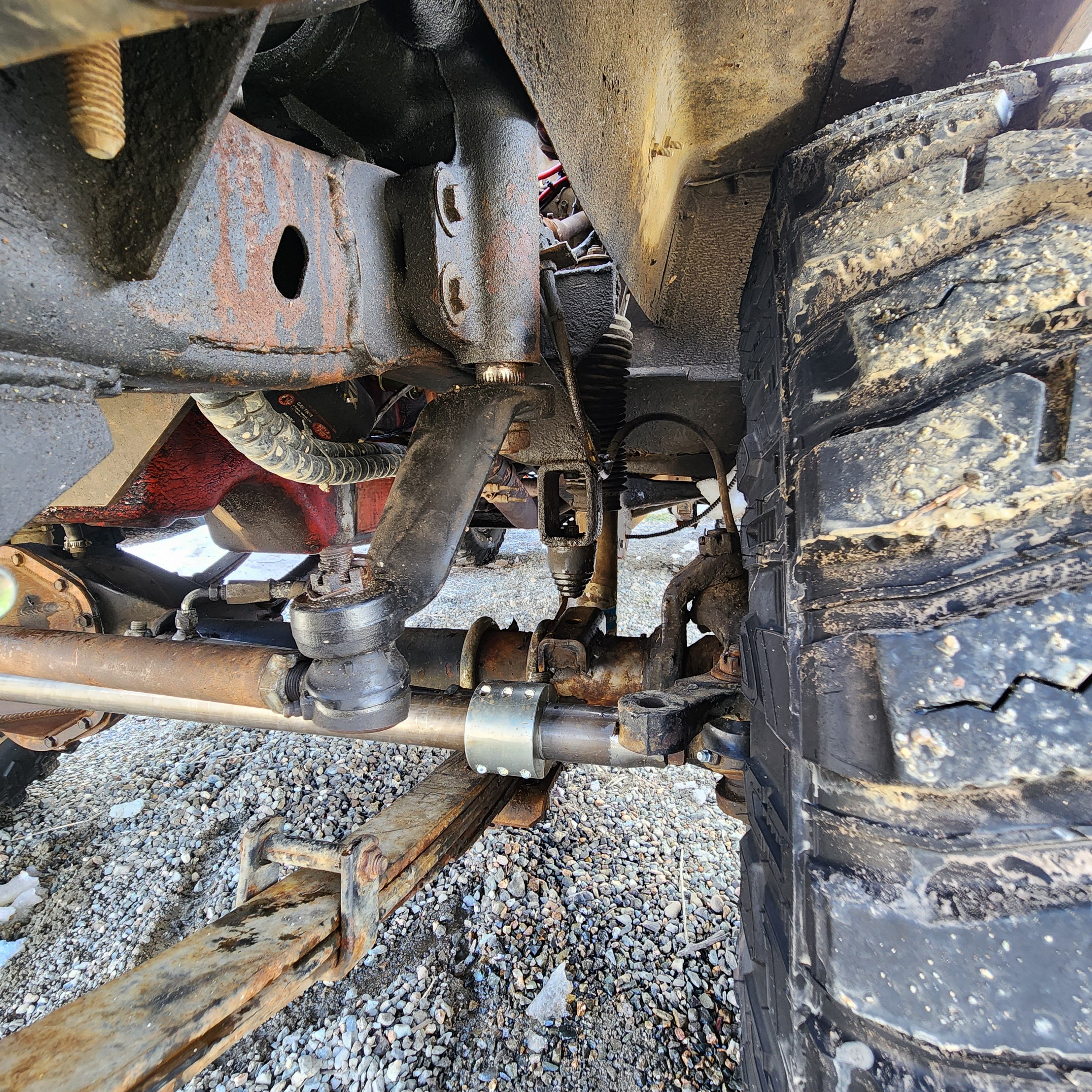

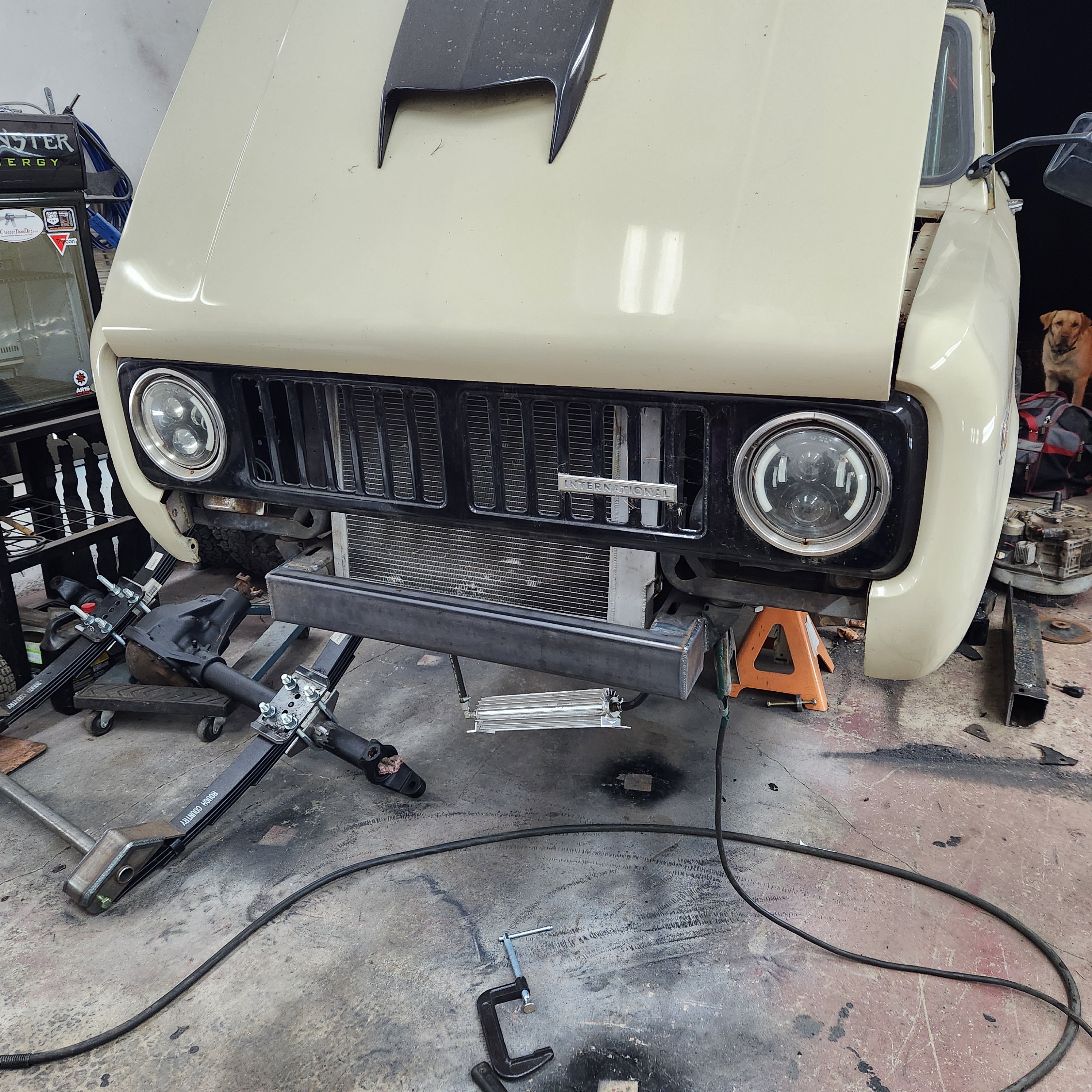

Got a 1.5in tierod from Ruff Stuff. Finally got it welded up and installed. With the bigger tierod, I was now able to use a tube clamp for the hydro assist. While I had it apart I also welded in some trailer leaf perches that I am using as bump stop pads. This way the bumpstops won't roll down the axle tube.
Don't zoom to look at any welds. They are not the best. Still trying to re-learn stick while using the Premier Power Welder. Should be stout enough for bumpstop pads.

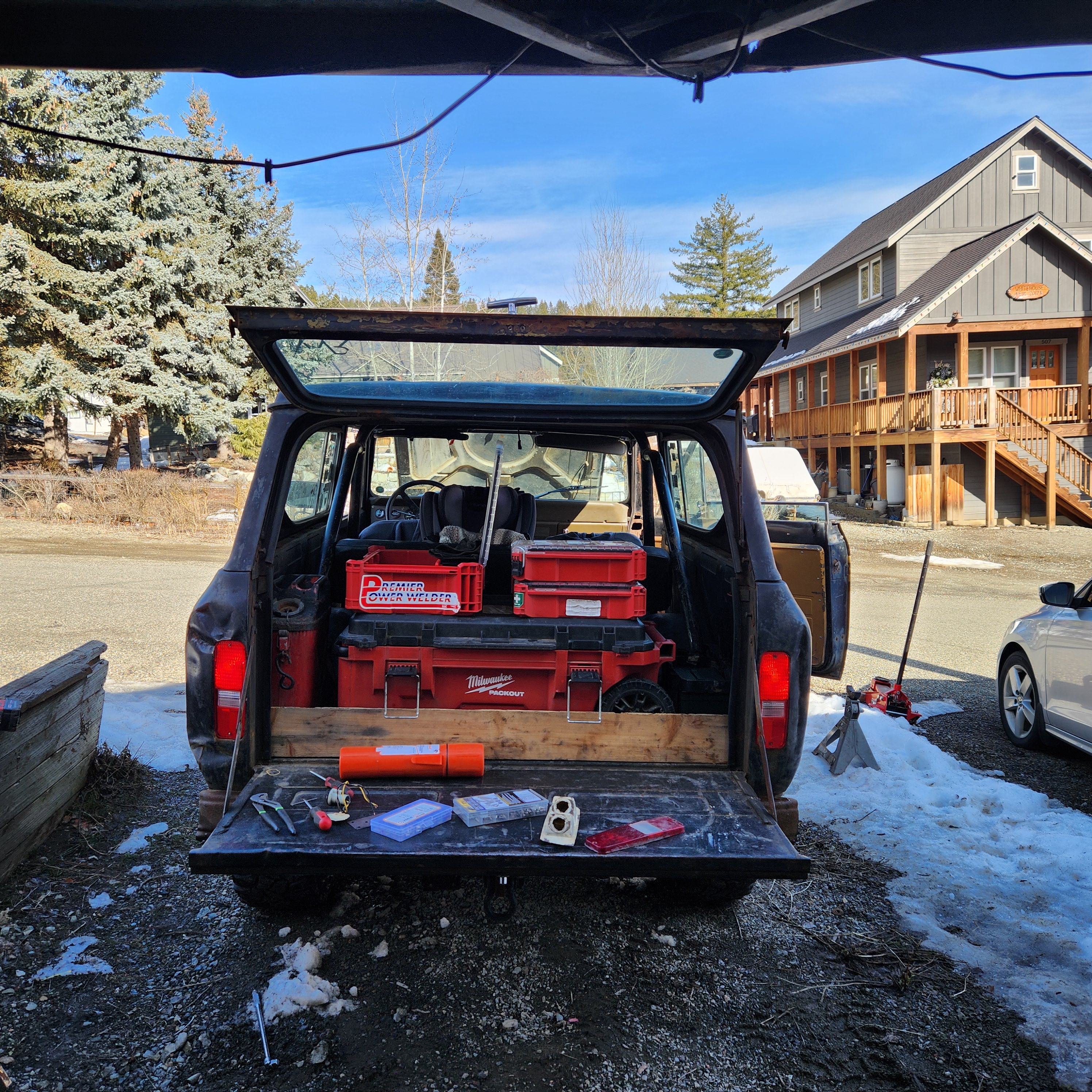

Here is my setup for all my recovery, Trail-repair, and tire inflation/deflation. I carry a bunch of stuff.

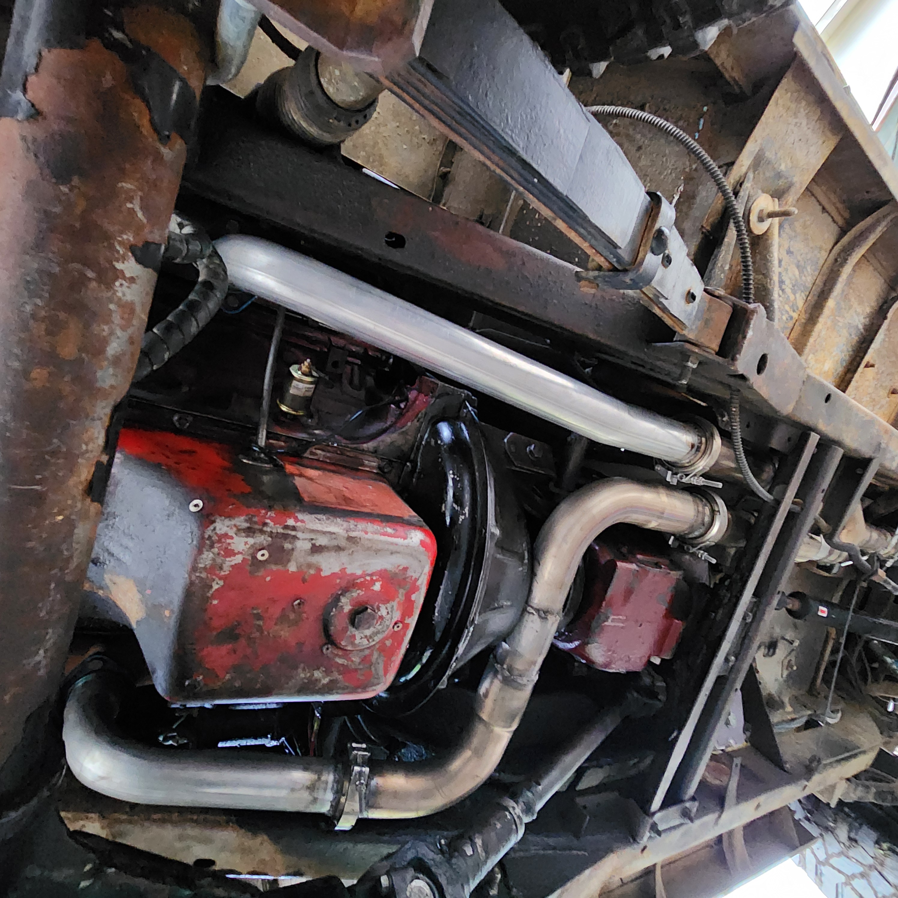

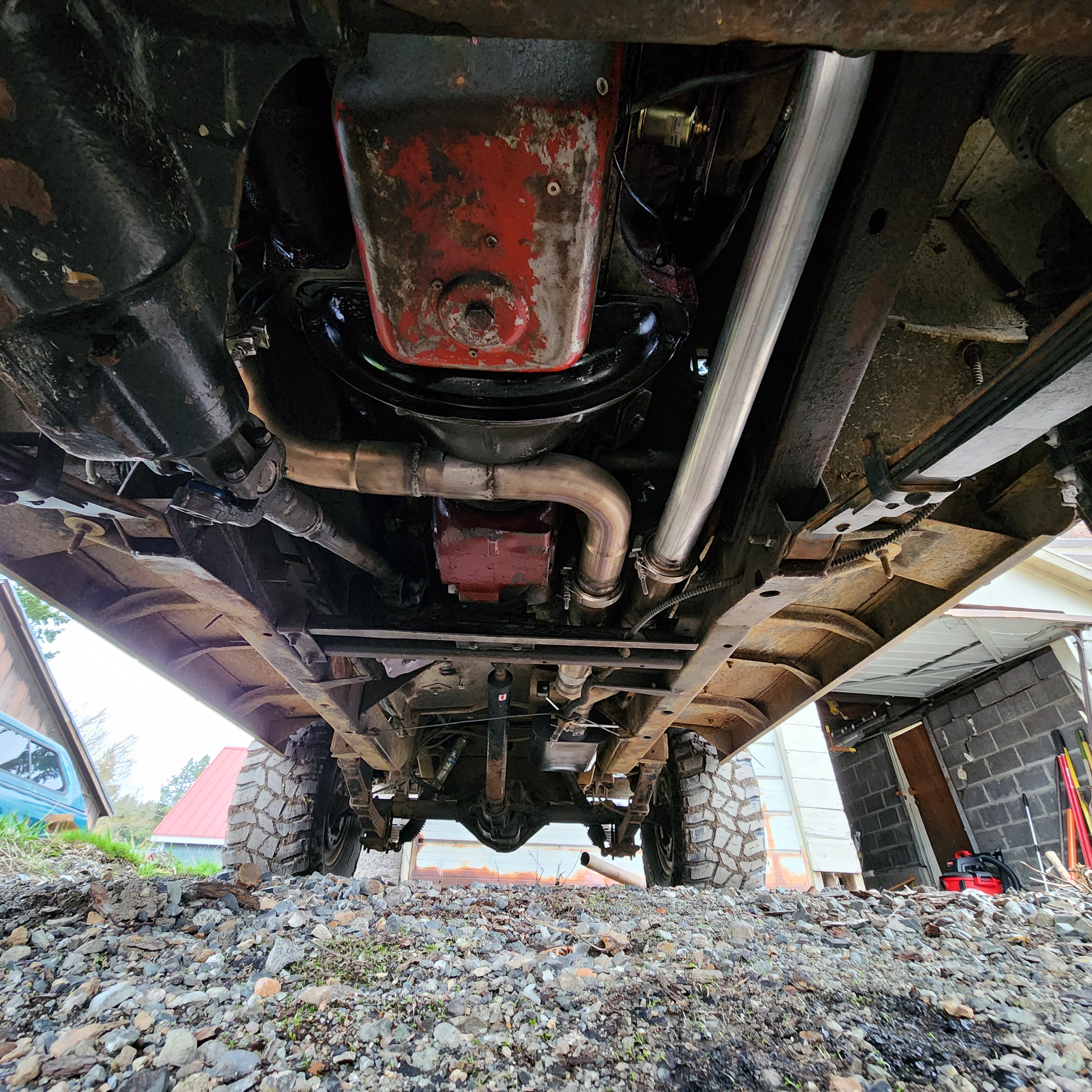

Finished up my first homebrew 2.5in exhaust. Used some Vbands and a flowmaster 50 series delta flow. Made it a single exhaust and overall very happy with it. Going to be making a heat shield for the bell housing access cover. Will post pictures once that is done. Noise level is pretty minimal with the 50 series but has a good rumble to it. Haven't had any drone problems at speeds.

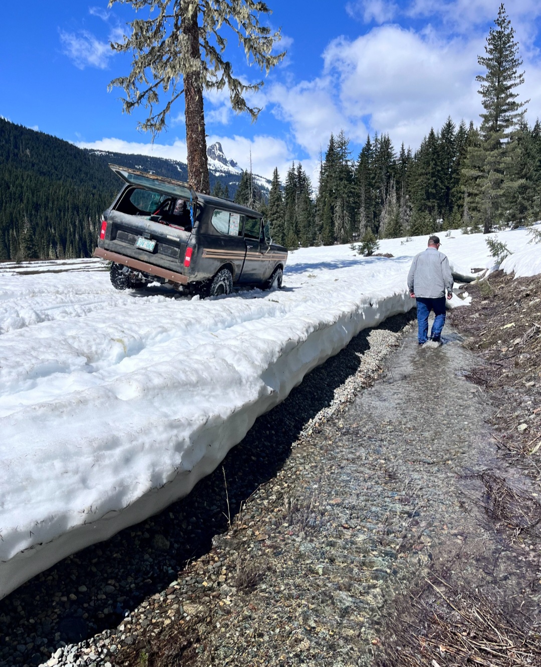

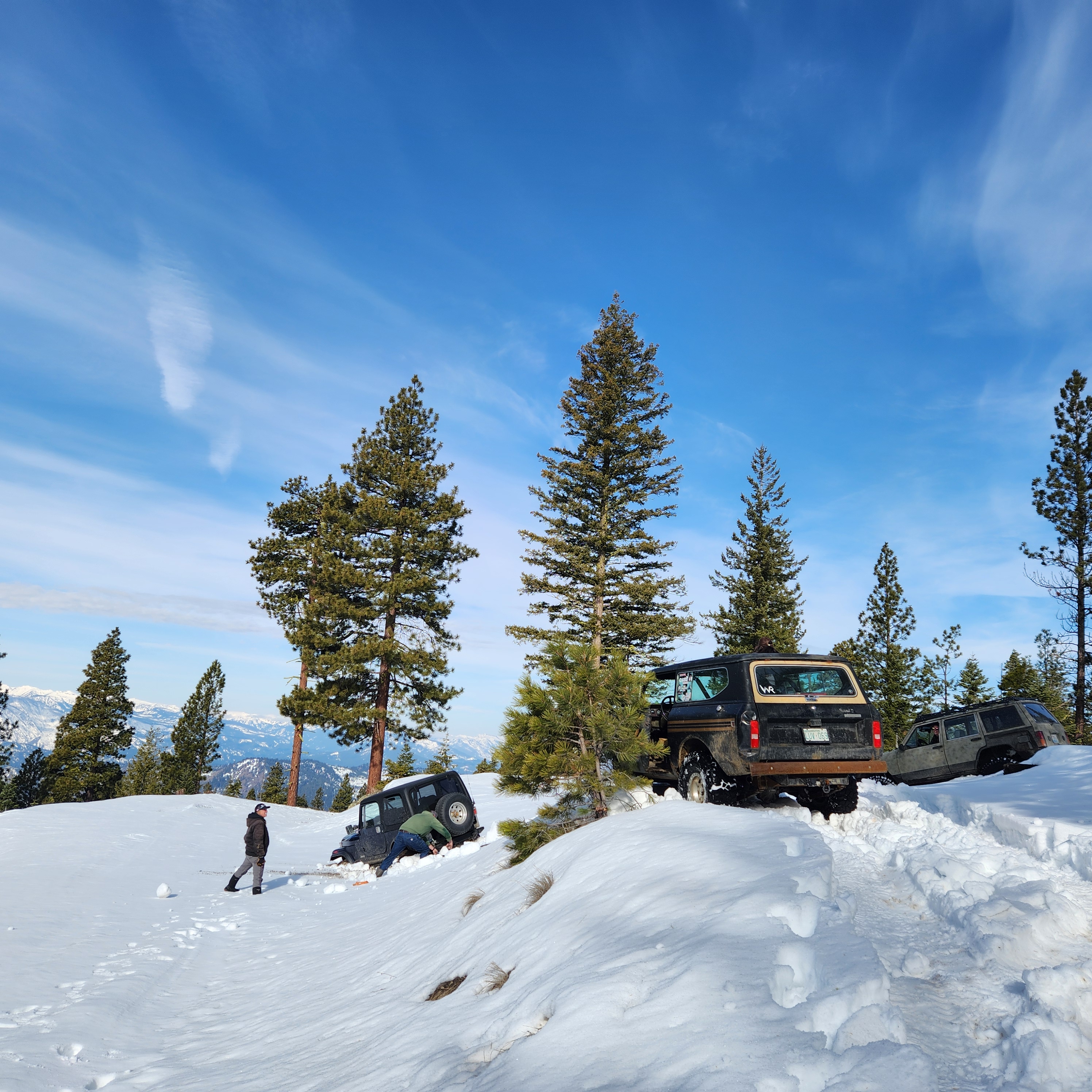

Went out to Fish Lake over the weekend. Had to show the automatic guys why a manual is superior in spring snow. Ended up having to break about 4 miles of.pretty deep soft snow for them. My family has been spring snow wheeling this road since the 70s.

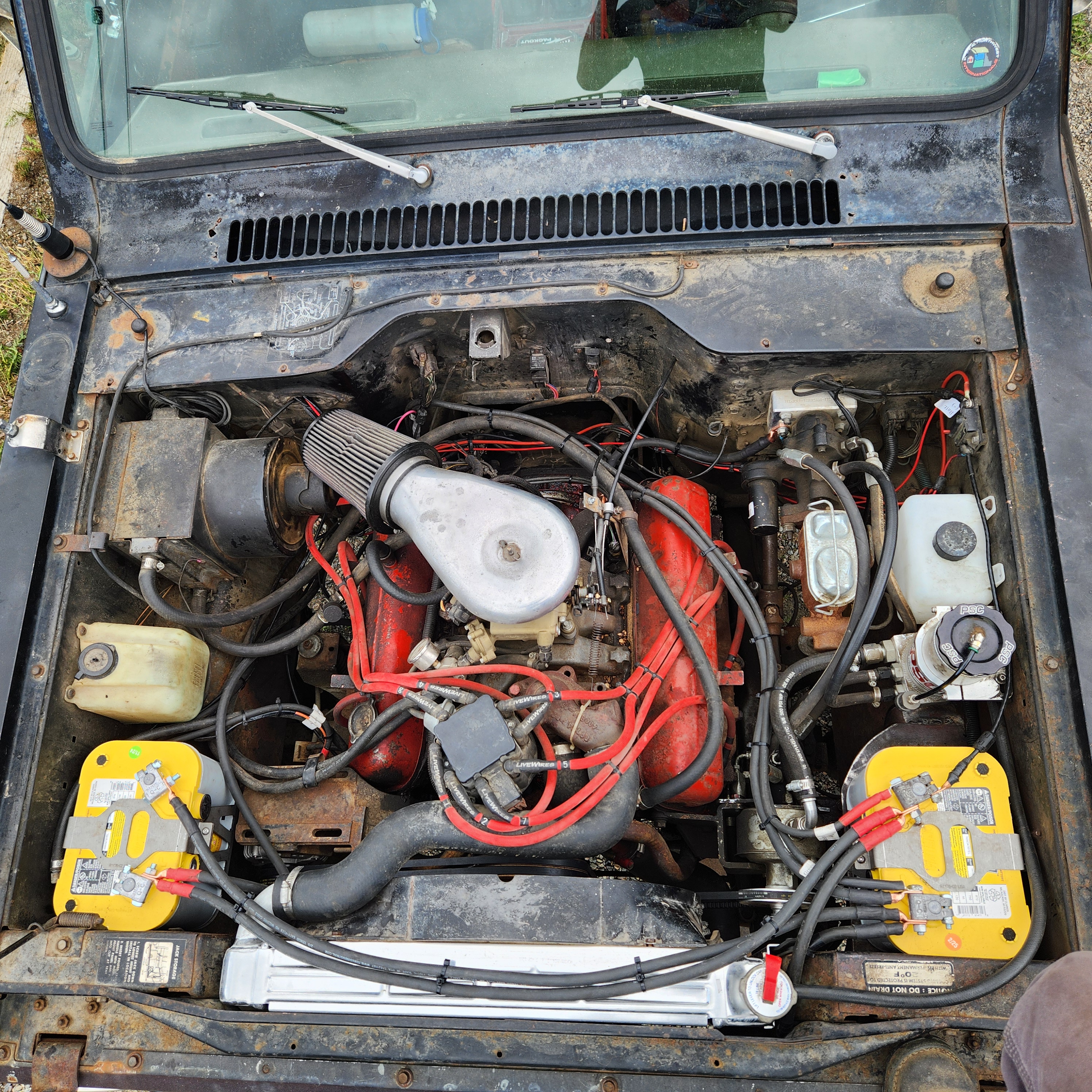

First winch test with the Dual Optimas. Thing rips. Did a full pull of 125ft with zero drop in voltage. Going to be pretty slick for the spring snow and my side gig for offroad recovery
