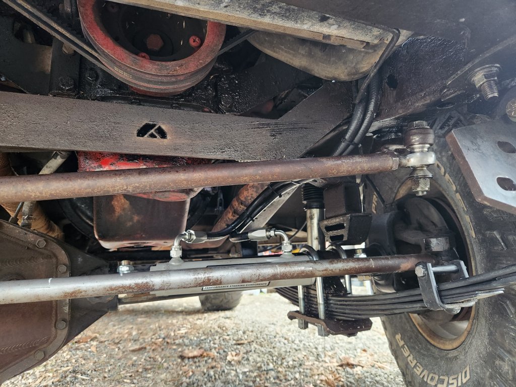

Pitman arm update. I ran a Waggoneer Pitman Arm with a 1in drop for almost 3 years. The shorter arm gave 7in of steering travel side to side in conjunction with the stock knuckles. Yes it reduced the turning radius but with 35s it stops an 1in before the tires rub on the springs. I always read that the skyjacker pitman arm reduces the turing radius and I totally overlooked the fact that I already was using a shorter arm. Turns out they are the same length eye to eye. So I bought the SJ drop pitman arm as I have been running into bump steer ever since I swapped to the waggy arm.  Here are the side by side comparisons between the two arms.
