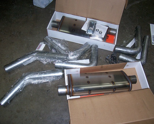

Silently waiting behind the scenes, I have been slowly collecting parts for this beast. These just came in today :d
attachment.php
I pair of o2 weld in bungs with screw in caps. Eventually that will lead into yet another upgrade sometime. A pair of three chamber magnaflow xl mufflers. Some straight pipe, 90* bends, and a couple 45*. The old two chamber flowmasters are just way to damn loud for my taste. And the way the the pipe is routed prevents me to install a front prop shaft.

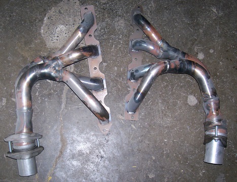

Then of course I have had these up on the shelf for awhile, waiting for the above parts.
attachment.php
Good ole stan's tri-y. I'm actually seriously considering sending them off to get coated.

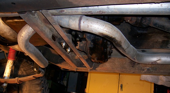

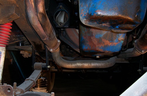

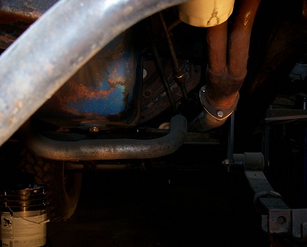

Mine too. Along with going broke in the process. Which is partially why it has been taking so long for this build. Here's a few shots of what I'm currently dealing with. In no way am I harping on the person I purchased this beast from. I fully understood what he was trying to do. It's all good on my end. I'm only posting these snap shots to show why I currently install a front drive shaft. And as to why I want to replace the headers.
attachment.php
attachment.php
attachment.php
The passenger header has a couple decent sized dents in the tubes. When I route the new exhaust tube between the new headers and mufflers, I'm going a straight shot on both sides between body, frame and transfer case, instead of all those multiple bends

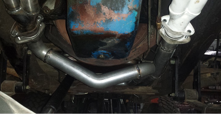

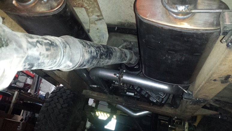

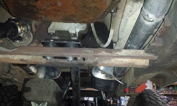

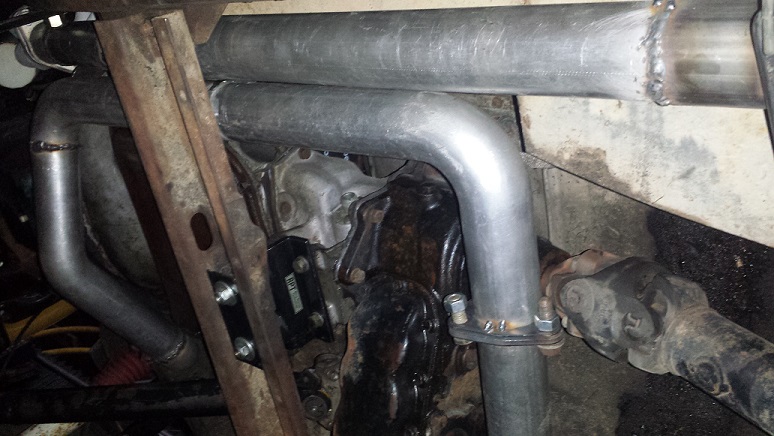

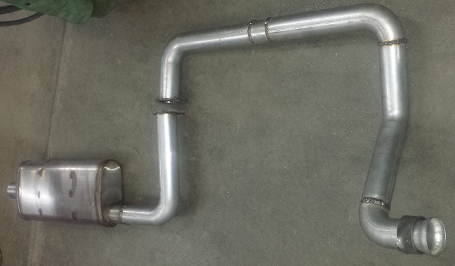

Now that I'm getting a little break from helping another member on here doing a hamilton TBI install on his little baby 69 800, I was getting a little busy with exhaust work. Driver side is complete for the most part.
attachment.php
attachment.php

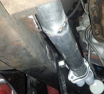

Aint purdy, but functional. Only thing left is plumbing out the butt end of the new muffler. The other new muffler is currently just hangen out on the block waiting for me to actually mount up this next make shift contraption:
attachment.php
I'm in the works of adding a 3 bolt flange to end of plumbing. Which will make it easy to pull this section of pipe out, without having the muffler attached, in order for any major service to the auto trans.
Also, speaking of FI. I'm also welding o2 sensor bungs into the exhaust system. Future plans for this beast of TBI :winky:

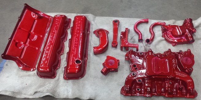

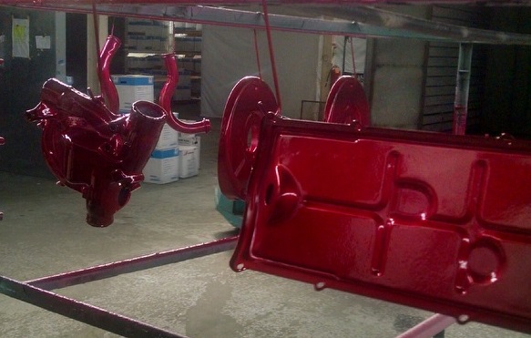

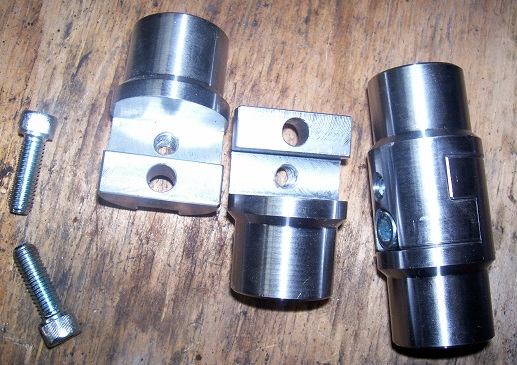

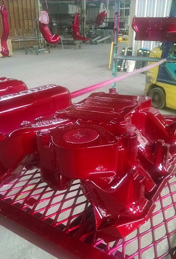

Well, after sitting around patiently waiting, she finally starting to get a little loven. Just received these parts this morning from the powder coater. If time is permitting, maybe these parts will be re-installed next week.
attachment.php
attachment.php
attachment.php
Dear gawd those parts look nice! Curious, when you send stuff off to get coated, do you need to do all the masking of threads/ports and stuff, or does the place generally know what to avoid? I've never done anything like this before, but I foresee a lot of it in the near future :d
