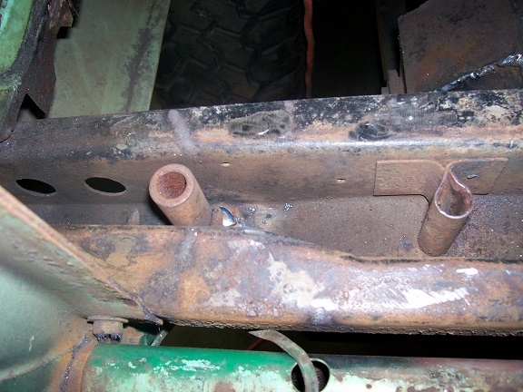

Old piston wrist pins come in handy. Had a collection of them from when I scrapped some messed up no good motors and recycled the cast aluminum pistons.
Before I permanently mount the rear section of the floor above the fuel tank, I added a spacer in the rear most channel that the floor sits on. Basically an anti compression spacer when the bolts are tightened up. This will help reinforce the mounting bracket foot for the rear most hoop of the cage I'm building. The factory mounted spacer thingy is for the body mount bushing bolt. More photos will pop up when I actually start bending and building the cage.

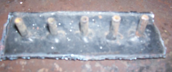

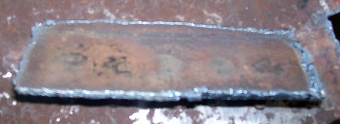

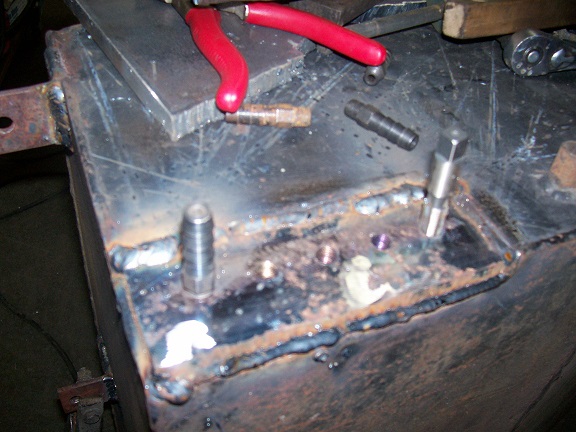

Last weekend, I did work on the 33 gallon fuel tank that I'm planning on installing. One thing I wanted to do is have the option of threading in plugs or pipe nipples into the location of the five 1/8" vent tube holes. I cut a piece of 1/2" thick flat stock and then drilled & pipe thread tapped five holes. Then had an interesting surprise when I cut out the old vent tube section. They were ultimately useless and pointless. Had I known, I probably would not have done this. Too late to turn back now.
Here's the old vents that I cut out
attachment.php
attachment.php
It's like, why even bother going through the trouble of adding those vent tubes, if holes were not drilled through the sheet metal
here's the new piece welded into place:

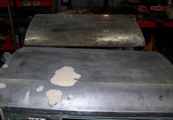

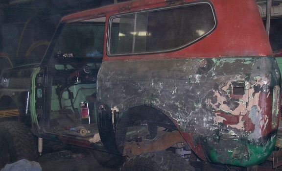

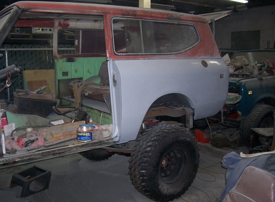

Well, while I wait patiently to win the lottery, but need to play it though, to purchase a few things for this build, I was in some ways getting tired of the paint scheme. Which kinda cured my boredom for the time being. So went to town in stripping and sanding paint down to metal. Not sure yet what the end result will be. But here's where I'm at now.
attachment.php
attachment.php
attachment.php
Lot more bondo on the rear left corner of the cab than I thought. The driver side front fender has semi major rust down at the bottom near where it meats the door. I May end up using the spare one on the shelf that I picked up from Mike from IHPA. But them again, I May end up beating on it on the trails. Passenger door had several 3/4" holes among a few other 1/8" holes, all from old side mirrors. Which I patched up with a weld-in plug, and I'm in the middle of minor bondo work. Just ordered up some threaded inserts so I can mount new(used) side mirrors

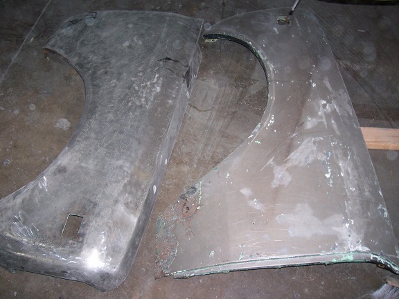

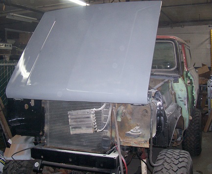

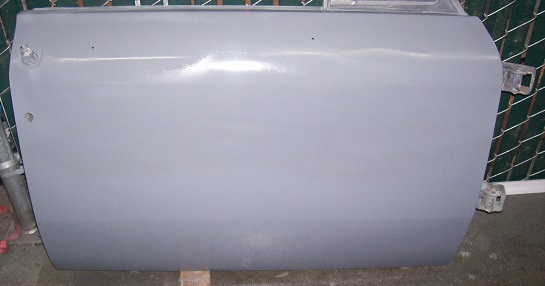

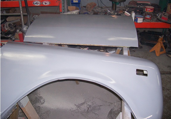

After patching up a few buggered up holes from the old side mirror mountings in the doors and the non existent moldings and a couple coats of paint, both doors, one fender(passenger side), and the hood are painted.
attachment.php
attachment.php
attachment.php
The driver side fender has rust issue, between wheel well and door. Debating weather or not to leave it or use the spare one that I have on the shelf. Since I most likely might bash it against a rock or tree:)crazy: hope not) I May just use the rusted one. In the mean time, when the paint dries, I will re-install the door handles and locks. Along with mounting side mirror brackets.

As far as the paint job goes, it's all gonna be rattle canned. When I started stripping old paint from the exterior of the tub, lots of bondo was uncovered. And both end caps, that hold rear tail lights, are all beat up. Passenger side worse than the driver side. Yesterday, I was talking with another tenant here in the building who does body and paint on mostly ole classics and offered to help paint my rig. But, since I plan on hitting the trails with this beast, I most likely will be bashing it on a few rocks and trees here and there. I will just carry a spare rattle can and maybe a band aid or two for a little touch up when needed.

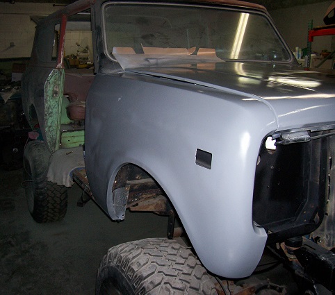

Needed to clear up space off my saw horse make shift work table and mounted the right fender. I will end up pulling it back off at some point. I pulled a dumb blondie moment and forgot to mount the antenna. But for now, this is where it sits
