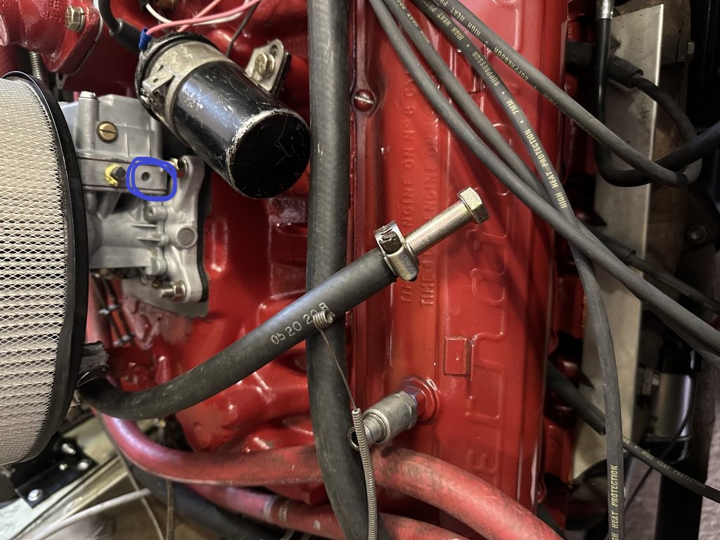

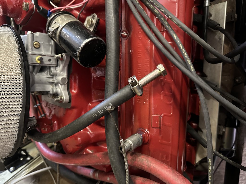

I believe I found the source of the vacuum leak. I have a hose from the intake manifold to the right bank (even) Valve cover, pcv connection. This still may not be the only one. I plugged the hose off and this did make quite a difference. I could get the motor to at least run with the choke closed about 1/2 way. I did get the motor running with the choke open and it was running pretty smooth. I set the timing at 9 degree btdc and played with the air/idle screws. I did rev it to at least 2k RPM and held it there, all good. Shut it down and tried a re-start. Would not start. I have a vid of the motor running. I just have to figure out how to get it down loaded.

Need to see more pics of the engine from other angles. Usually, the PCV valve is in the rear of the valley pan behind the carb and the flame arrestor is threaded into the right hand/odd numbered bank valve cover. The two devices are similar in appearance, but quite different internally and functionally. The PCV valve has a check ball inside that should rattle when shaken. The flame arrestor is stuffed full if a steel wool substance. A hose running from it should connect to a fitting in the underside of the air filter canister. The PCV valve meanwhile is connected to manifold vacuum. It's important to have a functioning crankcase ventilation system.
what's going on there ? i haven't worked on a holley in a long long time, but should there be an idle mixture screw there ? or a vacuum nipple ?
Let me take a look. I will add more pics of the engine later today. I will all so try and get the vids to load. Based on info from Scoutboy74, I definitely have the PCV valve in the wrong location. The connection on the odd bank exhaust manifold is currently capped off. What should be screwed in at the even bank valve cover?
