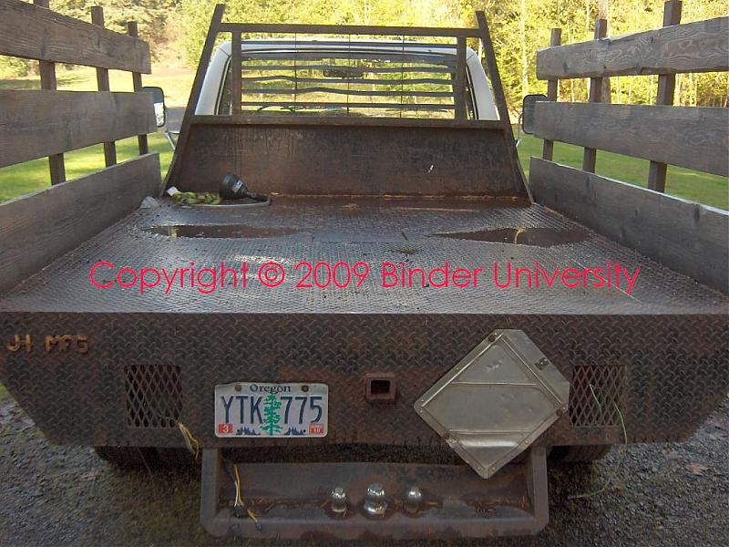

Even the statute of limitations has run out on "wilbur the 1300 flatbed", curt has agreed to part him out (we'll keep the motor though). Needa dual wheel timken axle??
But..this news just in! Sonja has a '82 f-350 dually/flatbed witha 400 motor/c6 combo that's runnin' propane but is too far gone in the front end to be safe to drive. So she's gonna part it out.
Best part...it has a j&I steel bed on it very similar to this one:
j&I manufacturing - truck beds for farm, ranch, welding, oilfield and industrial applications.
So today, the rig moves up here for bed removal...it is now mine!!! Once the bed is off, the rig goes home with sonja and bill for disposal of the rest of the schnizz! The propane combo is gonna be a hot ticket for someone.
The bed is gonna git cut down to short wheelbase config and go on the beatertruck upgrade.
so today, the rig moves up here for bed removal...it is now mine!!! Once the bed is off, the rig goes home with sonja and bill for disposal of the rest of the schnizz! The propane combo is gonna be a hot ticket for someone.
Perfect!! You are going to have a very nice service rig when you get finished with it.
By the way, when are you going to get to work on your own stuff?? ;)
That j&I bed will come off the Ford today some time, the sun is out and it's not raining like normal! It's in outstanding condition...I'll remove it inside the shop so it will be adjacent to the cutting/welding gear for modification.
Since I already have that pro-fab aluminum crossbed box, it will be incorporated, I also plan to set up at least two more boxes either on top or underbed once it's test-mounted for initial fit. Provisions are already in the bed floor for a flip-over gooseneck setup, so once the bed is mounted that will be beefed so that a fifth wheel hitch can be mounted to the flip-over as well. I want this rig to be set up to tow any trailer combo I might be able to beg/borrow/steal...especially lyle's trailer ( I know he needs a place to store it that is more convenient to me)!

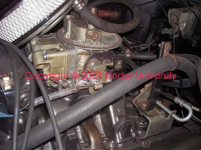

An update for the sonjamobile...miles have been accumulated and surprise...surprise...the rotten fuel tank syndrome has struck. This was an existing problem before I ever hooked up with sonja.
So the fresh 2300 carb is trashed again, it's on the bench this morning for another clean-out session. And I'll go ahead and revise calibration now to hopefully fix the drivability glitch. Once that is solved, we'll do an electronic distributor setup using a mag-trigger conversion I'm assembling currently.
Sonja and bill snaked a nice sii tank from a diesel rig at Mike fiock's yesterday that will go in tomorrow or Saturday (we'll be in oc for the IHSTO pardee tomorrow). Being diesel, the tank is pristine internally. Bill is an accomplished wrench and can easily handle this deetale!
This tale is actually getting better now...the brake set that bill installed actually works!
And...for a IH noob, he even managed to get the fresh fuel tank swapped and all the plumbing squared away, installed it by himself!
Then we scruud with the carb some more a few days ago...no dice.
We knew that this carb was a Holley 4412 which basically can't be made to work on these motors. But sonja swore it ran just great with that carb after she had it installed years ago. But I kept tellin' her no...it can't!
So she looked at it hard one last time...and then the bulb lit...this carb is not the one that was on the rig when she left it with the azzhats way back when that ripped her a new one!!!! That one had a glass window in the fuel bowl (standard on a few versions of 0-7448 list back then). She also noticed a few other differences, stuff that I did not do.
So them sumbitchs stole the 7448 off the ride way back, and subbed a 4412. Since she never actually drove the pos after that, she had no way of knowing the carb was wrong...and to the average person they look identical.
So me and bill built an oem 2300 from about a '69 345 outta a pickup, manual choke. But I stuck on a center-hung fuel bowl so at least the mixer would look like the real deal from long ago! Ended up totally re-working the accel linkage along with the kickdown stuff since this carb is quite different in that area
that cured the problem, bitch hawls the mail now and ya can actually accelerate from a dead stop without stumblin' over the front end.
So now sonja's got a real dd with a choke that will work. Bill also figgrd out why the heater ain't heatin'...after all, he's a dam electrician. Guess what...the blower motor was unplugged...musta done that when he torqued them lug nuts...the first time.
One thang left to address now...the breaker points in the fresh distributor. Since this one already has a msd six box, it's gonna git a serious Holley distributor set up with a mag trigger to take advantage of the msd sparker, that'll happen next week, then we can jet this carb for the final time and be done with it.
