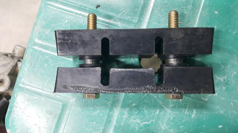

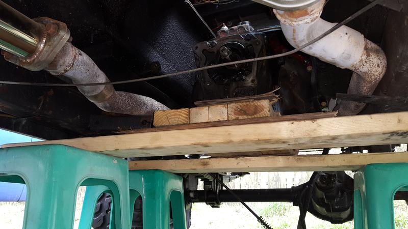

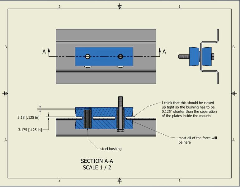

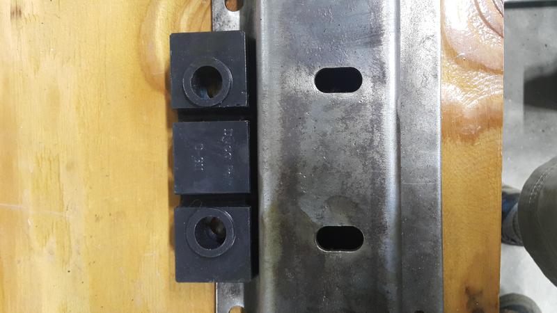

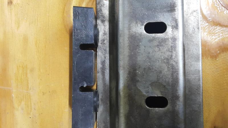

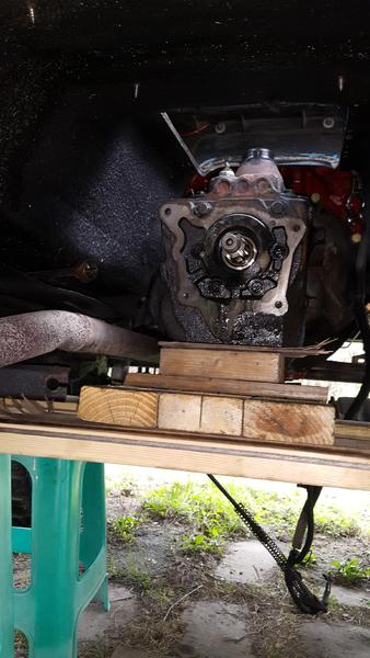

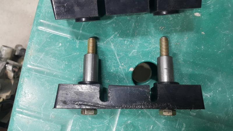

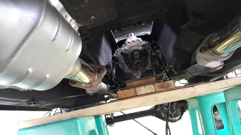

when the t18 in my Scout was swapped for a t19, the holes in the xmember were opened up to fit the shoulders of the mounts. 1 mount went on the bottom and 1 on the top. Long bolts ran through the whole package into the transmission. You will need the bushings. Something should be available locally that can be cut about 1/16" shorter than the height of the 2 mounts stacked.
Hint: get the bolts through the mounts started before mounting the xmember to the frame.

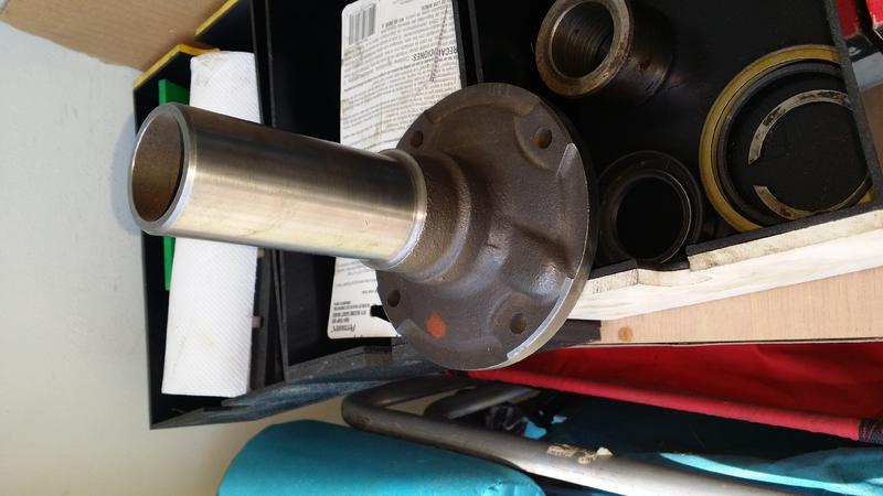

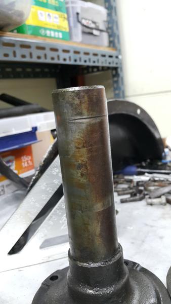

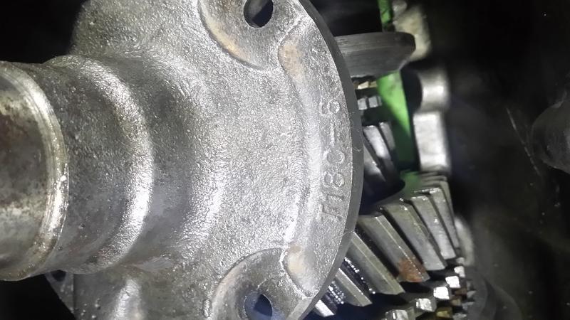

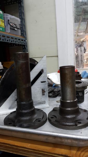

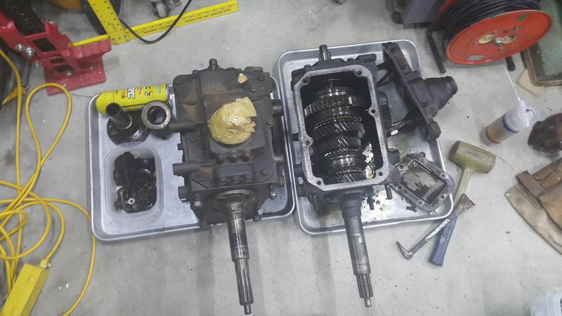

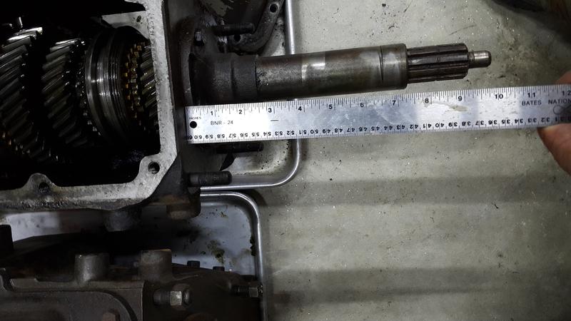

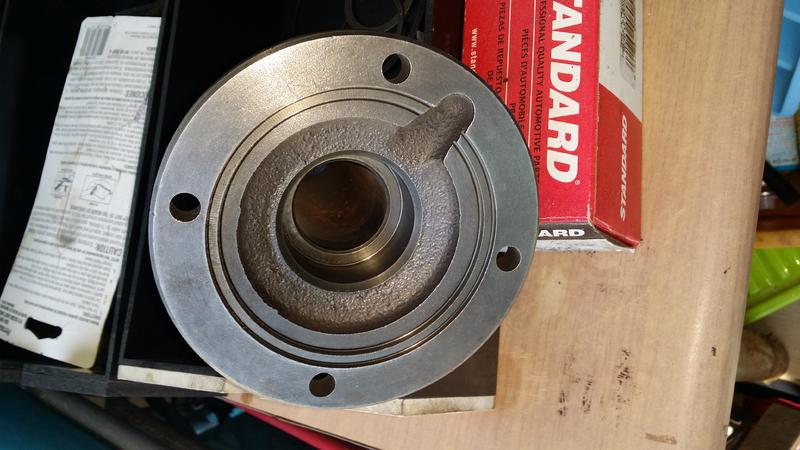

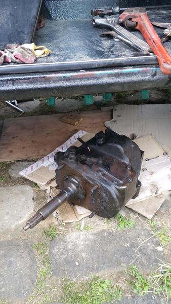

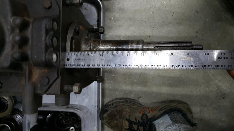

so I decided to use the front bearing retainer to push the front bearing on, it didn't work out... I notice that it is stamped t18c, does that mean that the front bearing retainer from the t18 that is presently in my Scout will swap in to the t19?
whats the # on your t-19 input shaft housing ? Or don't you have 1 ? Will check # out on mine,an report back. Jeff
I seen the # on your new 1 . T-18c ? Whats your old # ? If tey're the same then, you be ok. Jeff

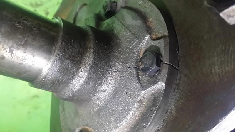

I didn't remove the shoulder on mine and so far no issues. Please remove that flywheel and lets have a good look at the surface.
