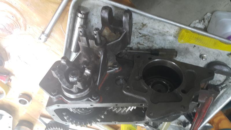

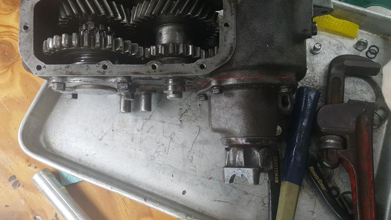

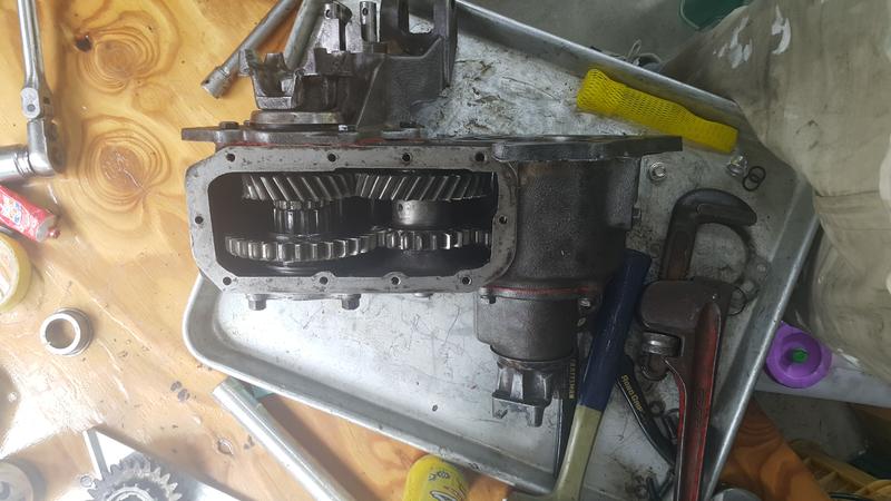

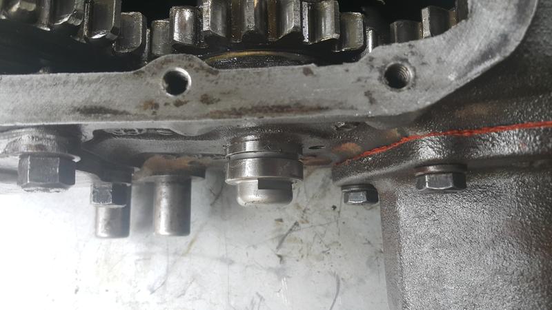

So, to keep from being bored, I rebuilt the transfer case. There were no issues except that I couldn't find my dial gauge until I was finished. So lots of install and removes until I got shims right. Here are some pics of the finished product. Of course, short one measly o ring for the intermediate shaft prevents me from declaring it finished. I also have a new high capacity cover that I will install after installing case into Scout.

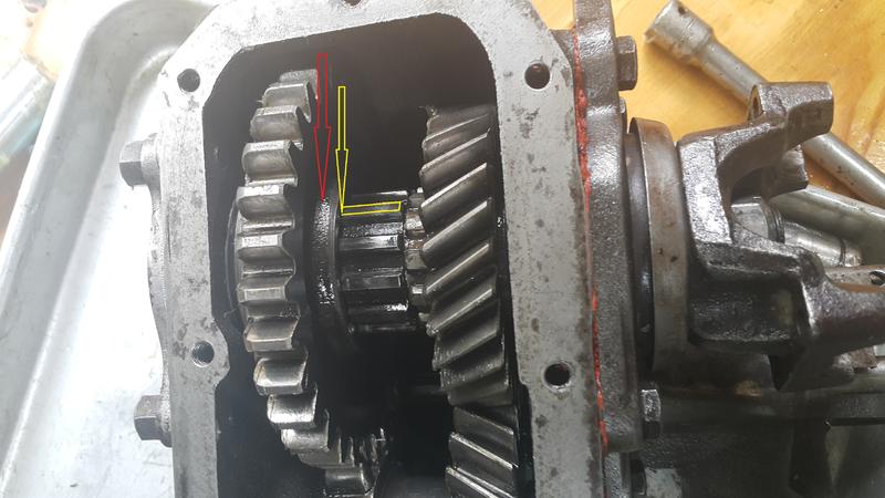

By the way, there is a lot of play of the sliding gear over the front output shaft. Like greater than 0.005" in fact each of the spines has a slight step in it just where the sliding gear ends (see arrows) I should have gotten a picture. Anyway, since it is the front shaft I am not super worried for the time being. I don't remember if this happened with my other transfer case. Any opinions?

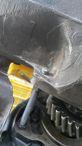

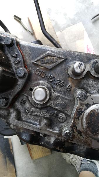

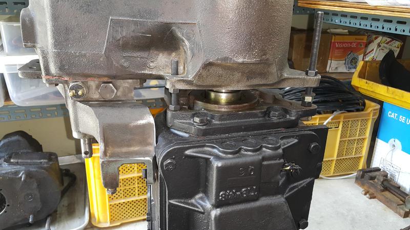

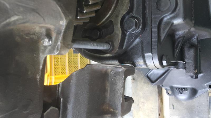

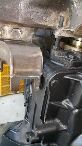

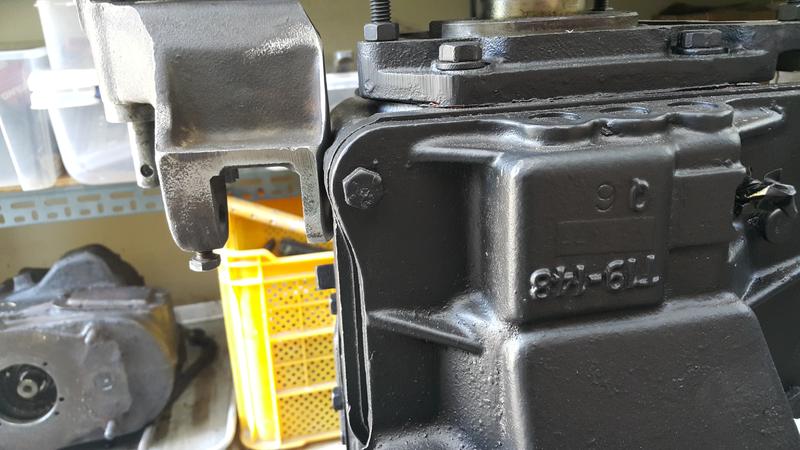

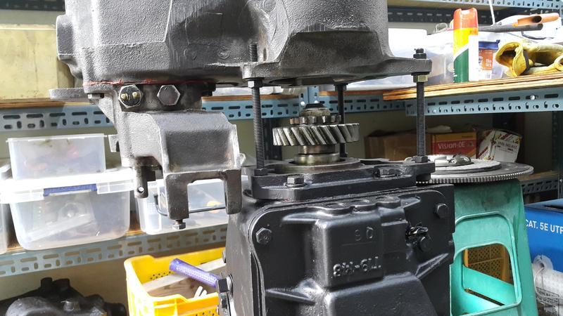

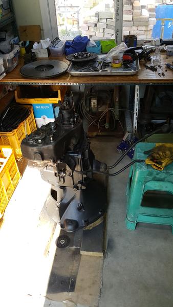

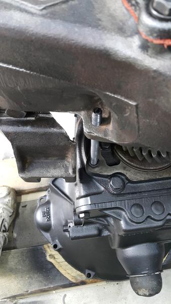

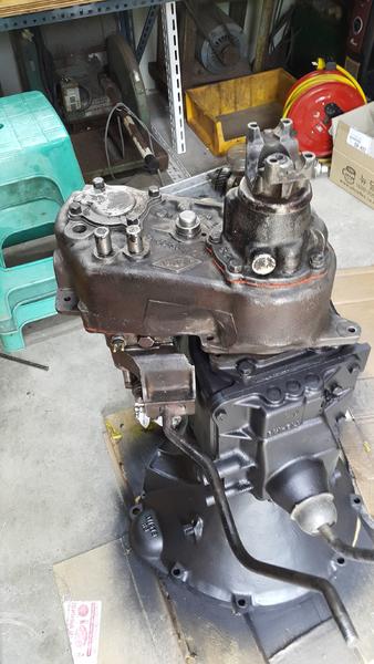

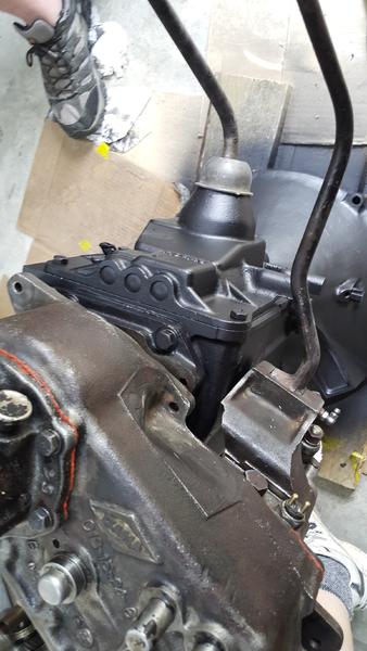

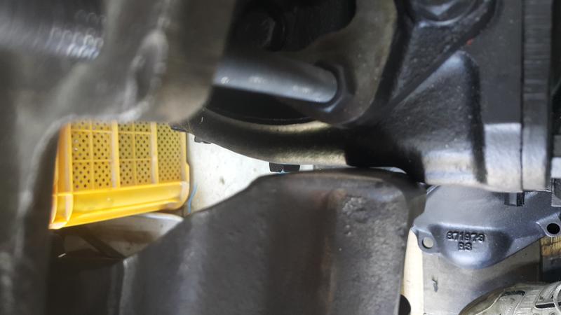

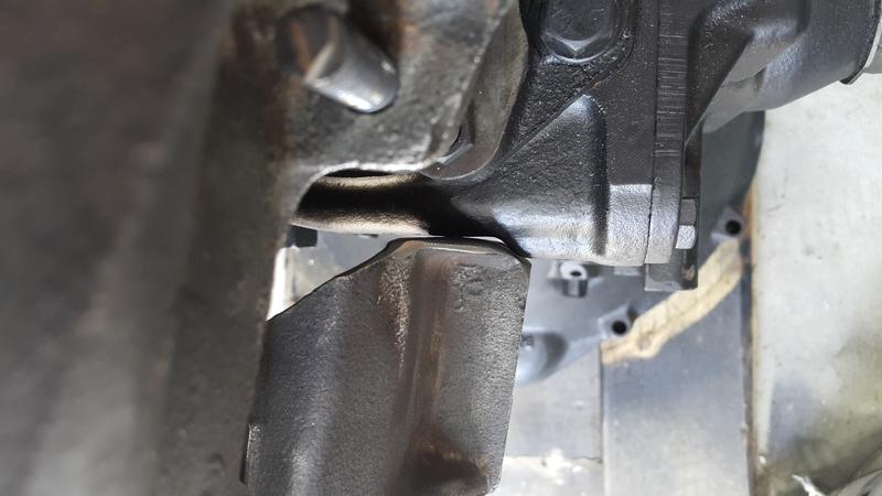

I tried a dry fit of my newly rebuilt Dana 20 to my newly rebuilt and painted t19. I wanted to be absolutely certain that the bull gear seated properly. I measure everything carefully but nothing beats reality.
Anyway I had the tranny standing on its bell housing to make it easier to paint and it seemed best position to dry fit.

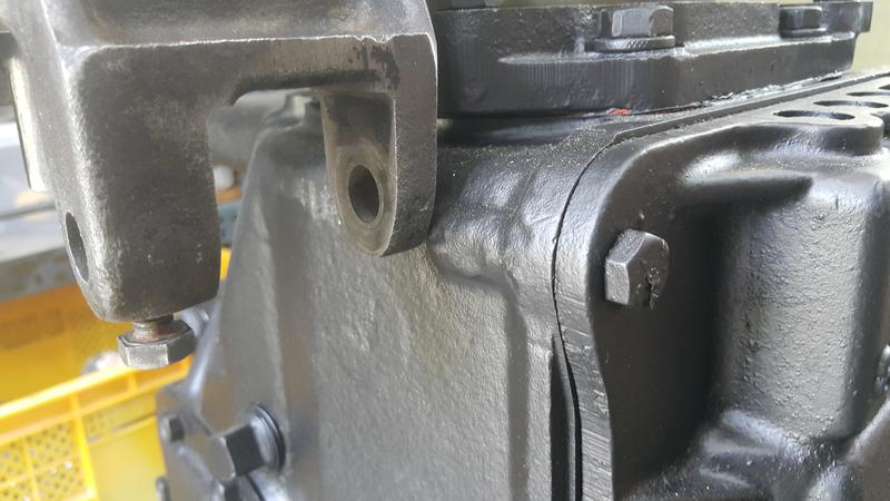

So here I am getting on my son's case about not paying attention and gosh darn it the shifter yoke interferes with the tranny body.
It is just one goddamn thing after another. If this job hadn't been so drawn out I might have installed the tranny and found this out under the truck!
So what is going on here? I measure the output shaft of the old t18 and the new t19 very carefully. I even measure the distance from back of the bull gear to the mating surface of the tranny and then compared thiis to the distance from the back of the counter shaft gear in the tcase to the mating surface and got an exact match. The bolt patterns are also the same.

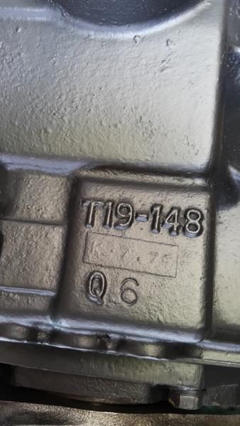

This is a wide ratio t19, the probability of being non Scout is very small, plus did the t19 housings vary over there manufacturing life?

So, there must be a factory mod to the Dana 20 yoke to accommodate the t19, no?

What's with that intermediate gear countershaft sticking out of the transfer case? Assuming that groove is for the o-ring, I've never seen one with a small nub for the locking tab like that before.
The counter shaft from this rebuild kit has two o-rings instead of one in the original shaft. The smaller bit on the end stays outside so it doesn't matter about the operation of the case. It is also of dimensions that it still picks up the locking plate
what's with that intermediate gear countershaft sticking out of the transfer case? Assuming that groove is for the o-ring, I've never seen one with a small nub for the locking tab like that before.

Looking at that rearmost boss where you have no clearance with the d20 transfer case front cover. There were some variations in the castings for the t19 cases, or at least that's been my experience. My first go-round with a t19/d20 was a boss in this same area (May have been more forward) and I had to grind it down so the d20 would clear the side of the t19 case. Oh, it's important to note that the t19 case was from a 2wd truck and I had to drill the missing holes on the rear of the case so that rear bearing t/c adaptor would mate up. It wasn't a situation of bad clocking, either. The case simply had some extra bumps on its side.

I asked an expert from another vendor and he said that they have not seen much variations in t19 bodies. In this case since it is a wide ratio it almost certainly was in a Scout.
It had a Dana 20 mated to it with a linkage I never saw before. I took it off so long ago and it is back in the us I don't remember what it looked like. I always assumed that the tranny and tcase were out of a Jeep. I didn't even realize that it was a t19 until I started rebuilding it!
Since the bell housing on it matches mine it would seem that it was n a Scout. However, the nose piece was significantly shorter.

looking at that rearmost boss where you have no clearance with the d20 transfer case front cover. There were some variations in the castings for the t19 cases, or at least that's been my experience. My first go-round with a t19/d20 was a boss in this same area (May have been more forward) and I had to grind it down so the d20 would clear the side of the t19 case. Oh, it's important to note that the t19 case was from a 2wd truck and I had to drill the missing holes on the rear of the case so that rear bearing t/c adaptor would mate up. It wasn't a situation of bad clocking, either. The case simply had some extra bumps on its side.
