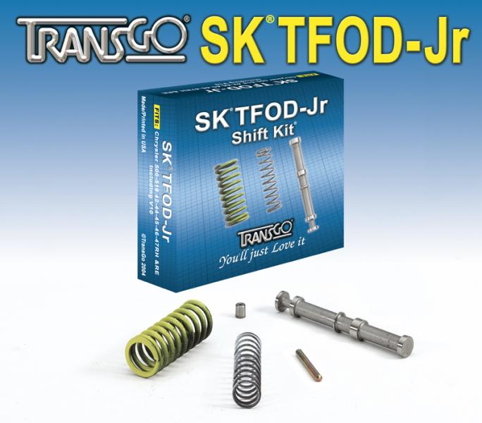

This trans has less than 1500 miles on it. Has a rebuilt sax-r14 converter, k225d-r rebuild kit, k22908b transgo noyoyo tf6/t-n and bushing kit k22902. Kind of a bummer that I asked for a tf-2 kit and now find it is some other number.

little searching on the trango site shows the kit # k22908-b is crossreffed with transgo sk tfod-jr ( tfod-jr t22176 t22167 k22908nd k22908b k22946g 5005170an k22908njr)

sk®tfod-jr is for the following
88-07 tfod
42,42,44,46,47,48
re & rh
500,518,618
corrects/prevents/reduces: lube shortage;
soft shifts; kills engine in reverse; drainback.
Fits models with/without electronic governor system.
http://www.transgo.com/sk_dodge.php
In my opinion, you have a torque converter issue going on. Was it replaced or not?
The transgo "no yo-yo" kit is pretty much a waste in my opinion, I'd never use that for anything.
A tf-2 kit (completely different system) can be installed without modifying the 1-2 governor valve and installing the shift plate. It makes no difference in the overall action of the trans, it just means that if that modification is performed, it will shift into 1st gear at any road speed in manual shift mode.

I seem to be in another situation where if you don't do it yourself someone else will take a shortcut and well you have seen the results. It's my fault for not scurtinizing the bill for the trans work. I specifically said tf2. And unless the paperwork is wrong they put in the wrong shift kit. The k22908b shiftkit I paid for was $39.54 list.

I would hazard a guess that the kit I have did not require any of the mods in your tf2 thread. I would assume the evidence is behind the pan.
Attached is a pic of what I think I got instead of tf2.
Oh well back to the drawing board I guess. It's looking like two issues now bad rebuilt converter and not getting what I asked for.

Still scratching my head about the transgo sk tfod-jr that I was billed for though. Seems like the wrong application but my trans seems to behave ok.
