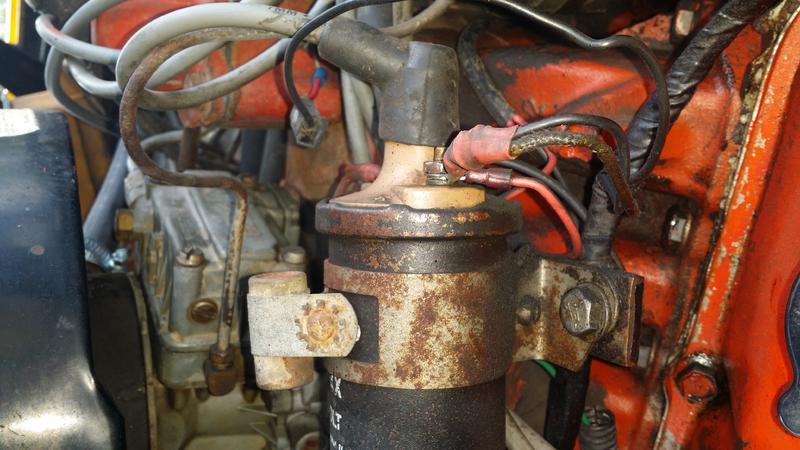

Please explain what you mean by "extension wires added to the ignition". Are we talking spliced pieces? For what reason? Where do they terminate? I see a red flag warning here.

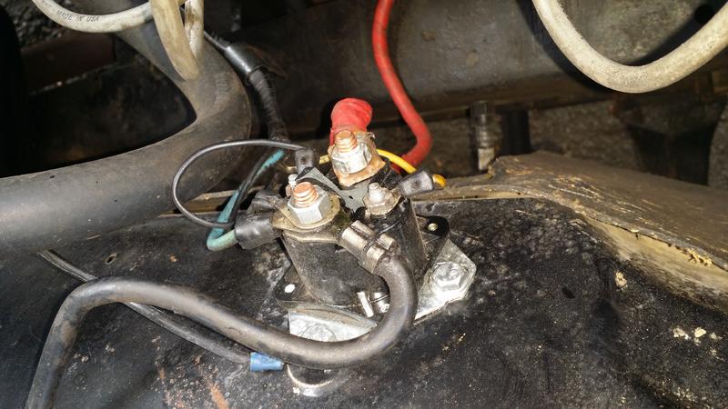

You didn't move the solenoid. Its still mounted to the starter motor, doing its thang. What you did was add a remote relay on the firewall and then relocated the small gauge wires that were formerly attached to your solenoid, up to the remote relay. Very common modification.

You replaced the points with a p-tron. Fine. What about the resistor wire that supplies switched power to your coil? Is it still there? Can you tell the difference between a resistor wire and a typical automotive wire? I'm just wanting to know precisely what you have hooked to the positive terminal of your coil. Your truck originally had a resistor wire there, which was needed for the breaker points. Now that the points are gone, the resistor wire should also be gone, having been replaced by a normal wire. Its a housekeeping thing.

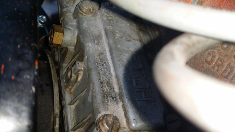

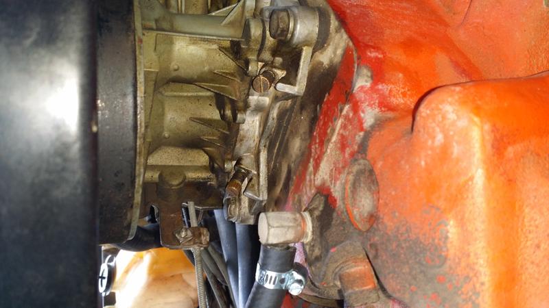

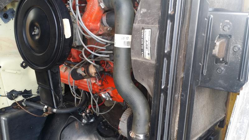

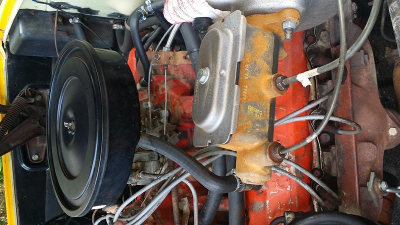

thanks for the pics. They really do help. The carb is a Holley model 2300 (2bbl) with side hung float. Could well be original. Its the correct design for the model year of the truck. In the pic of the coil, I can see that the factory resistor wire is still hooked to the positive terminal. It is easy to id as it is the rather oddly insulated, ugly duckling. I assume the red wire hooked there is for the p-tron module. I wonder about the black wire that is bundled into a common terminal with the ugly resistor wire. What's that one? Can you trace it out and id? I suspect it is the black wire hooked to your remote relay 'I' terminal. If you can confirm that, you can then remove it or leave it disconnected at both ends. It isn't needed with the p-tron in place.
Now back to that resistor wire. Your p-tron likes full voltage to the coil, but that resistor wire is supplying a reduced voltage. The reduction is needed for points, but since you no longer have points, you don't need the reduction. I suggest you replace the entire length of that resistor wire with an appropriate length of standard awg 14-16 gauge wire. By appropriate length, I mean long enough to make the run. The resistor wire originates at your firewall bulkhead connector and it is much longer than it would physically need to be to make the run. That extra length is what establishes the needed resistance for the points. You don't have to worry about that now. Just get it out of there. This won't magically solve all your troubles, but it should be done as part of keeping your electrical house in order.
Speaking of that, as you're discovering, loose and/or corroded terminals and connections between your battery and basically everywhere else are best avoided. They can be a major source of a vast array of electrical issues. Check them often and make improvements as needed.

Are you saying the extended wires are at the ignition switch in the dash? Those are the critical descriptor words I'm seeking.

The wires are extended behind the ignition key switch at the dash.

Hi, there does not appear to be an insulating base gasket under the carb. That can cause the feul to boil in the carb. Just to confirm, when it "looses power and smells", does the engine loose rpm's, or does the vehicle just slow down? If the latter, the clutch cuuld be slipping. How much free play is there in the pedal?

So does this engine have a clutch on the cooling fan and is there a fan shroud in place? Have you ever flushed out the cooling system?

If your fan has a clutch, it will be a noticeable device just ahead of the radiator core. You can do a google image search of a fan clutch to get an idea of what they look like out of the engine bay. Another way to tell is if you can turn the fan blade by hand when the engine is off. If you can, then you either have a clutch, or your drive belt is way too loose!

random stuff is a bitch to figure out, but stick with it, you'll get it. Just to confirm, is there an insulating base gasket under the carb? There will be a big tab that goes under the float bowl to keep the gas in the bowl from getting heated by the manifold. It will look like this
iheng-gask-crb-2bbl.html
Buy one here if needed: http://www.IHPartsAmerica.com/store/iheng-gask-crb-2bbl.html
