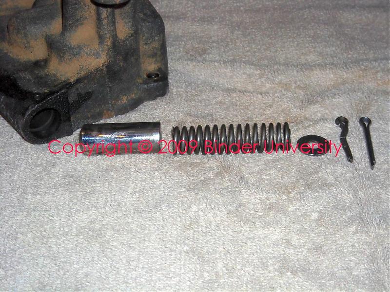

Here's the "shimming" detail for an ihc-produced oil pump pressure regulator for either a I-4 version, a fullsize version, or a Scout II version. While the details in the oil pump castings differ, the actual gears and shaft included in an oil pump service kit are identical for all versions. The actual "shim gaskets" included in a pump kit differ also in shape since the bodies differ, but the various thicknesses of the gaskets are consistent, those are used in a selective fit mode to set the end clearance of the pump gears when re-assembling the pump.
Simply remove and discard the cotter pin that retains the pressure regulator spring shim, spring, and spool valve. Clean these parts carefully, and also clean the oil pump pressure regulator valve bore before moving on!
The cotter pin is nothing special...just a standard cotter pin! Don't be surprised to find a finish nail, or a chunk of bobwire stuck in that hole, after all this is IH schnizz and typical tightazz IH folks will use anything to not spend a nickel for a cotter pin! No toothpicks though!!!
Notice the chamfer on the spool valve goes into the pump body bore first, do not reinstall the spool backazzwards!

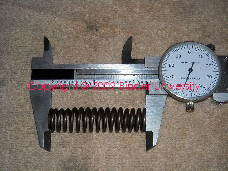

Check the free length of the pressure regulator spring to determine if it's within specification. This one comes in at 2.256". Robert already trained us that the spec for the free length is 2.250"...perfectly within spec.
If the spring was somewhat under the spec in free length, then that indicates it's "collapsed" over time and the shimming data he extrapolated will be skewed.

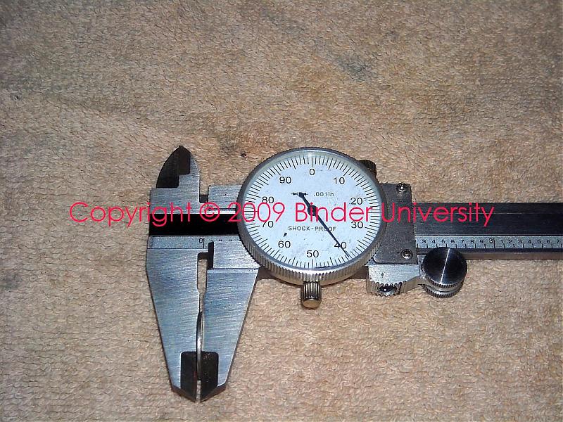

The washer in this sii pump has a nominal thickness of 0.040".
The od of the washer is 0.680"...basically a 1/4" grade 8 sae flat washer!

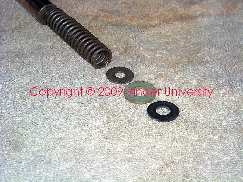

Whatcha see here is two "ideas" I use sumtime. The darker item is a metric 8mm plain old flat washer (black oxide finish), the lighter item is plain old 1/4" sae flat washer. Either of those will have to have the od reduced onna grinder until they fit inside the bore of the pump in a kinda "sloppy" fashion.
Actually...if yore gonna make a shopping excursion for some washers, then look for a 7mm flat washer, those are kinda unusual but used in many applications, I find stuff like that in the hardware assortments at the local farm supply or even them bigbox home supply operations. A 7mm flat should be just right in od and ya might wanna use two of 'em depending upon actual thickness..always take calipers when ya go shoppin'! Looks real trick stuck in yore pocket protectors.
