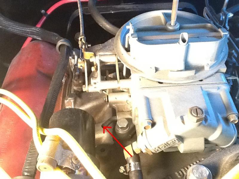

72 with 304 727 auto mostly stock....ok so I have a few question for you Scout all'knowers cuz im still learning my rig. I got my Scout in pieces so I never had the luxury of seeing how it was put together.

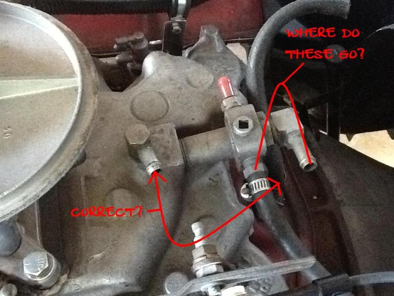

1.vacuum line connections? I took some pics hopefully it helps you understand what im in need of, im not sure where they need to connect to?

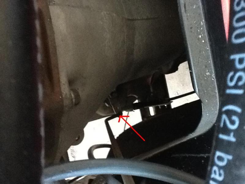

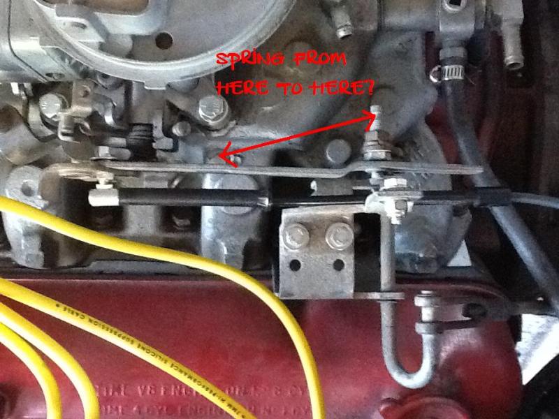

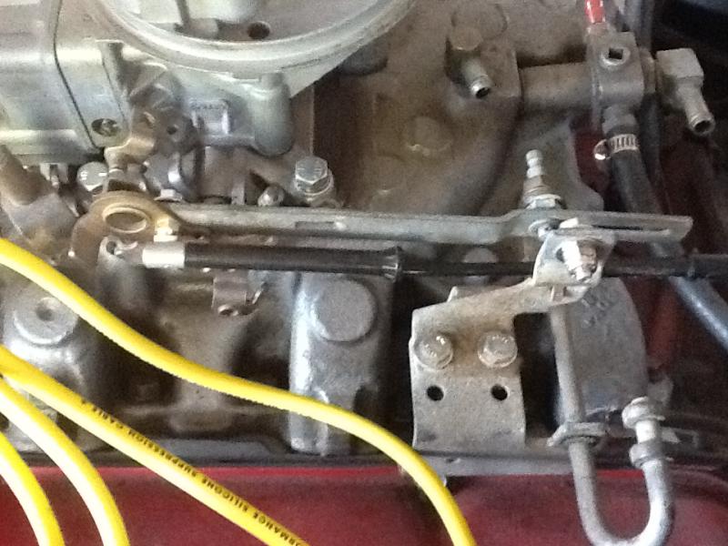

2. Kickdown linkage? Pics included, have I installed the linkage correctly? Also the rod that goes down to the arm on the trans has tension on it pushing back already,does it need to be adjusted so the arm is all the way forward with any or no tension at this point?

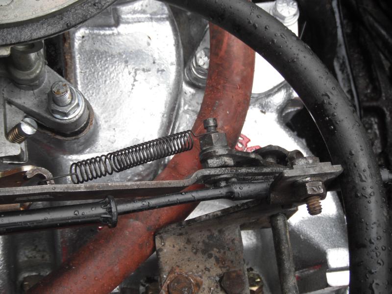

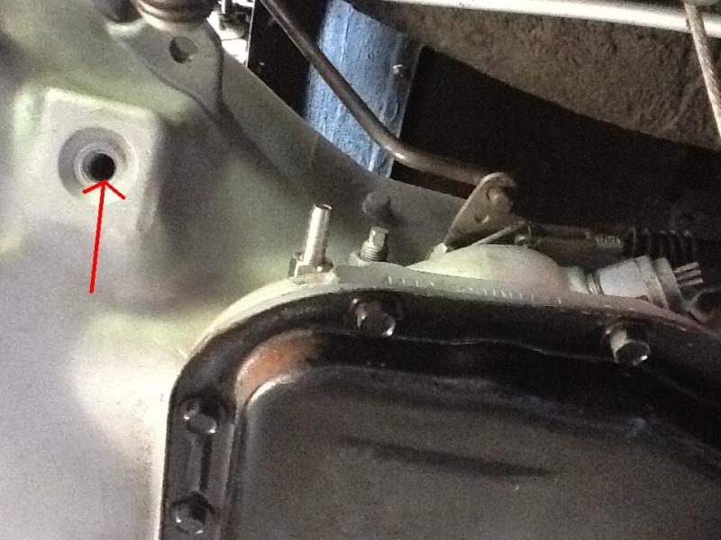

3. Trans? Pic included, there is a port on the bottom front drivers side of the case that has a threaded port, what is that for? Does it need to be capped?

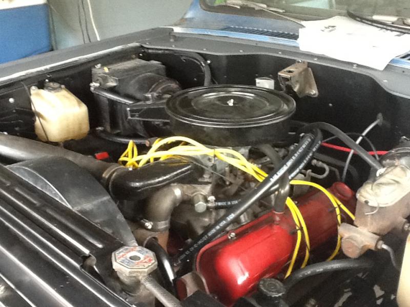

Never had a Scout with a slushbox so I can't help there. On the vacuum lines, the hose sticking up in the air (pcv) needs to go to the big fitting that is screwed into the manifold in front of the pipe.

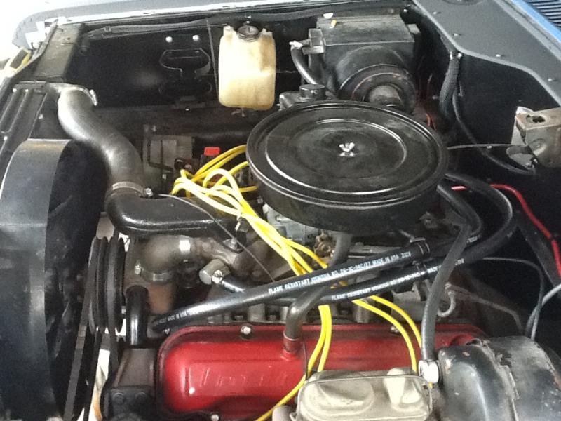

Isuue #1 (vacuum) as seen in pic 6, this location appears to be meant for your vac advance on the distributor. Is it just my eyes or does it look like there is a potential clearance issue between the linkage and the hose running to the pb booster as seen in pic 3?
Issue #2 (linkage) as seen in pics 1 & 2...the slotted bar linking throttle to kickdown pivot assy needs a short, small diameter, light tension spring connected to the bar's hook tang on one end, and the small shaft with machined groove on the other. Once that is in place, the initial kd rod adjustment at wot should have the kd linkage nearly at max rear travel. You can test drive and dial in your shift points with minor adjustments to the clevis fitting from there as needed.
Issue #3 (trans) as depicted in pic 8...this is for securing the tf 727 to the trans cross member in d-series pick-alls. Just like the engine block casts, the auto trans cases were cast with multiple bosses to fit in a variety of platforms with different mounting points. It is n/a to your Scout and can be ignored.
Yes to the spring question. The hose that is loose on one end running to the pcv valve in your valley pan would attach to the port just behind your carb. Then cap off the other vacant, large port.
Ok...the other hose, the other port with a hose and clamp attached next to the vacant port is for the brake booster right? Ya I have not gotten around to getting a throttle return spring yet...
Thank you Danny. So I got em all figured out the extra port that had a hose attached on the back of the manifold was for the cruise control gizmo which I deleted so if anyone needs that assembly I have all of it including the speedo cables. Oh I do have a final question the port coming out of the passenger side carb goes to the dist port?

...oh I do have a final question the port coming out of the passenger side carb goes to the dist port?
If that is the only ported source, then yes. I couldn't see an alternate source in the pics provided, so that is likely the only one. You can use manifold vacuum for the vacuum advance too. Generally, vehicles of this era use a ported source, but that is an emissions thing. Just so long as you have vacuum plumbed to the vacuum advance. Manifold vacuum is sourced directly from the intake manifold. Ported vacuum is somewhat regulated through ports inside the throttle body. Did I just cornfyooze the hell out of you?
Hahaha ya u did but I think im getting it...? How about the ports under the air breather, one of those is for the vacuum advance on the dist? The port coming out of the carb lower pass side is for the evap canister (emissions nonsense)?the port for on top of air filter housing is for warm up? Am I asking dumb questions:confused: pics are always helpfull im a visual person
Sorry for that. No not dumb questions at all. The ports attached to the air filter canister are not vacuum sources. They are part of the original hot air choke assist system. I believe at least one of the ports on the canister is used to control a baffle on the fresh air intake snorkel. There was also a small diameter dryer vent style hose running from the top of the passenger exhaust manifold to the bottom of the filter canister. A vacuum line would have run from a vacuum tree on the passenger side of your intake manifold that has a temp sensor on it which penetrates a coolant passage in the intake. During cold start, the baffle would close off fresh air supply allowing warmer air from the exhaust manifold to be sucked into the combustion chamber through the carb. As the coolant heated up from the engine running, vacuum supplied through the tree would be affected in such away as to reverse the baffle direction gradually allowing fresh air to then enter. At the same time, a bi-metal spring in the heat riser which had been blocking exhaust gasses from exiting the tail pipe is also heating up, opening the baffle to allow the gasses to then exit. Its all a bunch of complex mumbo-jumbo that was derived in response to emissions requirements of the day, which made these engines run very poorly when cold, without these "heroic" measures. You don't really need to worry about all that, since you are now running an aftermarket carb which has its own self-contained, simple and effective choke control.
Ah ha... That makes sense to me! Thanks again for your quick responses ... Im sure I'll have more questions but for now ive got some work to do.
