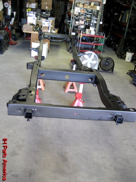

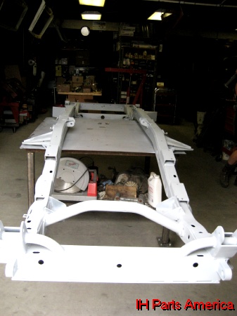

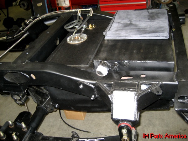

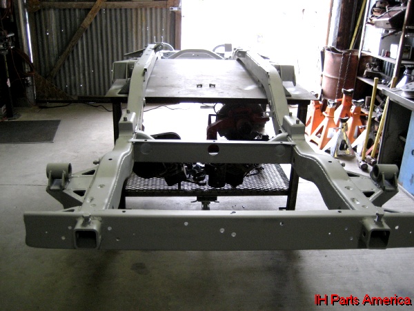

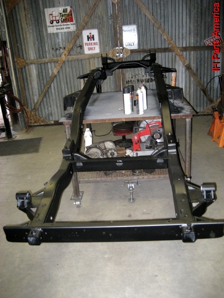

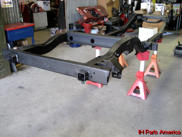

LD`s Custom Scout II

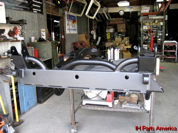

The frame was sanded, primed, and then painted semi-gloss black.

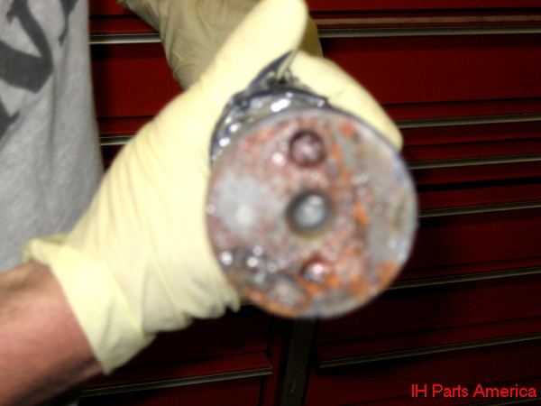

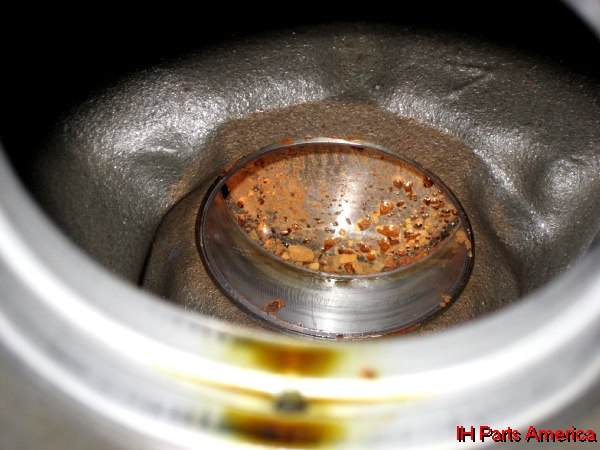

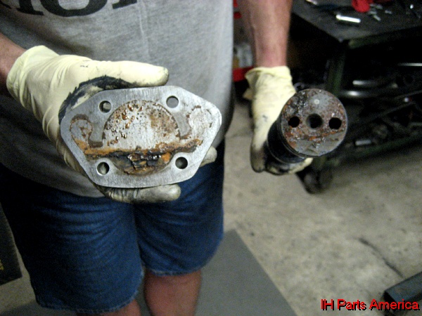

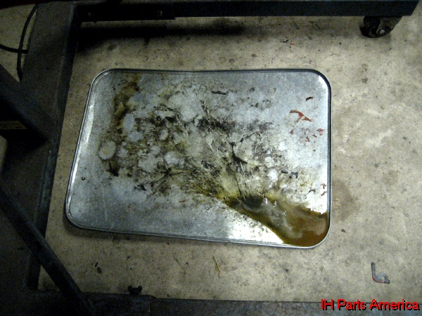

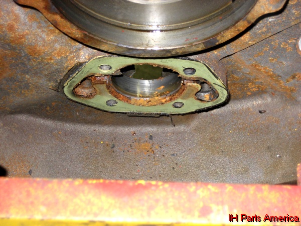

We tore the engine down the rest of the way in order to swap the camshaft in, have the rotating assembly rebalanced, and overall inspect it since we didn't build this engine. We sent the rotating assembly off to the machine shop for balancing and the cylinder heads for inspection. Good thing we did because the connecting rods were no good and needed replacement, the valve springs were weak so those were replaced, and a 3 angle valve job was performed since several of the valves were leaking. Both rocker arm assemblies were also replaced as they were only cleaned up and reinstalled but were clearly worn out. And after finding the rust formation behind the cam plate of this brand new engine only then did we know that this engine would not have lasted long at all.
attachment.php
attachment.php
attachment.php
attachment.php
Amazing how much dirt came out of this "ready to run" engine(that was a clean tray when we started).

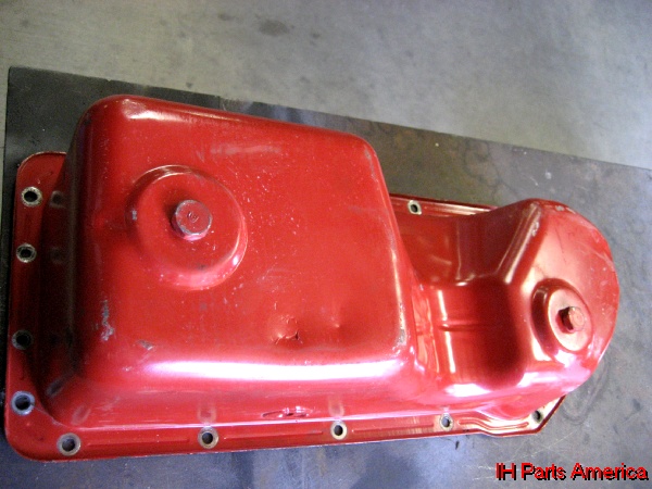

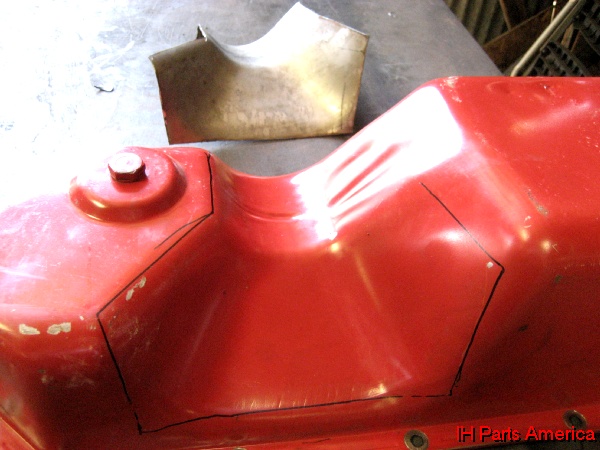

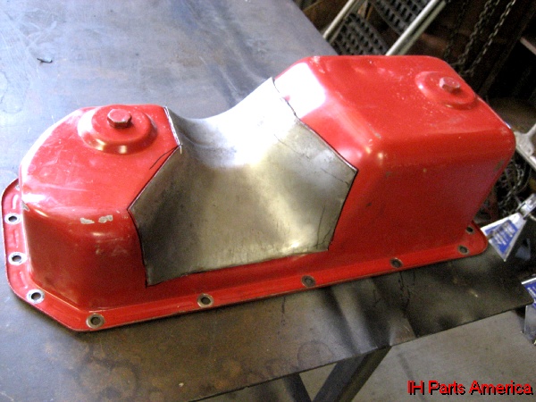

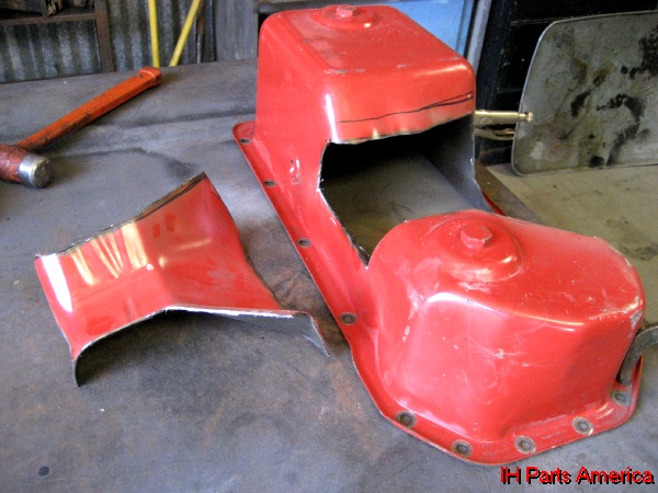

We modified the oil pan by removing the 'hump' from the pan. This allows for extra capacity and makes for a better oil supply to the oil pick-up assembly.

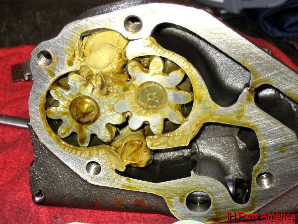

Looks like 'baby poo' in this oil pump???? Not sure who previously rebuilt this engine but I wouldn't let them touch my briggs&stratton lawn mower engine.

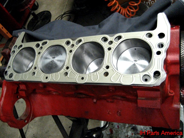

Finally the bottom end was reassembled. We used nos factory steel head gaskets to help with engine compression.

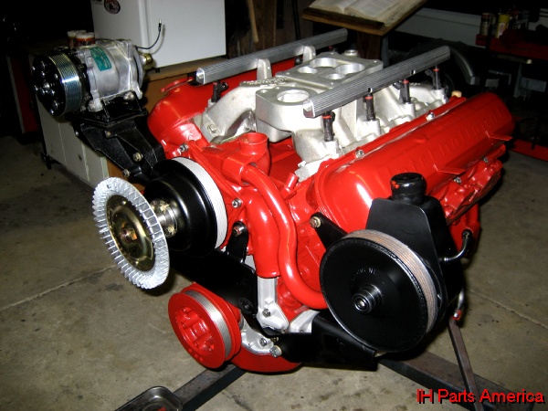

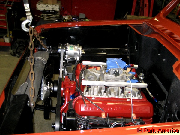

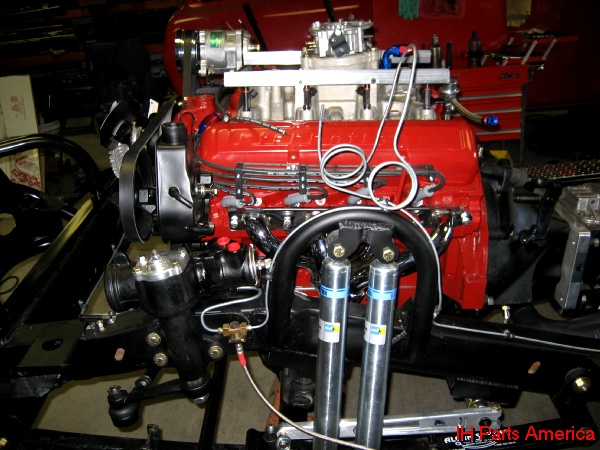

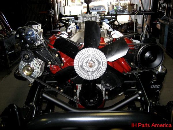

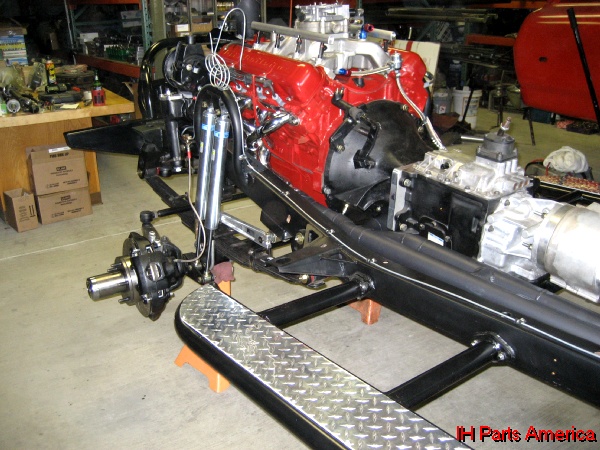

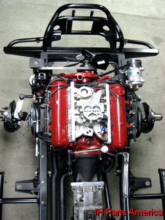

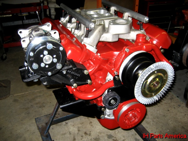

With the engine all buttoned up we started bolting on the accessories.
attachment.php
attachment.php

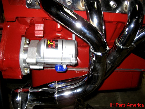

This hi-torque starter Should crank this engine over just fine.
attachment.php

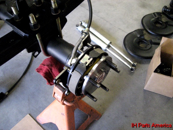

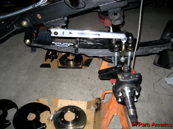

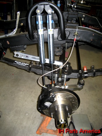

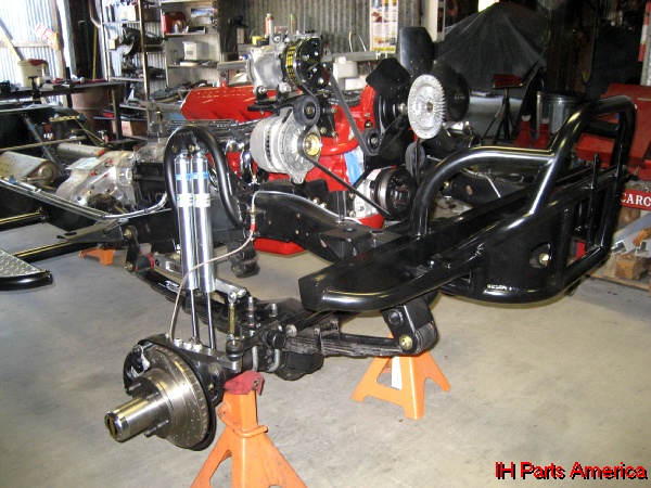

The front shocks arrived so we bolted those on.
attachment.php

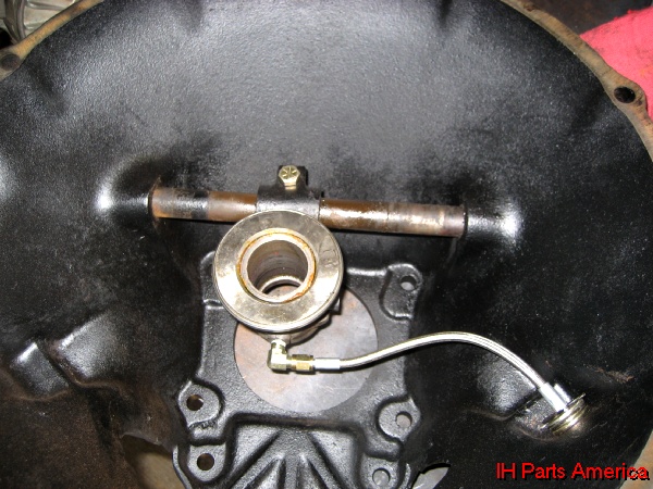

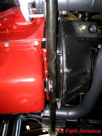

Since the throw-out bearing will not be easily serviceable we installed a hose to the outside of the bellhousing so that the bearing can get greased with ease.
attachment.php

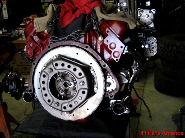

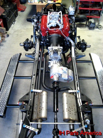

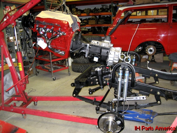

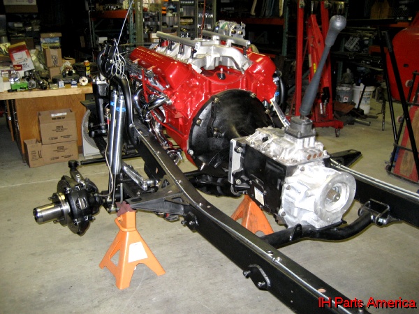

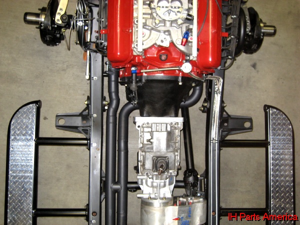

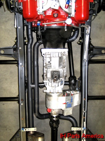

We installed the clutch, bellhousing, and slid on the transmission and then dropped the assembly onto the frame.
attachment.php
attachment.php
attachment.php

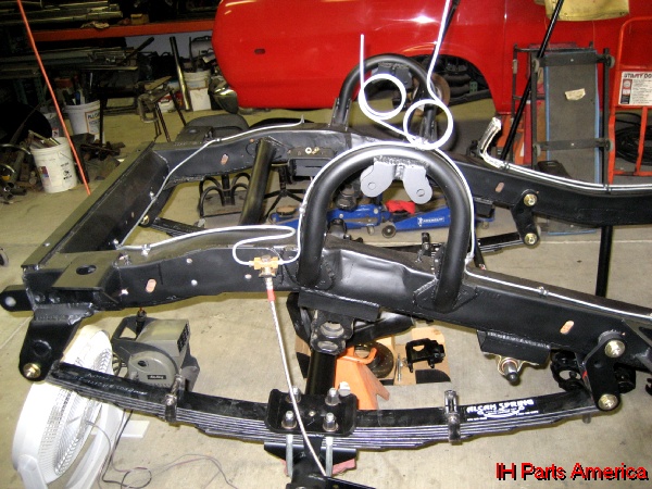

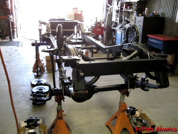

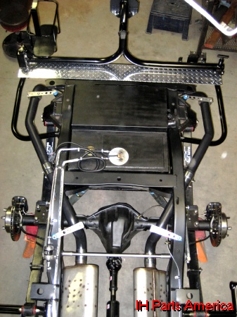

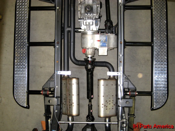

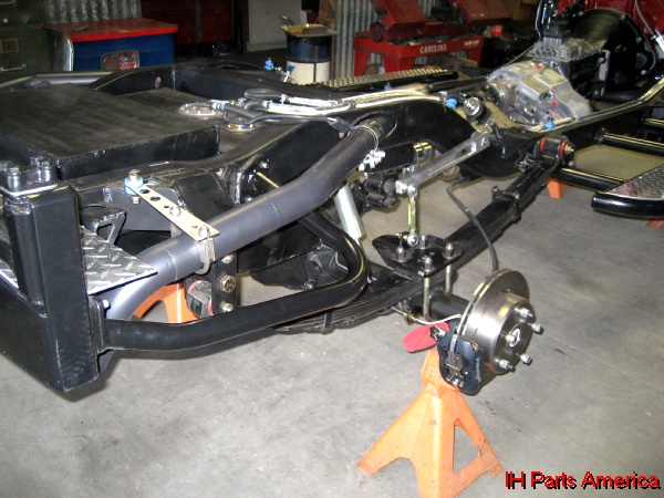

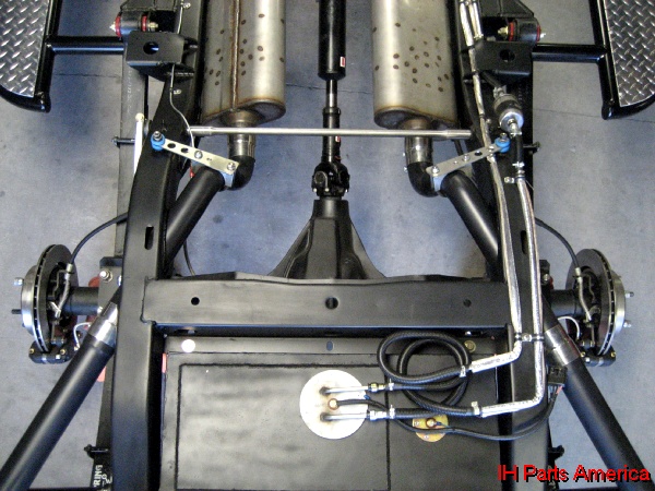

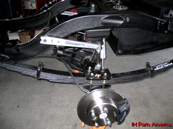

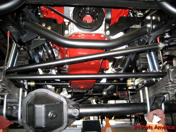

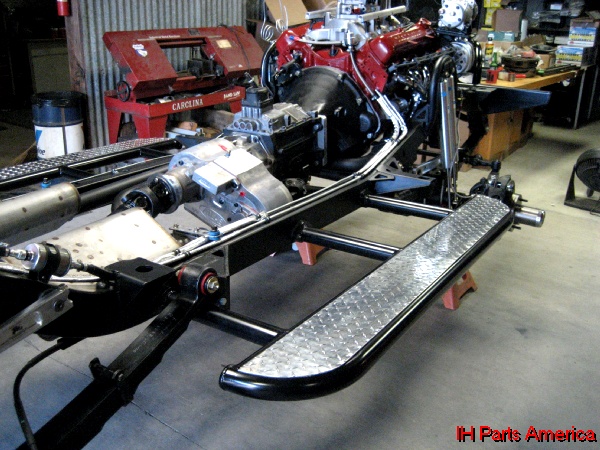

After installing the atlas transfer case, drivelines, and ceramic coated exhaust we were finally ready to bolt down the body. Pics of the chassis pretty much done and ready for the body to be bolted down.

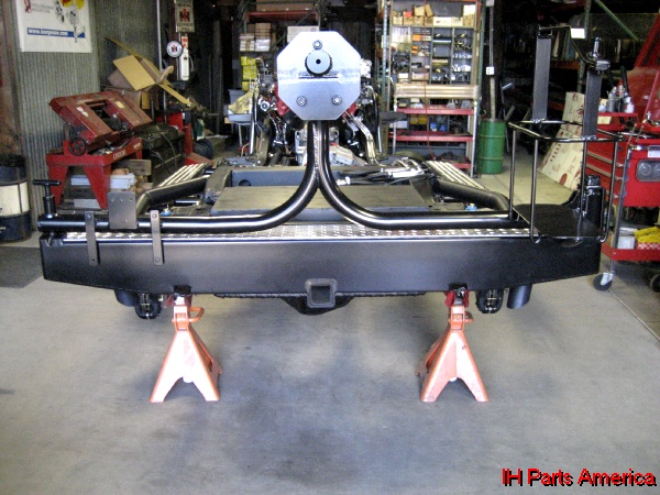

A few more shots of the chassis.

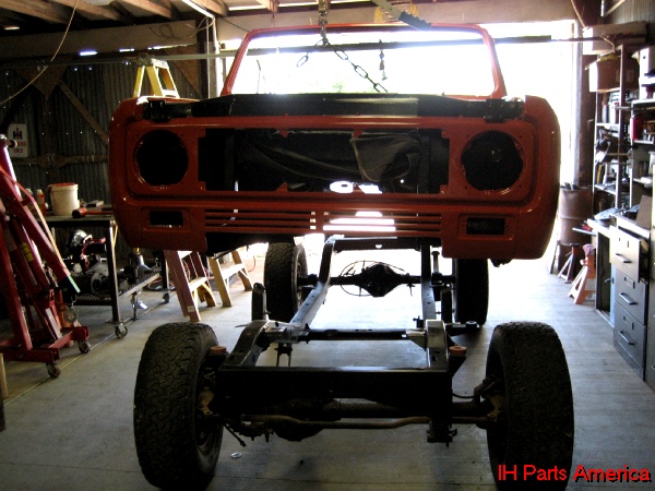

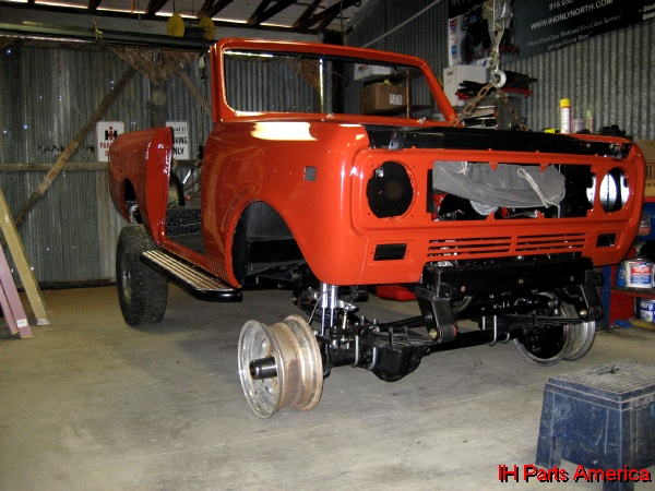

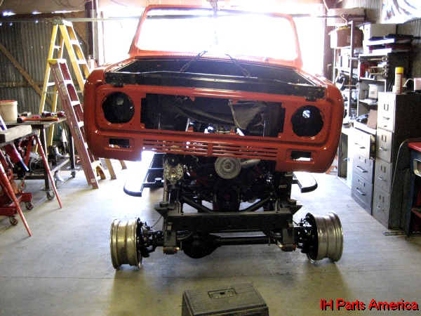

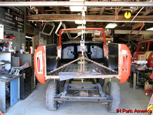

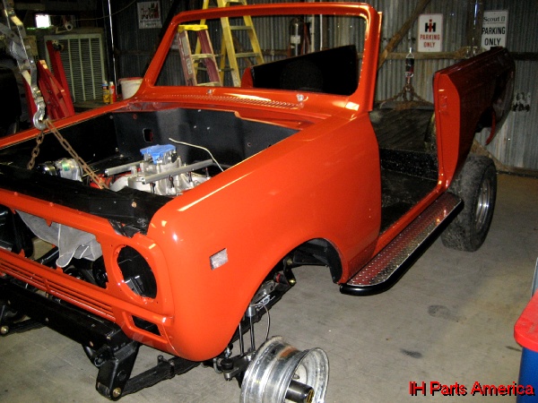

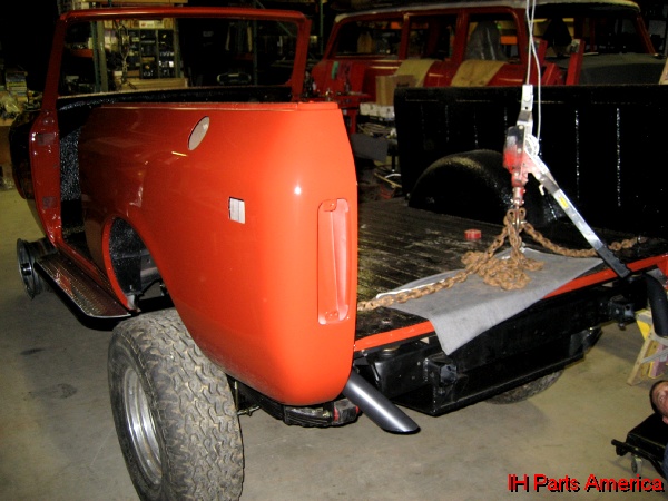

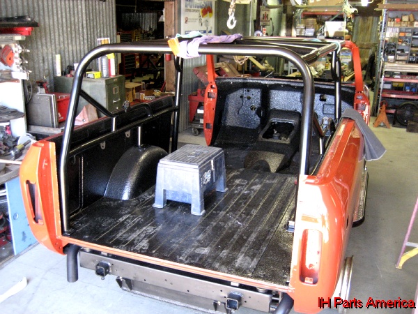

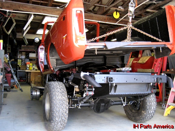

We dropped the body down onto the chassis for the final time.
attachment.php

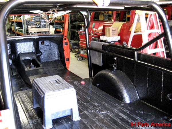

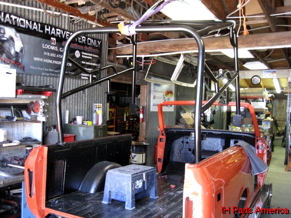

And then dropped in the roll cage.
