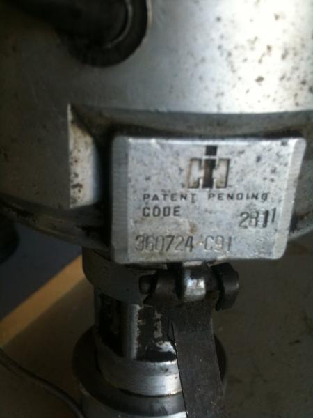

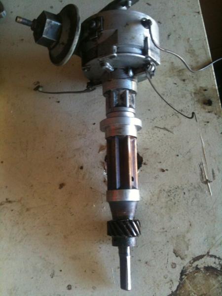

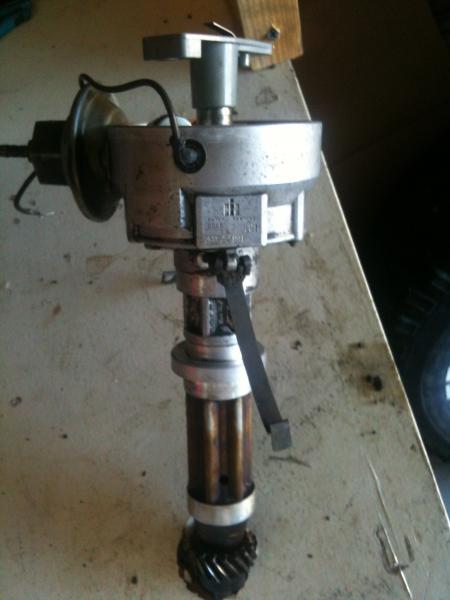

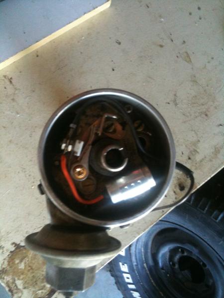

Distributer id and diaphram avaibility. Here are some pics of my distri.that came out of my,
1970 Scout
196ci.
4 banger
85 k miles
4-wheel drive
4 speed, borg waner t-18
Dana 44 rear, Dana 27 front
IH distri.single point (?) gas
1904 single Holley
the # on the distri. Is 360724-c91
vacuum advance is 677-5 and it is frozen and won't move.
I am hoping that someone b4 me installed these stright points, when they should of installed "curved" points instead??

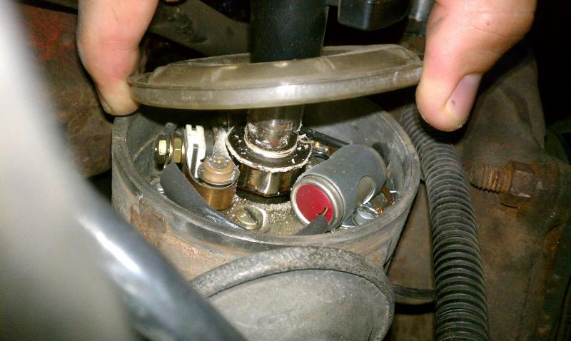

I've went through this entire post and narrowed my distributor down to a Holley points. But I still don't understand the difference between "straight point" and "curved point", and need this info as it looks like IHPA only has pertronix kits for the curved point distributors.
Can anyone tell what I have from this pic?
Also, it looks like some corrosion junk in there. I imagine this is not a good thing? I've owned this truck for a year now; it's worked great, but I've never once messed with the distributor.
Thanks guys.

Take the rotor button off an take a pic of the points from above,cant tell if they're curved or straight ? Imagine they're curved,Jeff
Those are curved points. The fastening holes curve around the cam. The fastening holes on a straight point set don't curve around the cam...because they're straight.
Thanks guys.
That 'corrosion' could be the remains of the nylon rubbing block of the points set. Will happen if there is no 'lube' applied to the rubbing block when installed.
Good input!
Looks like I will be ordering the pertronix kit for curved points Holley then.
Just so I know, is there anything else I should be ordering with the pertronix kit to do the job right? (with these projects, everything seems so simple at first, but there seem to be lots of hidden gotchas with compatibilities, etc. For all I know, once I switch to pertronix, I May need a different coil, different plug wires, or whatever)
one last thing: there is an "ignitor II" option in the pertronix kits that is more expensive than the plain old ignitor. Anyone know the difference offhand?
There's a lot of threads about the p-tronix, good & bad... The pertronix 111 is in my opinion the best 1, if you leave the key on,it won;t burn it up ! But I really can't see the advantage of it over the stock e-module myself. ? Jeff

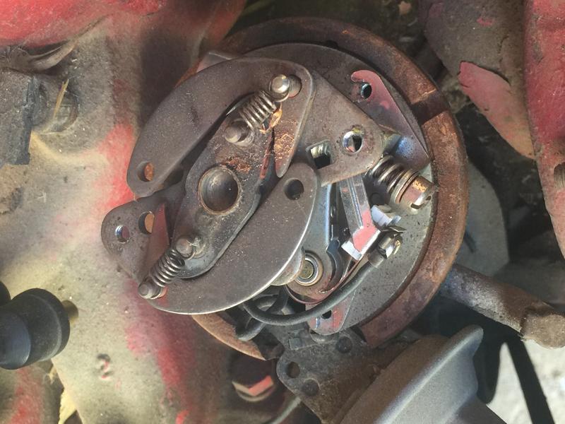

hey guys I've been going through the thread like the above mentioned guy with curved or straight points. I got a little ahead of myself and bought the curved p-tron set up. And it looks like I have the straight set up in the truck.
Can I modify the p-tron plate to fit? Or will I be putting in a p-tron unit that electrically won't work? Thanks!

Have you read through this whole thread and looked at the pictures to compare them to what yours looks like? It should be fairly straightforward.

1963 c1100 travelette 304v8
That is not a Holley distributor.
That is a Delco distributor.
I suggest you send your PerTronix unit back and order the correct PerTronix unit for your Delco.
