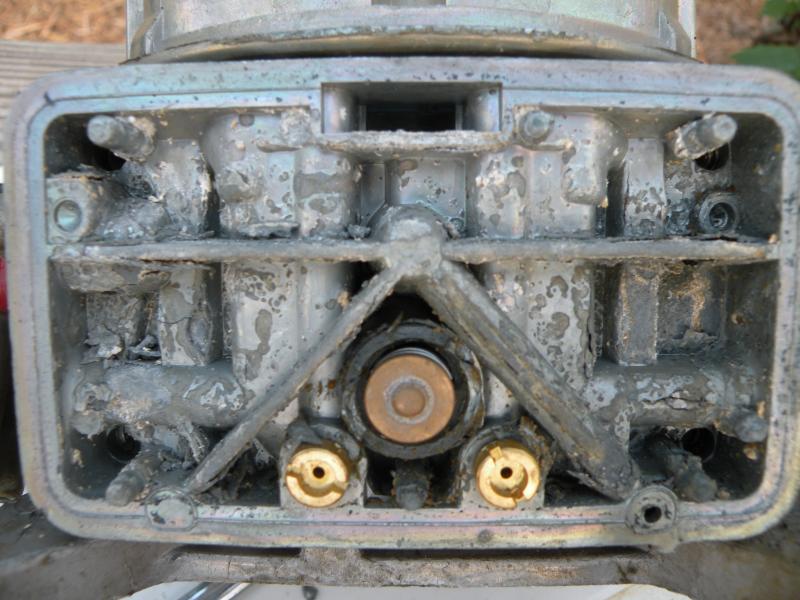

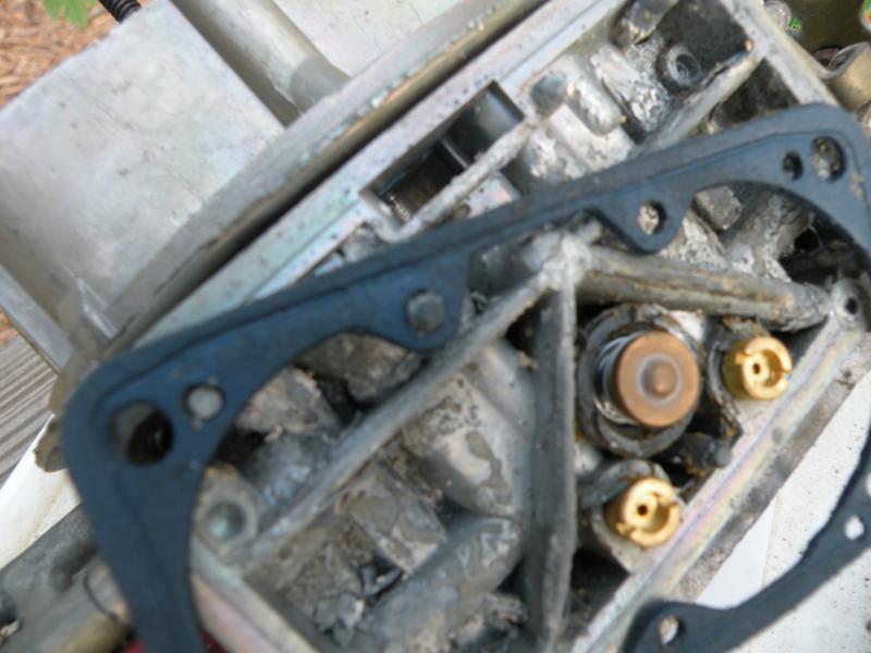

Metering block and bowl flaking metal! :incazzato:
I cracked my bowl from my metering block and crap fell out everywhere! It is metallic flakes, like a coating over the zinc casting. It is hard, not like a plastic coating. Have you ever seen anything like this?

Me an kim dun been talkin' about this pile tonite, but I thought..."it kain't be that bad"...wrong!!! This is an aftermarket replacement 2300 that mixes carbonsludge for feeding a built 345.
What the fook is that shit kim??? That metering block needs to go into isolation lockdown and hazmat called in before it starts breedin'! That is not at all what I thought it might be!
This is a Holley 2300 that kim bought off the 'net from a commercial carb supplier about a year ago. Worked ok in the beginning, but has slowly deteriorated over time. She's tryin' to find the paperwork and who the vendor was, but right now we don't have that info.
My initial thought is that the metering block was put through some kind of cleaning process, and then coated with something. Why a commercial carb remanner would do that I have no idea, new metering blocks are available from Holley, commercial carb builders would have no reason to mess with some workaround like this.
Kim also did an acid wash some time back of her sii fuel tank (terra), and then the por 15 tank treatment. My initial thoughts were that the e10 fuel has been attacking the tank coating, causing it to deteriorate. But I don't know the current status of e10 vs. Por 15 in both the short term and the long term.
I suggested to kim that she remove the core plugs in the metering block, and see if she can have it ultra-sonically cleaned at her workplace. Or, simply scrap it for a replacement. So she needs to gimme the Holley code off the top so I can determine if we have a replacement or where we can find one.
