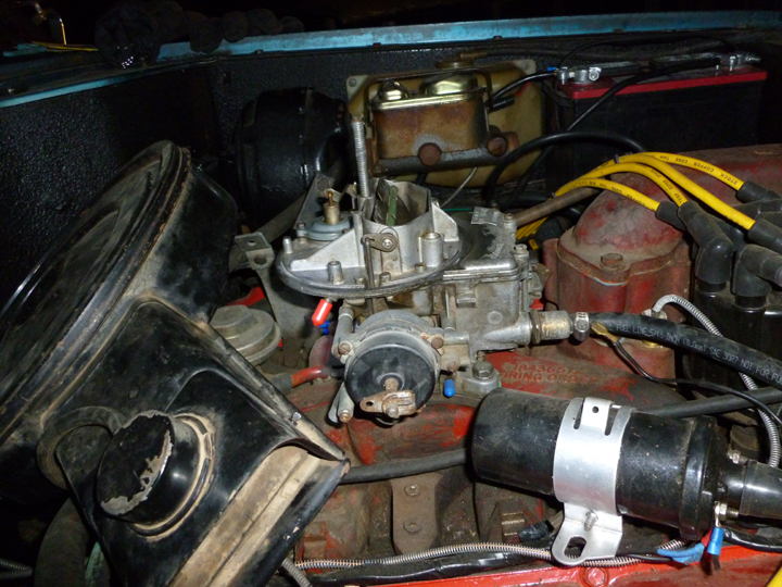

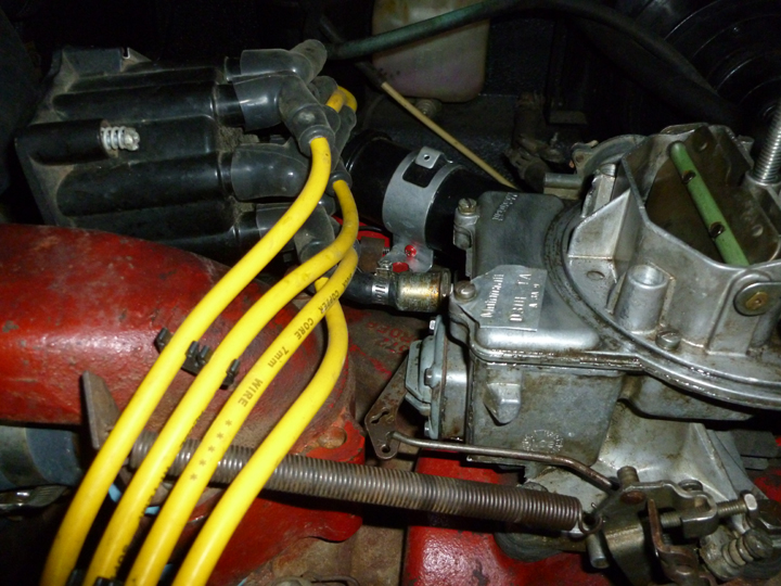

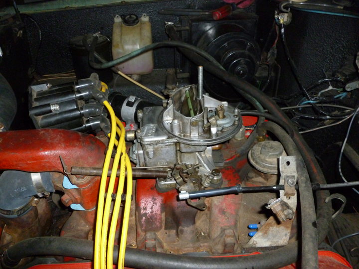

just got me a new Scout and I need to rebuild the carb. I didn't get numbers but I have attached three pics. The carb says Ford motorcraft on it so I May have a po virus here. I'm pretty sure that it's a 2300 though. Anyway, what rebuild kit do I need?
Thanks,
harry

Those carbs were a popular swap for a while. It should work fine with a rebuild. I have a 304 with the same carb, never ran it though.
