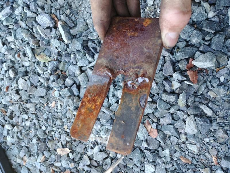

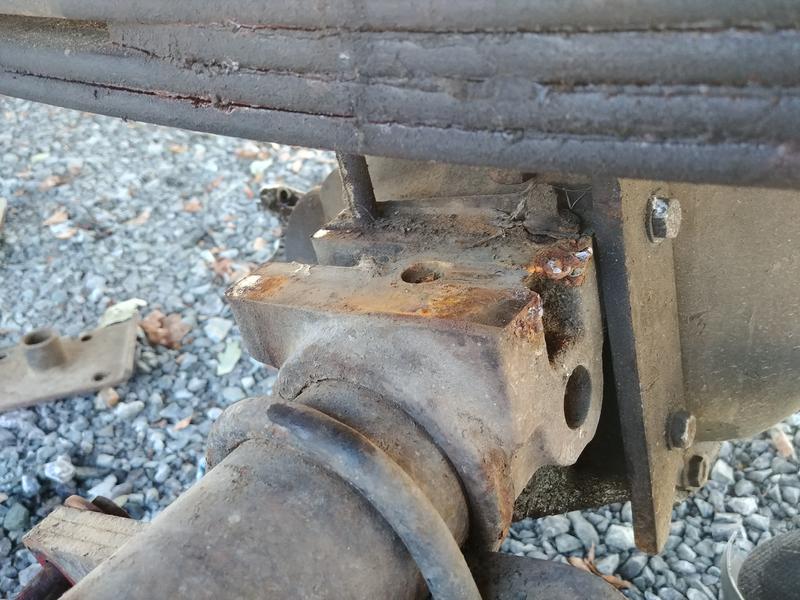

Those shims are set to remove castor. Remove the shims and replace worn parts and then take it to a good shop for an alignment.
I can try that, I would like to measure caster before I run it in 4wd. I heard but correct me of Im wrong, altering the pinion angle too far from the t-case out put can cause drive line problems. The shims are welded in, but it looks like whoever did it forgot their sheilding gas its so bad :lol: Nothing a hammer/chissel cant fix. Thanks

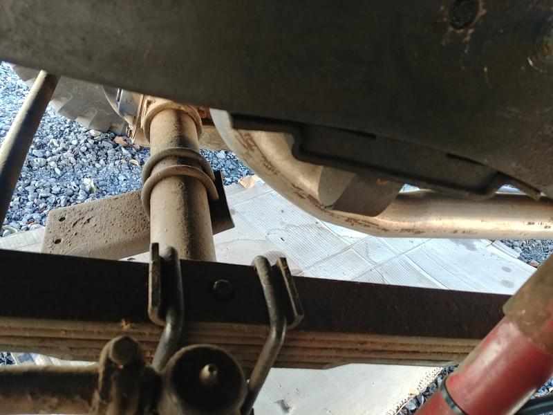

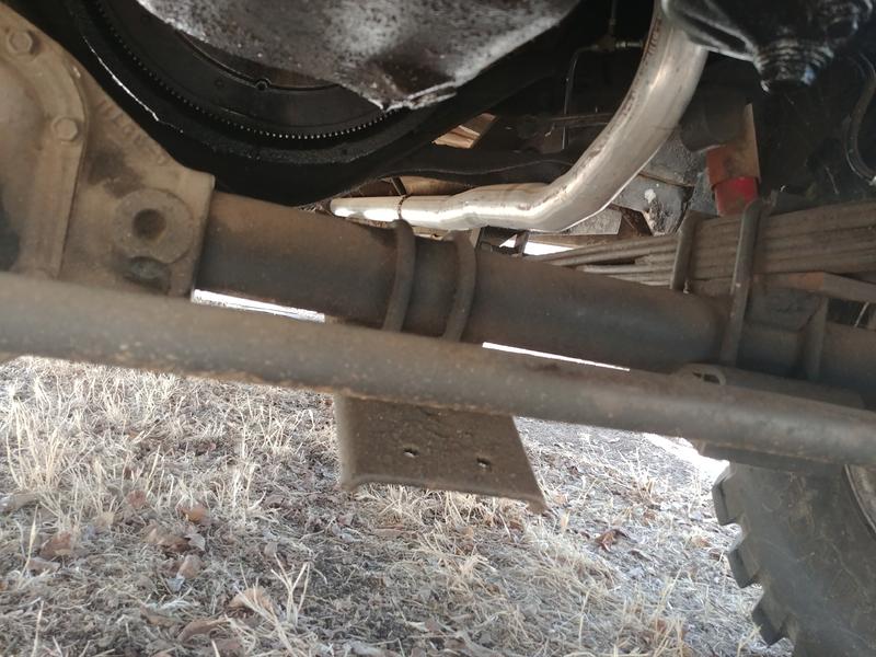

I second the wedge removal. Also want to say that the way your spring pack is assembled is bad bad bad. The leaf order needs to be returned to its original order. Basically you only have a 2 leaf spring pack that is controlling your axle wrap. You axle can wrap around either direction will little resistance.
A side steer setup like you see on the C series like yours, where the steering gear pushes forward and back, is remarkably predisposed to bump steer if the geometry is set up wrong. Minimize the angularity of your drag link, and maximize the wrap stiffness of your spring pack.

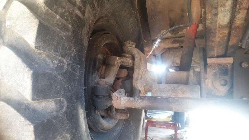

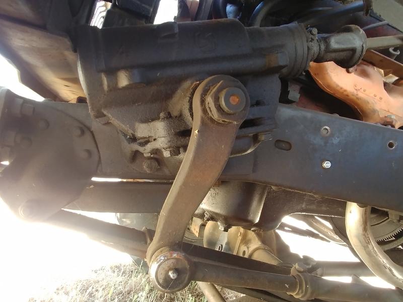

Hermmm..... Ya know I see what youre refering to about the springs..... And I'm wondering why that hasnt struck me as odd before. Are these springs consistent with my original HD c series springs? I was thinking about replacing the springs all the way around in the next couple years, theres helpers in back, maybe my mind thought thats what these were. I was told "the telephone company used it to rip poles out of the ground" no idea if thats true but it has options on the LST that imply it was going to be heavily used. Im not sure what axle wrap is but it doesnt sound good. In regards to the drag link, how can I increase room for my driver side tire? I cant steer fully right because the tire contacts the front joint of the drag link.... I think you can see what I'm refering to in this picture from the shiny spot at front joint.

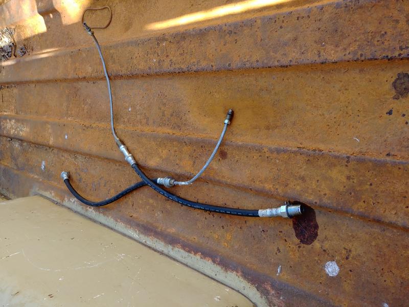

The right front brake line....Is that a section of hard line coming from the wheel and then connecting to rubber flex line? Tell me I'm wrong...please.

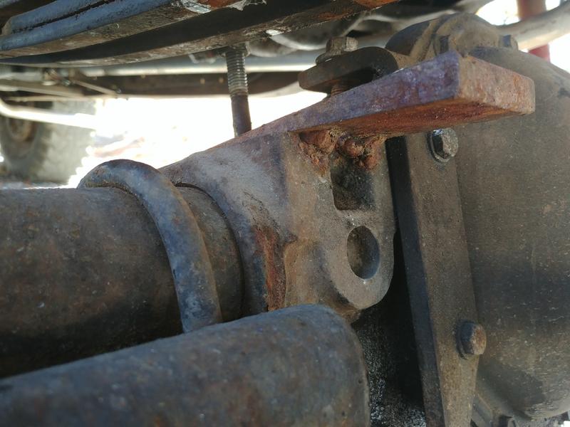

The caster shims want to angle the kingpin back towards the cab. The angle that messes with the front driveline has to be pretty severe to cause issues. I would definitely do what Robert suggests, and dial in those front springs, then flip the shims right way around and see how she drives. Improper toe-in will also cause squirrly handling, so give a good look at that with a tape measure before you go out on the road.
That brake line is an issue I'm ignoring in the hopes it will go away.... I paid a "profesional" to put new steel through the whole truck after my main line poped, and I figured a mechanic could do it faster than me.... You can read the whole story on my build thread...(it took him close to a year to complete) :mad2: :mad2: :mad2: Anyways, trucks getting a new radiator soon, Ill park it on my rv pad and put it on jackstands to do a bunch of stuff at once. I'll let you know how it goes, thanks for y'alls input. :icon_mrgreen: *edit: beware of "profesionals" he replaced 3 of my wheel cylinders and left one old one in to "save you some money". . . . . . on a $1400 bill :mad5:
Oh hell no! I'll bet that thing flexes and twists, jukes and jives, pops and locks and shimmies and shakes right down the road.

Those daft brake lines, have met their end.... More broken/worn out things to come this week, stay tuned. :winky:

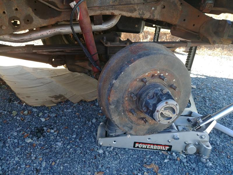

Spring packs are done, pulled the wedges, then dug into this, let me know your thoughts on it. A permanent fix will have to wait, I need it back together by tomorow.

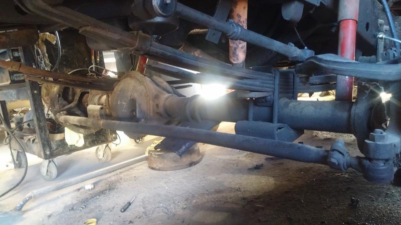

Another odd thing I noticed, the diference between the bump stops(see pics) and also with the springs hanging, distance between top of the top leaf and the bottom of the frame is aprox 1" bigger passenger side vs driver side. In another note, the shocks in front arent long enough, I had to lift the axle and compres the spring slightly to unbolt it. I have measurements for new shocks, around 23" open, roughly guesstimating 13" closed. Any good ones out there? I can get slightly used Billsteins out of an army suplus ware house for $30 per unit, but Im not 100% on if they will have the size I need.

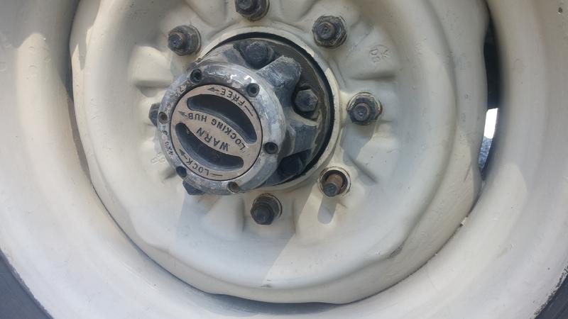

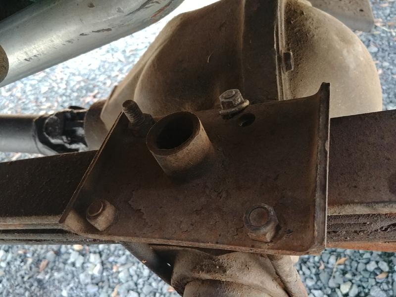

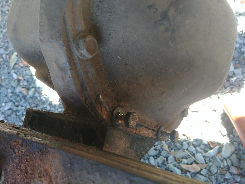

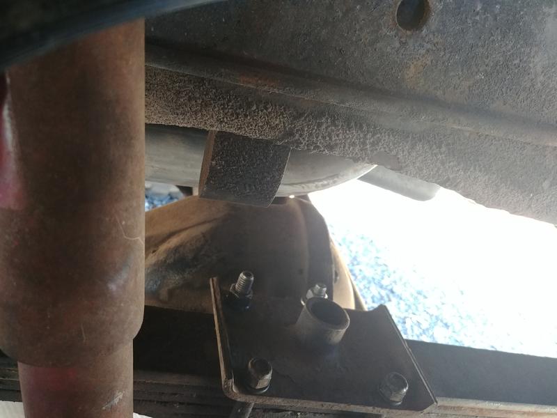

I get how bump steer works geometrically since I basically simulated it lowering the axle(steers left because of pull) maybe a conversion is in order. The bottom three leafs were right side up, but the ordering was backwards. When I held it up to the top two leafs it fit the arch perfectly, when I put it back the right way i had to compress the spring leafs together about an 1.5" with a c-clamp so maybe the front will be stiffer and not be as prone to veering off on uneven ground at slower speeds. There were two problems I found In the adventure, one was the missing drum screws in the first pic(sory the pic isnt that great, all 3 missing on that side), the other was finding out why the passenger Ubolt setup was so janky, I put it back temporary, but I dont really know what to make of it. There was a small piece in this hole, not sure how its supposed to be.
