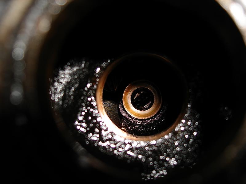

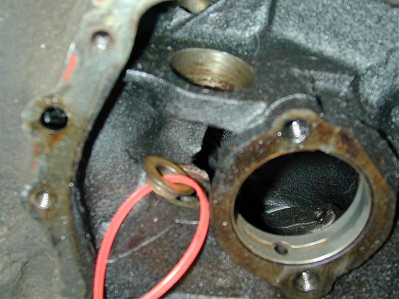

Great! The bushing is in place! And yes...it's bronze, but sometimes appears near black due to oxidation and lube oil varnish.
Here's a pic of what the bushing looks like when removed, sorry for the quality but ya git tha drift! Notice the serrations on the circumference, that's what is supposed to retain the bushing when pressed into position.

Depending upon which tooth ya use for the distributor-to-cam alignment, any plug wire position can be any cylinder number ya want (choice of 8 of course!). Obviously the dui plug cables don't allow much fudge factor without re-labeling. But the labels are just convenience items only anyway.
A sixpack sez ya end up with a base timing factor of 10*>12*btdc!

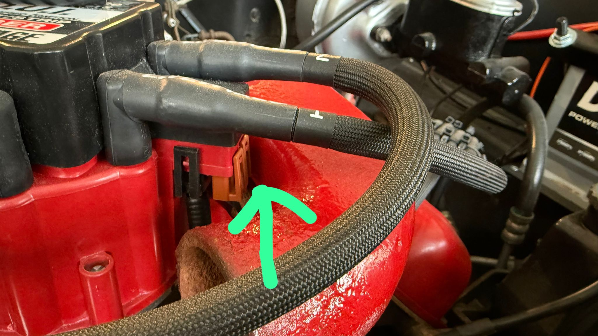

GK and guys, where did you get the Offset Water Outlet Housing? Installing DUI on '78 ScoutII, with Holly 2300 Sniper, and my stock water outlet housing is hitting the elec terminals on my DUI.

I didn't go back and reread what was previously posted in this thread, but the needing of an offset water neck is not true. The stock one that came on most Scout II's works just fine. Is it tight on clearance? Why yes it is. But the distributor does fit and has enough room to make minor timing adjustments, which is all you need.
The Davis Unified Ignition "DUI" HEI Distributor fits just fine with either water neck, in my experience.
Plenty of room to rotate the distributor housing for timing adjustment with either upper water outlet.

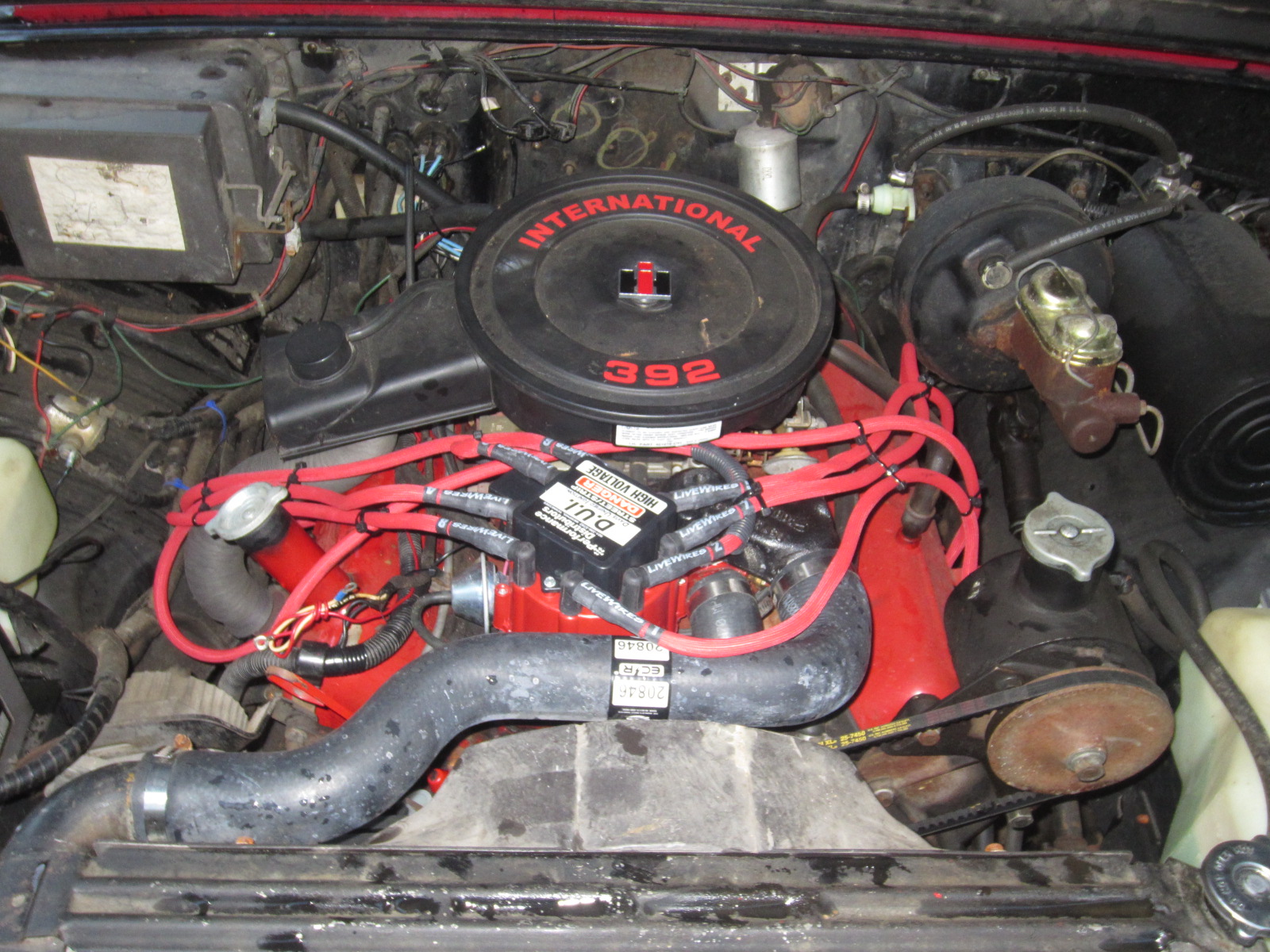

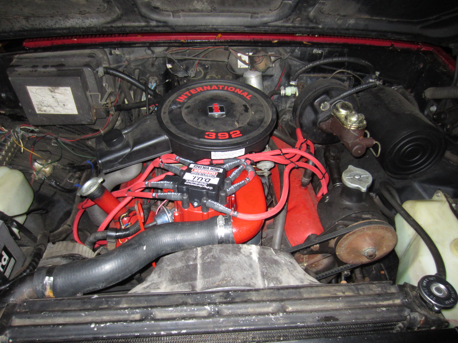

Photo attached of each.
1st: with 90° Water Outlet....
2nd: with Offset Water Outlet....
