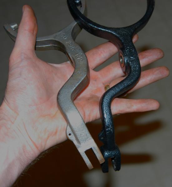

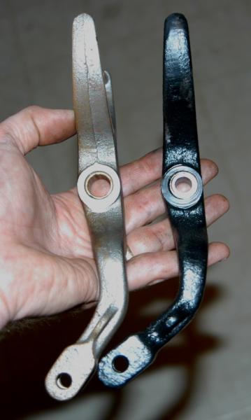

I May have bent the fork. I happened to have another fork in my parts stash and held it up to compare. It didn't look the same, so I pulled it out. The black one is the mm rebuild. The angle is clearly different. They are clearly different designs all around though; the black one is thinner. This might be able to explain a lot. What do you guys think?
Assuming I did bend it, the big question is how. I assume they shouldn't just bend from normal use/abuse of the clutch pedal. And I never really worked the pedal hard until I was already having a problem anyway. :confused5:

Unless the fork was bottoming it should have worked. When you ran in to the cover it probably bent and popped your hose.

The easiest thing will be to install the other fork and see if everything just works. If it does, then I'll start looking at the flywheel cover as a possible culprit. The style is different from my original one, maybe it's from an 800 or something and interfered with the fork leading to a bend.
There are at least two, possibly three variations of the throwout fork. Those were only used on Scout 80, a Scout 80 has a totally different arrangement, nothing like that one and no hydraulics. At some point in time, ihc changed the forging dies to provide a greater cross-section in the beam area of the fork
those forks normally don't "bend" unless heated, I have cores quite often that have been bent in order to change the travel due to the wear situation on the collar and the fork tips. And I have a rudimentary fixture I use to verify each core before repair, though it's always easy to see if they have been bent abnormally in the past.
So what you have is the wrong throwout geometry, resulting in adequate clutch pressure plate travel. Something has caused this, that fork didn't leave here with the wrong angle to the dangle! And your description of the original problem is that the dragging issue of the clutch release came on gradually.

I have n=5 forks here for cores now, two are the r21 version, the other three are the r1 version. The "bend" in the lever on all is exactly the same. One of 'em shows signs of a po grinding on it where it comes close to the slot though, I bet someone did a swaperoo and found that one made contact also and tried to modify the arm. I've welded it up and reground so it is now useable.
The r1 version does not appear in the last gen Scout 80/800 parts list, nor does it appear in the cross-reference or the price list which is used for crossing part numbers also.

I've kinda "custom fit" the bushing in the thick beam fork (r21 suffix) I just finished, that means it gets mounted to a bellhousing and tested for articulation.
What has happened is that the fork has a limit to it's travel when it contacts the bellhousing "pad" when the pedal is depressed. In other words, your slave has "over-traveled" the ability of the fork to release the pressure plate over and over and has bent, that took one hell of a force from that cylinder!
No doubt ihc discovered the same thing about three years too late before they beefed the fork, but that still did not solve the problem of the fork bottoming out on it's stop on the bellhousing.
The root cause...the "travel" of the release of the clutch cover (pressure plate) is not set up correctly, the "release lever-to-flywheel distance" (some call it "release finger height") is not correct. Those clutch setups are extremely tedious since the very short throw of the entire release mechanism has very little forgiveness in freeplay adjustment,...again, it's more like a toggle switch than anything else with a really short pedal travel between engaged and disengaged.
This is why so many of these forks/collars/throwout bearings/slaves/pushrods are scruud up on the s80, it's a totally scruud up geometric problem! Plain old shitball engineering originally.
