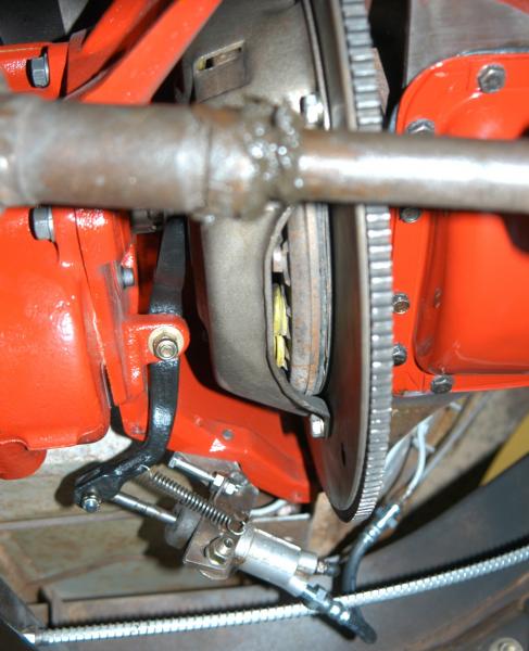

Your pin is 3.5"long? I May have one I can measure for reference of measure the stick out on my 65'. I you think that would help.
I took a photo and got the measurement. Give me a few minutes to Mark it up. I could not find a push rod but the assembly dimension should do.
The 1 3/4" dimension is. There is about 3/16-1/4" of slave stroke before to bearing touched the pp fingers.

All the pushrods I have are bootyfab junk from all directions, I need an oem pushrod myself to use for mockup. I bet Isa has one!
The one I have that May be closest to oem measures rounded tip-to-center of the eye, 2-3/4". One of the worst of the bootyfab units measures about the same.
So I'm suggesting that your pushrod was fabbed and is not oem, that is common when folks try and lengthen the throwout stroke that ends up with the clutch eating away the throwout fork from hard contact. Maybe use an old drill bit cut down to make a test pushrod and then rig it to test stroke with. Now that everything is back to original as far as throw, see if the nominal 2-3/4" length appears to be ballpark. Then you can cut down your existing pushroda a small amount at a time until the throw is perfect. But make sure the pedal free-play at the pedal/master interface is right, so the master is not partially depressed. I have several master cylinder pushrods that are booty-fabbed also to try and make the clutch work, some of these donors had both pushrods scruud over which only makes the entire actuation geometery worse!
Mine's a little tighter than yours. I'm a little over 1.5" when the throwout is touching, maybe 1 9/16". So, if I use your 3/16" number for slop, I'm at 1 3/8" to your 1 3/4" between slave collar and fork eye. 3/8" difference. I suppose that's within tolerance for these old rigs...?
I haven't tried loosening the mount yet. I can't tell if it's original or not. Is your slave tight in its mount? I have two of those mounting bands, and my slave is a little jiggly in both of them. It would work fine, but I put a strip of gasket material in there to make it tight.
Maybe when mm checks in he'll know the length of a factory actuator pin.

2 3/4" would certainly work, though it could be longer and still work too. I'm a little unclear on what happens when it's too long. I think from other threads of yours I've read, you are saying that there really is nothing to stop the fork from going right up into the clutch pp body and getting shredded if the throw is too long? If so, that's just awful design! Ideally then, what stops the travel? Does the pedal stop up against the firewall, or the slave or master reach full travel? The slave only has a little piece of wire holding its piston in if I'm looking at it right...
With the fatter fork it looks like the fork hitting the bellhousing could be a hard limit, so ideally that would bottom out before the fork hit the clutch housing?
I want to make sure I go about the tuning process properly.
The components within the IH bell housing are basically the same as has been used since clutches were introduced.
There is no stroke limit for the tob. Only the design of the master and slave. All limits/specifications assume things are assembled correctly.
Yes the pedal does hit the firewall well actually the Scout has a small round bumper that the pedal bottoms on.
Hydraulically the system can not hyper extend, 5/8 slave with a given stroke, 5/8 master of a limited similar stroke under normal conditions never over strokes. In your situation things were not correct and you ended up over stroking the tob and pp till the levers bottom on the disk hub (deduced not witnessed). Not ever possible when set up per proper technique. Not saying you did a poor job but using it to explain why no hard stops are built in to a master slave system.
Proper pedal free play, proper tob to pp clearance and a properly assembled and adjusted pp you will never have a bottoming issue.
As the friction disk wears down the slave piston will be positioned further and further into the slave bore. Make sure you have enough remaining so the piston doesn't bottom. Back the fork stop off and by hand pull the fork back into the slave till it bottoms. That is your wear limit. You will need to monitor the tob free play as you drive your Scout over the years. The free play will go away as the clutch wears.
If the pedal goes all the way to the bumper, doesn't that always correspond to the same range on the slave? How could it go further as the clutch disk wears? Is it because the clutch pp fingers stop it when things are more fresh, and it doesn't actually go to the stop?
I was referring to the release position like when your foot is off of the pedal. As the clutch disk wears(looses thickness) the pp fingers reach further toward the through out bearing. Thus the slave will need to be able to retract further.
