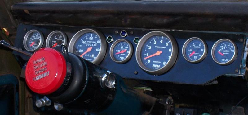

Are you planing on using the original gauges? When I did a complete re-wire on my 74, I installed a complete auto meter gauge set and made an aluminum panel for them
I really like the original gauges. However I am not sure if it is worth going to all the hassle of trying to get them to work. There are some really nice aftermarket gauges out there. I found these on a build on 4btswaps.com(ultimate hunting rig).
