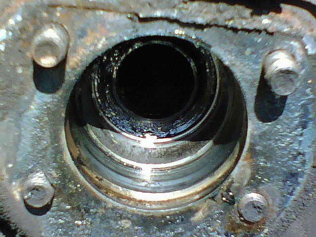

All I have is my service manual,no parts manual.I think it May be able to re-use,the outer cage,of the adjuster is missing about an 1-1/2" of the cage w/the lil slots or holes in it.(retainer)gonna clean up the axle tube an see which 1 it is.guy at the machine shop where I got the set 7's said mopar used this similiar set up?Jeff,thx,michael.( napa had all parts but adjusting retainer,got a good deal on the berings,they was the last 1's,had em for a while.,inner seals was $14 ea!total w/out pressing was 90.00 2-brgs.,4 seals.)
1 more ?. Looks like another race inside the tube just before the inner seal,what rides on that if there's already a race on the axle bearing?Jeff

I don't think what you are seeing is an actual race before the inner seal, just a "step" in the machining process for the axle housing itself. Also...in some applications of that basic axle assembly for other oem uses, there May have been a secondary seal placed there or what is sometimes referred to as a "slinger". That had to do with the first gen versions of the axles and the seals which were actually rawhide lips. The slinger was a "felt" material that kept debris away from the rawhide which would embed in the seal lip and eat the axle surface so that a new seal would not "seal". Later development of various synthetic rubber seal materials did away with the need for the felts after rawhide seals disappeared from the marketplace (major advance!!).

Good deal Jeff! I just looked at the pics ya sent and it sure does look like the wrong race sumbody knocked in there years ago!

good deal Jeff! I just looked at the pics ya sent and it sure does look like the wrong race sumbody knocked in there years ago!
