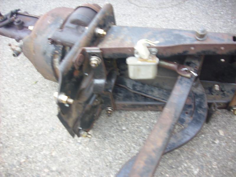

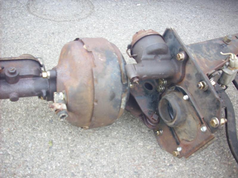

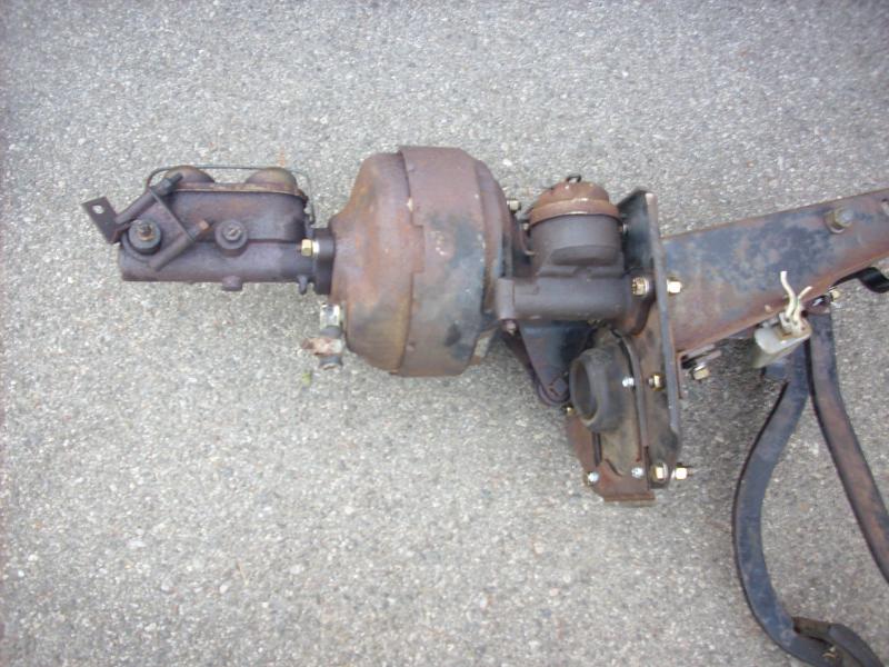

And finally sourced the parts to convert from single circuit brakes to dual circuit brakes. I've driven trucks for years with single circuit brakes with no problems, but the brakes in this truck just plain scare me - broken brake drum, missing rear parking brake links, deep gashes in the new rubber flex lines, and they rub against the knuckle every time the wheels are turned, the pedal is hard but if traveling over 35 mph this truck just will not stop standing on the brake pedal. I know, all things that can be fixed, but if fixing this stuff, I'd rather be putting the time into something more substantial - like the brakes in the axles above rather than my little knuckle d44.
The dual circuit brake parts came as just a big box of disconnected brackets, pins and levers. And having never seen how it came apart, it was a fun puzzle to put back together, the kind of truck work I prefer to do. I know I'll need to get new master brake and clutch cylinders and power booster, but this was just a test assembly to see how it all goes together, and if any parts were missing. Only got one pedal spring - I think it goes on the clutch pedal. Shouldn't there be a a spring on the brake pedal too, or is it unnecessary because it has the vacuum booster?
So I'll be going from this first pic to the second pic:

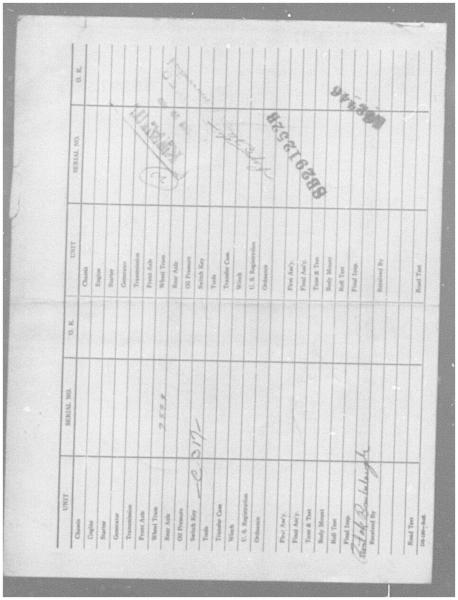

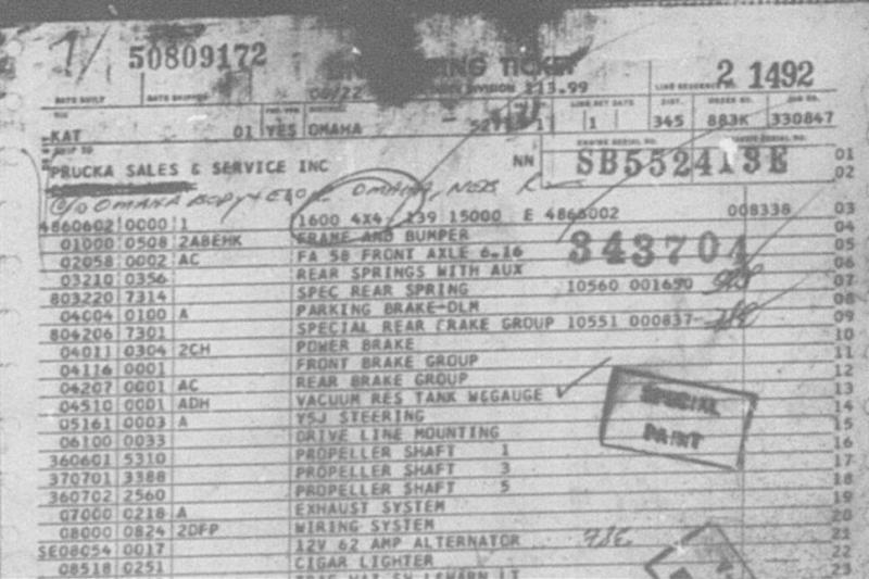

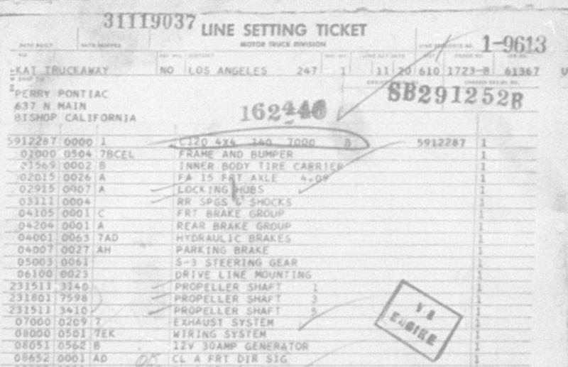

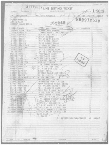

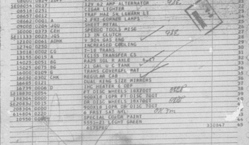

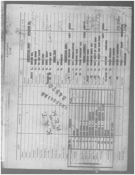

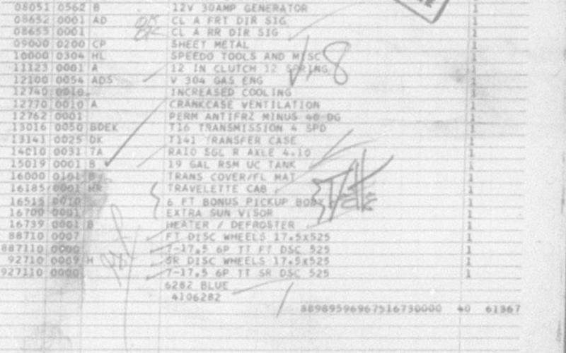

Finally got the line setting tickets for my two trucks. Now trying to figure them out. Do they give specifications such as wheel base?
Thanks.
Steve

The first line 1600 4x4 139 15000
139" (hard to read) = wheel base
15000 # frame setup weight rating
120 4x4 140 7000
140" wheel base
7000# weight rating
the other line items have a code and descriptor and can be researched for better detail.
Thank you.
Any idea what the other numbers on that line or above mean?
And what is the other page that is with each line setting ticket? Even when I flip and enlarge them, they are still too blurry to read.

The first/top page indicates the axles are 6.16 ratio. The lower spec page shows the front axle as 4.09 ratio and rear ratio as 4.10. That .01 difference won't matter. "increased cooling' gets you the 3 row radiator instead of the 2 row radiator.
