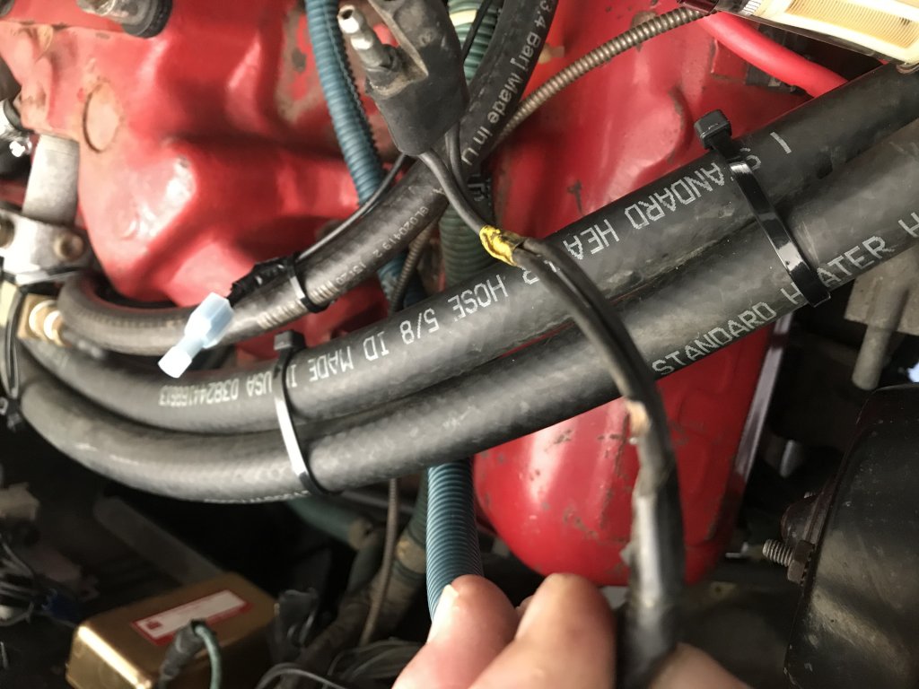

Here’s what I am homed-in on at the moment: I noticed when checking timing (#8 cyl) my standard timing light was in sync with the bobbles — engine would barely stumble and light would as well. Hummm...At first thought maybe timing light not picking-up well around plug wire, light was fine. Now I am thinking.... And since I can hear bobbles on both sides of engine via dual exhaust sounds I checked all other cylinders. I see same bobble result on cylinders 1, 5, 4, 8. Other 4 cylinders don’t miss a beat. This is very consistent, not random. Its actually very rhythmic.
Behavior of timing light aligns with bobbles and indicates some sort of ignition miss.
Scratching head. Is it time to pull gold box along with the dist electronics and install Pertronix? Many wise warhorses haunting these forums report the gold box is either off or on, no in-between and doesn’t exhibit these sorts of bobbles. I do wonder about the electronic module inside the dist??
*Also need to advise I just replaced plug wires with 8mm set.* Verified proper wire location/firing order — I don’t have any wires mis-seated.
These are quality wires but are a universal set I had to terminate myself (dist end) using good crimping tool. Like to think I did good job there. But did I?
Note I was very thorough with terminations and I DID ohm all wires after I built them. All ohm’ed fine, very low. (Am gonna take another close look at wires, will swap a “good” one with a bobble one to see what happens via timing light behavior.)
Anyone ever run across these ignition/firing bobble symptoms? What is that timing light telling me?
