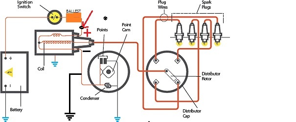

I was trying to explain the voltages and drops across the ignition components.. The values you posted were odd...
The long and short of it is, if you're happy with the way it is running that is all that matters.....
If you want to dig around fill in these blanks I will give you what voltages you should be reading at the coil key on- starter off. If things don't add up, there is a problem...
Coil resistance_______
ballast resistance______
While it is running really well, I hate not knowing if its running properly or not. So I would greatly appreciate your input as I dig into this more. The resistance of the ballast is 1.7 ohms. I just measured it, not moments ago. I couldn't get a reading from the coil, (likely an operator error), but the advertised resistance is 0.7 ohms primary and 4.5k ohms secondary. Anything else we need?
Ok. 5.25 amps with those resistance values @ 12.6 v with the coil - terminal grounded and-
measured voltage drop across the resistor is 8.925 v
to read this, place one vom lead on each end of the resistor (ballest).
Positive coil voltage should be 3.675v. To read this place one vom lead on ground and one end on the + coil terminal.
All readings are with the ignition switch in the run position and the coil - terminal grounded.
You have a situation that is disipating most of your system voltage at the ballest resistor and onln 3.7 volts is availible to make the spark....... Bet the ballest will die young and it is runnning super hot.
The resister should leave 40-50% of the availible voltage for the coil. Now you are generating 46 watts of heat and little for spark.. You should have a 1 - .8 ohm resistor. The unknown with that setup will be how much current the prestolite will take... With the 1 ohm ballest the system current will be 7.4 amps and with a .8 it will be 8.4.. I would install a 6 box and loose the resistor..
