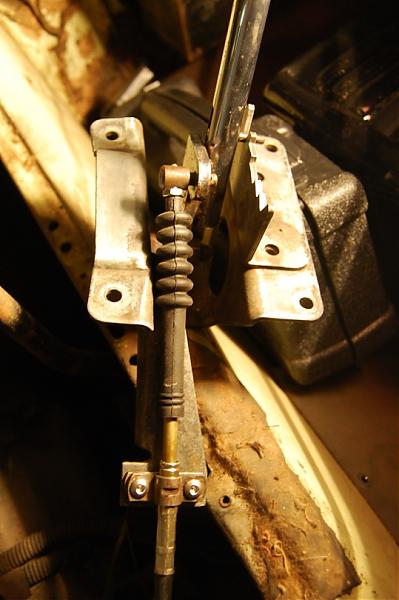

My 71 Scout II/727 came with a B&M shifter setup that doesn't work very well. I think its really a combination of being out of adjustment and probably a cheap solution to begin with. I would like to be able shift without having to guess what gear its in and I'd prefer just going back to the original setup if possible anyway. I've already pulled out the B&M (pics: 5594 - shifter, 5592 - B&M bracket/cable) and purchased an orig shift lever (ebay) and a new 727 shift cable (ihon) to make the regression.

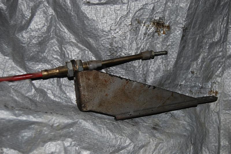

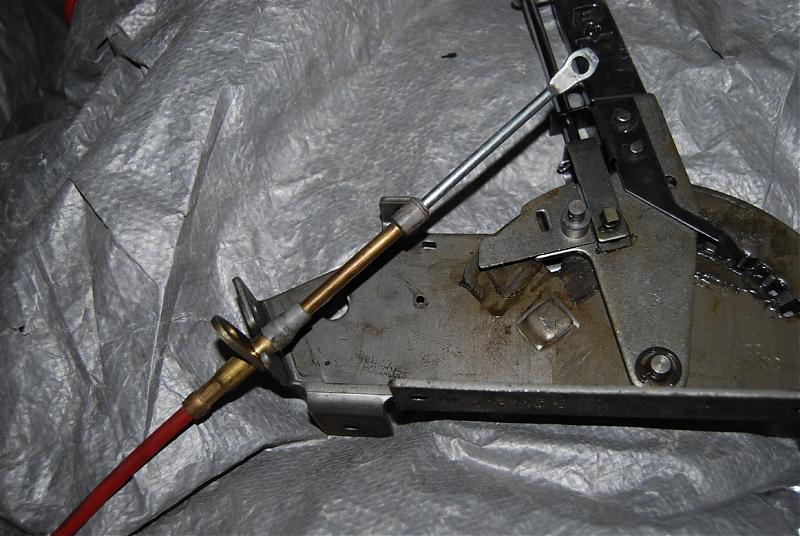

For a little background, the B&M is a little different as it doesn't use the clamp-down bracket, but comes with a big bracket arm that bolts through the transmission pan bolts. The other difference is the cable comes out of the front of the B&M shifter and the loop goes towards the bell housing and then hooks up instead of out the back and looping towards the rear. So essentially the B&M shifter pulls the transmission into the gears instead of pushing. So there's no doubt it would adjust similar to the original setup, but I prefer the action of a normal lever to this ratcheting shifter.

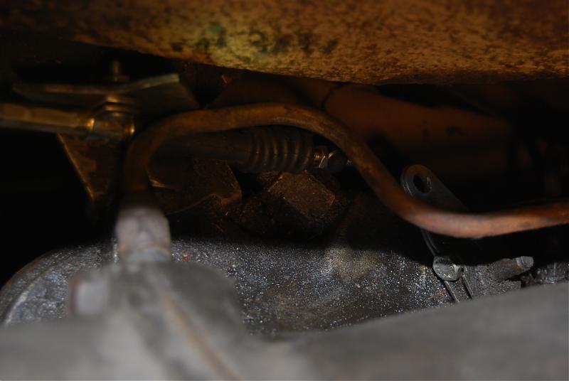

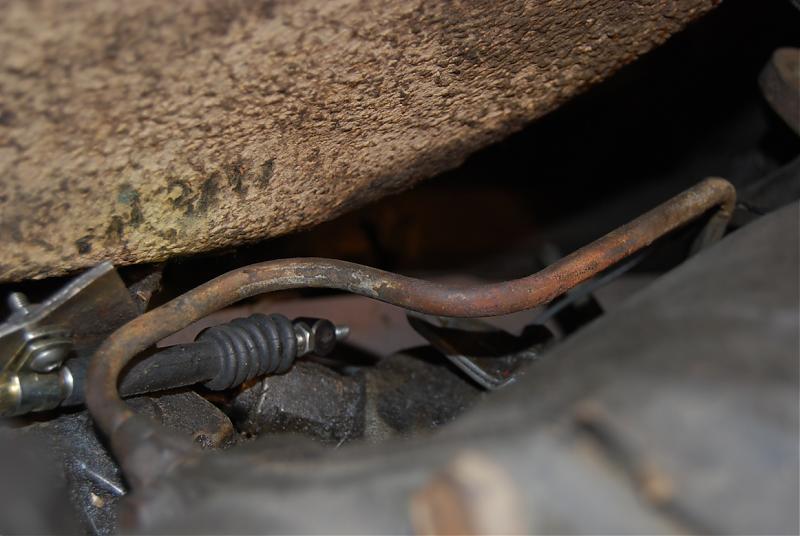

That brings me to my problem - the new cable is about 2? Inches shy of hooking onto the transmission (pics: 5604, 5607). And as I didn't make the change to the B&M and this is my first time dealing with a 727 and I'm not sure what I'm missing. I would imagine my cable is the right one since I emailed back and forth with Jeff before I got it, but I don't know any better. And it doesn't look like the bracket is in the wrong place. And both the tranny and stick are in park. So I'm stuck. What am I missing?

Also, the B&M shifter is indexed for the chrysler-pattern shift lever that mounts on the valve body rooster comb. The Scout II shifter lever is much shorter! And it's designed to be used with only the Scout II shifter geometry. There are many variations of that shifter arm, and then there are the arms that were supplied in various shifter kits supplied by B&M, hurst, speedway, lokar, sparkomatic, etc. Some used whatever was on the actual trans application (such as a '72 dodge pickup, or a '69 plymouth satellite), others used their own arm supplied in the kit!
So what you need to make a stock Scout II shifter work, is a stock Scout II shift arm/lever!

Also, in reviewing your pics, I see the B&M-supplied cable mount attached to the B&M cable. That mount will not work without extensive modification in order to use with the oem shifter stuff! The oem cable mount is completely different in design (callout #22 in the parts list) and it mounts in a totally different position. I have only one of those mounts, but Jeff probably has some additional items on the shelf if he can find 'em. If you need a picture of that item, I'll dig it out of the parts shelf here and post tomorrow.
On the side of the pan rail under the shifter lever and nss switch, you will find an IH part number stamped along with some other numbers. If you will post the part number for your tranny, I'll try to id it for you, there were "about" eleven different t-407 slushers used throughout the sii production run, just for the sv motors. The rambler/amc 232/258 motors also used the amc version of the 727 inthe Scout II, but they don't interchange since the bellhousing design is different.

As for the bracket that the cable gets clamped to (#22) it is whats hiding under the gunk. Fortunately it was just left ignored there by the po because the B&M routed the other way.
