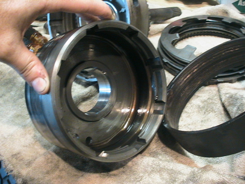

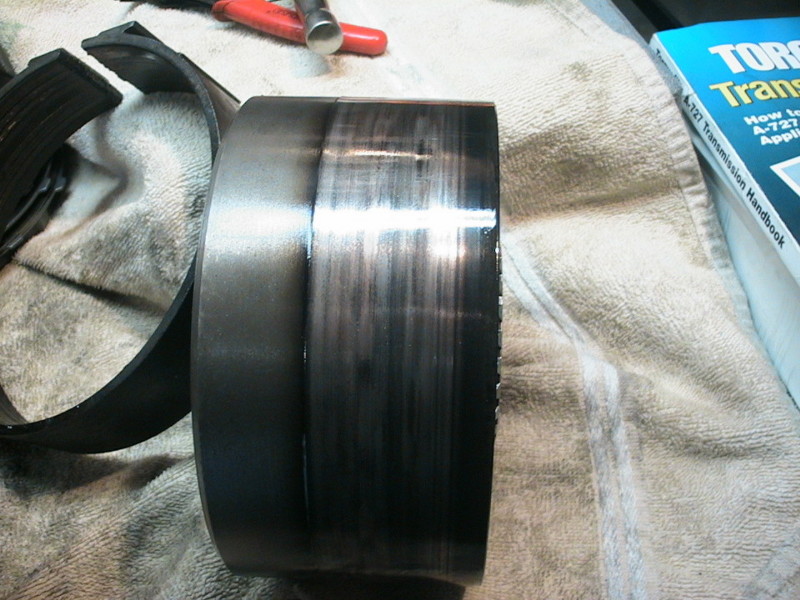

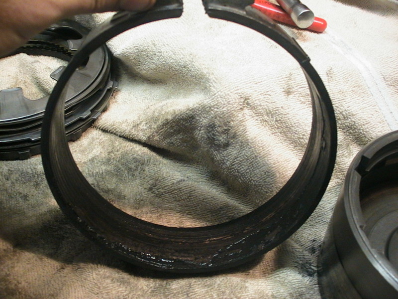

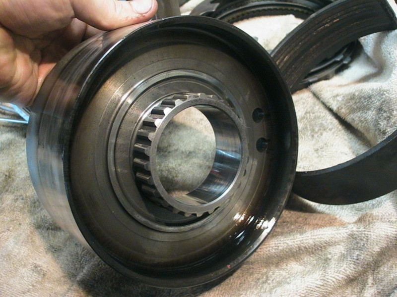

Armpit of hell May have been an understatement. That's one scorched ass rear band and drum. The drum surface still seems smooth, but considering how hot this thing got, it might be a good idea to replace it. I know exactly how this sitcheeyashun can be rectumfied. All it would take is a replacement rear drum, new rear band, and a valve body that is totally sterile and gayrondamteed to be dead-nuts perfect...if it accidentally came equipped with a transgo tf-2 kit installed, I wouldn't bitch. Call it a fence mender, late birthday present, early x-mas present or all the above. I don't think that would be too far out of line...well, maybe the shift kit is a bit of a stretch.

A roasted rear drum and band is certainly not an unusual failure mode in one of these units. Those parts are unusually robust, but a vehicle which is badly "stuck" over and over and is abused during the removal process (rocking) really puts a tremendous strain on the low/reverse band and drum.
A very small amount of friction material will always be found in the sump as the stuff wears away from the clutch discs and the bands. That is why we replace those parts during a rebuild.
A tranny with that kind of deterioration will certainly load the valve body with really nasty oil and debris also so an extreme cleaning must be performed also (which I gather you have already done).
The torque converter is going to have a major load of debris also, I'd always replace it before re-installing the trans.
That rear drum should not be re-used. It's not even a candidate for "turning" ( a very poor reman process in my opinion). It's been badly overheated and those parts (new or used) are fairly inexpensive so no way or reason to try and clean it up.
I do have a few of those rear drums, you are welcome to one if needed. Just needs to be final cleaned before installation.
As for the band, those can vary in cost from $35>$185. No need for the high dollar version which is only used in sub-11 second drag rigs.
