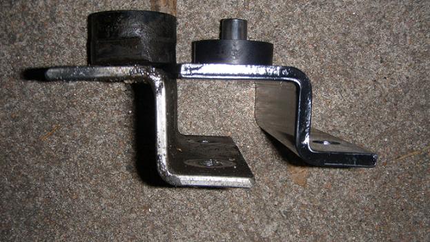

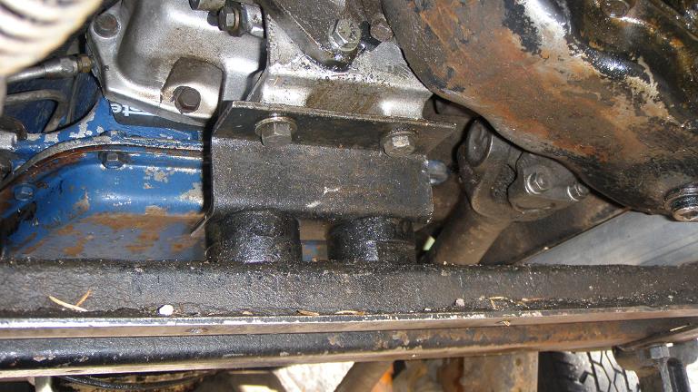

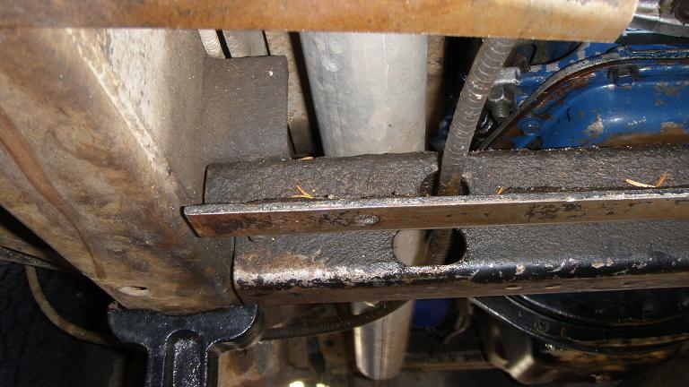

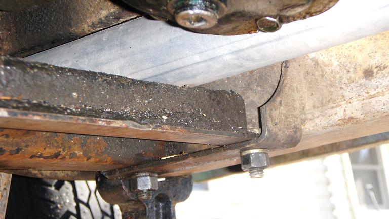

I was about to put in my new trans mount when I noticed a weld on the passenger side bracket. The cross member doesn't mount the same on both sides so I just want to make sure I have the right one. I can't find any pictures online.
Also, do you use the front or rear mount holes?

Thanks. It looks like I need to open up the holes on the cross member so I can get the metal sleeves through it. It's 34 out now so I'll do it tomorrow.

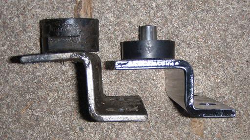

Check out the difference in height on the two mounts. Old whatever was on there on the left. CPT on the right. I think this will move the angle of my t-case lever back so it doesn't touch the hood release in 4l.

In this picture the mount is installed wrong.
Is that how you installed the new mount? There should be a puck on either side of the crossmember. Tighten bolts down until the nut bottoms out on the sleeve.
That's the old mount. Not only installed wrong but the plate is taller. Compared to the unit I bought from you, it put my trans 1 1/4" higher.
