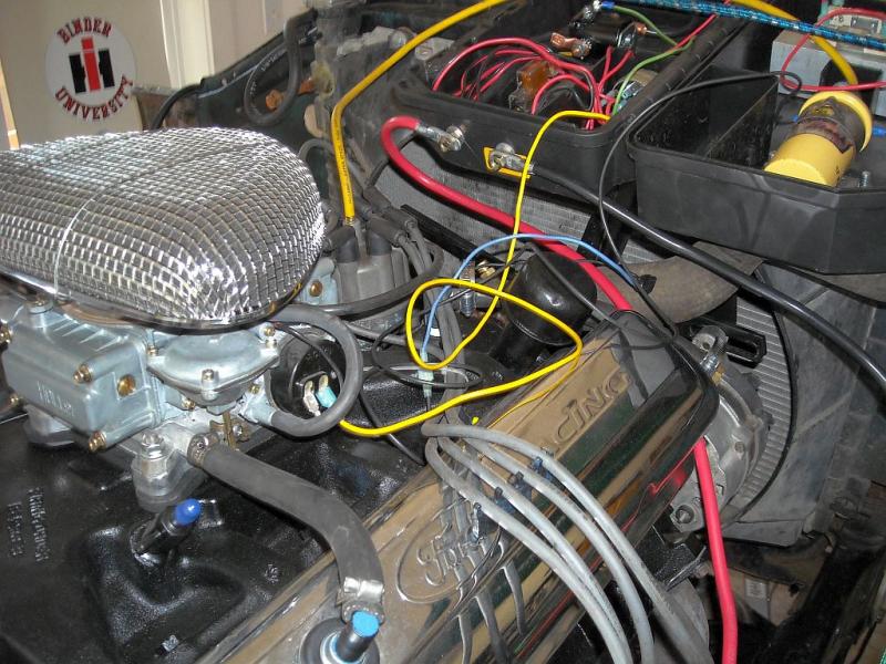

Another shot of the same Ford installation with the engine actually running in a test chassis using a "portable" electrical system I fabbed for this purpose. You can clearly see the choke setup, the switched b+ current supplied to the choke in this pic comes from a feed in the box, the box is connected to an optima shop battery for test running engines.
Notice the pcv connection for the Ford...that does work on this engine using this Ford oem low-rise intake manifold and is exactly how the oem pcv was hooked up, that won't work on many IH intake manifolds.

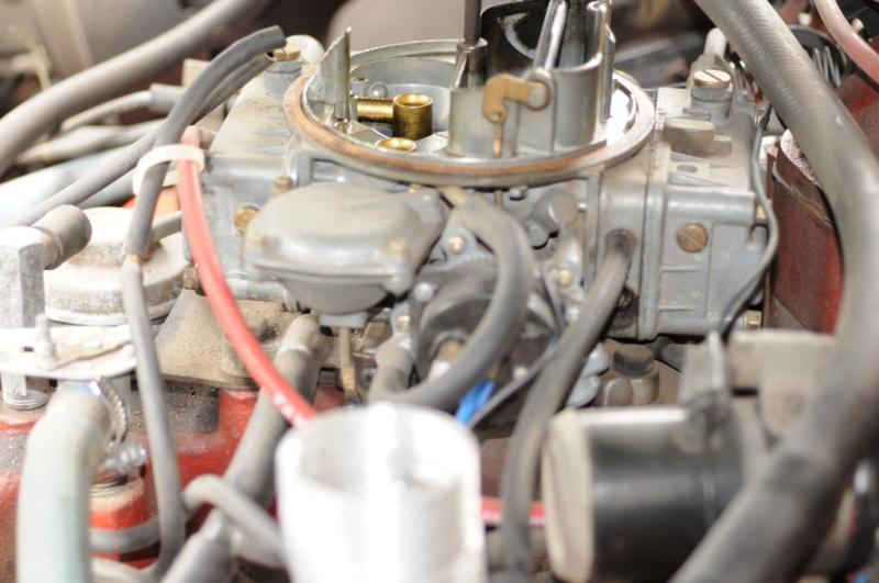

Actually, I do not see the vacuum nipple for the choke in his pictures of his carb (80457).
As opposed to "our" 80457...

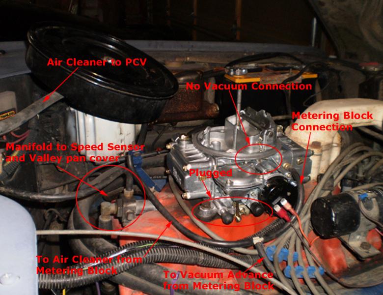

I cannot take the picture at this time, but I modified and enlarged one of the previous ones indicating all vacuum lines and where they come from or go to. These are the only vacuum connections with the exception of the manifold to the power booster for the brakes.

Does not appear to be a 80457 (or at least "like" mine) though I assume that there May be a couple variations.
Is there a (manifold) vacuum nipple on the front / pass side of carb / "underneath" the primary fuel bowl? Comes out at a 45 degree angle.

Was / is there a pcv valve in the valley pan?
If so, the pcv valve should be "plumbed" to the concoction of ??? / "tees" on the "rear" (firewall side) of the intake manifold (marked "manifold to speed sensor and valley pan cover" in your picture) - not the air cleaner base.
Since you do not have any thermo vacuum switches, I would just cap the two nipples on the "speed sensor vacuum selector valve" - not run the manifold vacuum line from the "tee" on the rear of the intake manifold.
Maybe michael mayben has a different idea on this.
Same (with no tvs switches) applies to the 3 small nipples on the base of the air cleaner -- might as well cap them. And, remove the "tee" and line from ported vacuum marked to air cleaner.
Just run a line from the carb (metering block) to the vacuum advance can on the dist. As michael stated.
The rubber line to the air cleaner base marked "pcv valve" in your picture should actually be a line from a flame arresstor in the driver's side valve cover.
But, who knows (I don't) with the current setup of the engine -- and it is somewhat dependent on the year of the engine.

I am sure that there are several issues with the vacuum setup. I had no problems with the setup before I rebuilt the motor and have made no changes since I have owned it.
It is a 1975 with a 345. It had an emissions rail on both sides originally, but when I took the heads in to be redone I had the holes plugged. I also had them grind down and polish the protrusions on the inside of the exhaust ports.
The card is an 80457 and is marked as such on the air horn.
Yes there is a vacuum nipple on the underside as you indicated.
There is no thermo switch or egr valve and the pcv valve is mounted in the top of the passenger side valve cover.
I intend to remove the tee concoction you are refering to in this process of straigtening out the vacuum setup. At this time it is a direct feed from the manifold to the valley pan cover with no pcv valve inline and also supplies the speed sensor.
I have already removed the tee and lines from the metering block and now only have one line from the metering block to the vacuum advance.

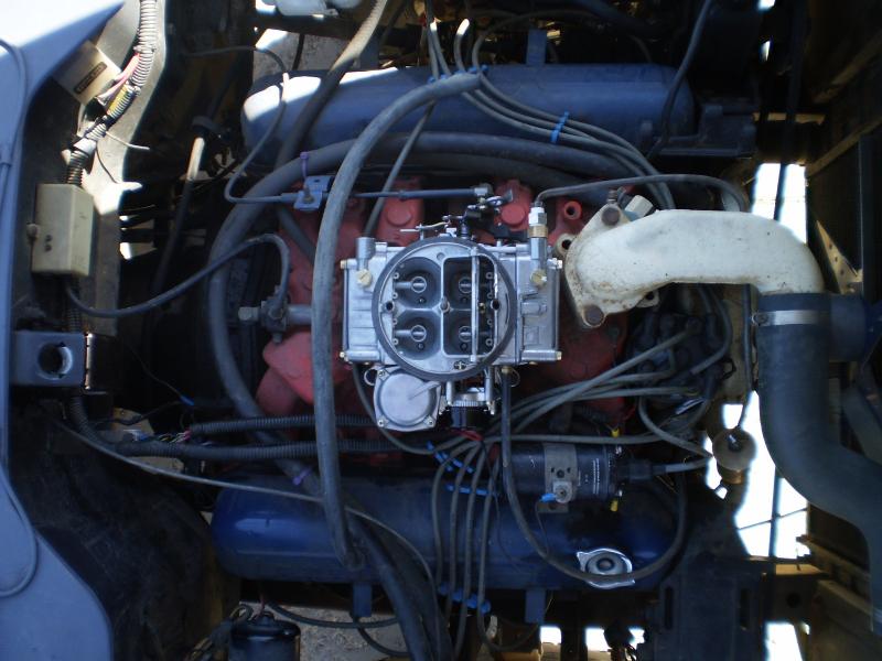

I have taken a picture of the motor from the top and can be seen below.
If this is all setup wrong then lets get it right.

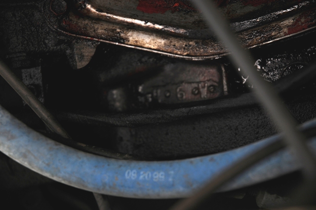

If you are curious:
IH engines (sv v8) have a build date -- stamped in a piece of metal attached to back (firewall) of the block -- "behind" the valley pan.
"somewhere" someone had posted / compiled a "translation" to an actual date...
