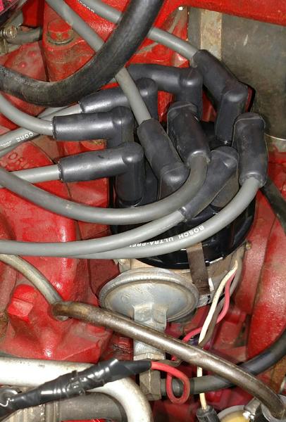

here is a pic of my distributor. It has plenty of room to rotate in either direction...

It looks to me like you have little if any room to rotate the distributor clockwise from the position shown in the pic. That direction would retard the timing from 20 btdc to a lower, more normal number, but only if it can be moved that way. To me it looks like all you can do is advance the timing further by rotating ccw.

I will test the vacuum later this week. Hopefully tomorrow. I will also take a closer look at how much room is in there to move the distributor. There is definitely room in both directions though, even if the pic doesn't really show it.
