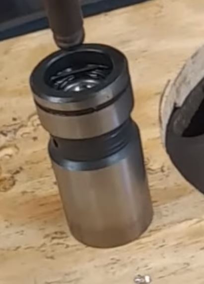

This lifter is not stuck compressed. It is fully extended. The plunger is resting on the retaining clip.
I took out lifter 4 and took it apart, no obvious gunk. I did the "finger push" test as described in the service manual. Seemed OK
If it is like that at full idle, I think you are OK. What you are hearing at that rpm is not unusual.

it still taps very loudly and always. Less at lower rpm's. It seems to me that cylinders 2 & 4 lifters are not "rebounding" properly so as rpm's increase they don't maintain constant contact with the pushrod. From the video you see that the lifteers with the strongest tapping noise also have the sloppiest looking pushrods. I am guessing this is the valve and not the internal spring?

Replacing any part without good evidence and a chance that it will fix the issue, is not a good plan. The lifter has worn in the to lobo and the cam lobe has worn into the lifter. Wisdom says that a new lifter will not match the particular lobe shape and surface. That means that the new lifter and lobe will make contact on the high spots only. That makes the Hertzian contact stress (only using this term because you are a professor) go through the roof. Bearing interface failure is very likely under those conditions
Have you measure lifter preload?
With the noisy cylinder at tdc on the compression stroke( both valves closed for 1/2 revolution of the crank), is the pushrod loose with up and down play? If you loosen the rocker assembly and watch the pushrod, does it rise like the lifter is extending? If you have a rise of >.035" you are good.
