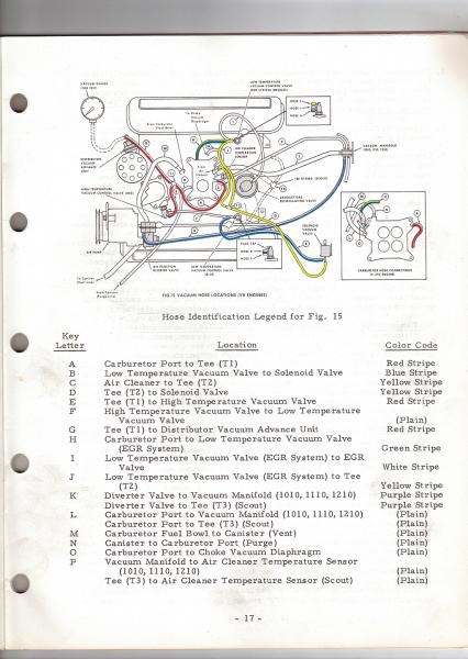

This is page 17 of 40, fleet service news letter #slf72-41, dated August 14, 1972. Entitled:
"1973 emissions control systems for light-duty vehicles (under 6,000 lbs. G.v.w. Or below 12 passenger capacity). Scout II, 1010, 1110, 1110 4x4, 1210 Travelall, 1210 4x4 Travelall."
this document (along with a companion service letter issued to only the IH dealer base), describes in detail the entire emissions scenario for these vehicles introduced for the 49-state market beginning with the m/y 1973 production run. The 1973 model year was pivotal concerning emissions systems for all oem manufacturers who built for the u.s. Domestic market.
A similar document was issued only for the California dealer and fleet base, that addressed the few differences that were incorporated on the cali-only vehicles. And iirc, the "cali-only" emissions scenario was introduced one model year ahead of 1973, so this stuff would have been applied to cali-only in model year 1972.
Unfortunately, this information is not found in a concise format in any versions of the various pertinent IH service manuals, though some of it is addressed. It was only with the introduction of the m/y '77 and later Scout II that the reproduction service manuals contain all this type information, along with an extensive diagnostic and troubleshooting section dealing with only emissions and drivability problems.
Also...this document does not cover the fullsize stuff that May have had the amc-sourced 401 engine installed very late in the 1973 model production run. Most folks think those motors were used only in the '74 and '75 vehicles. But some were actually built and designated as 1973 model year. This was due to the implementation of the federal 17 digit vin also, along with "rules" regarding how the "model year" of a motor vehicle could be designated. The 17 digit vin was phased in over a period of time by all oems, it was not a "drop dead" kinda deal and has many variances.

Here's the vacuum hose routing diagram contained in service letter slf72-41 in .pdf format.
My intention at this point is to maintain this vehicle under the hood as original as possible since all underhood systems are functional (or at least semi-functional) right now. While the internal engine mechanicals are certainly not original in configuration, the rest of it is. It is not very often that we get a chance to work with such an unmolested vehicle under the hood!
The only planned change will be to install a mag trigger-converted Holley distributor to eliminate the breaker point system, along with an appropriate companion coil.

Checked your pdf... It matches a page in my cts-2303 service manual (without the pretty colors and slightly different (but same meaning) verbage in the description) and it matches the decal on the air horn of the air cleaner on my t/a (73 392ca smog).
Pulled the orig Holley 4bbl out of the box and the throttle "plate" matches the pdf with 5 vacuum ports... (80457s only has 2). (actually decided to take the fuel bowls off to see what lurks there - after 9 years.)

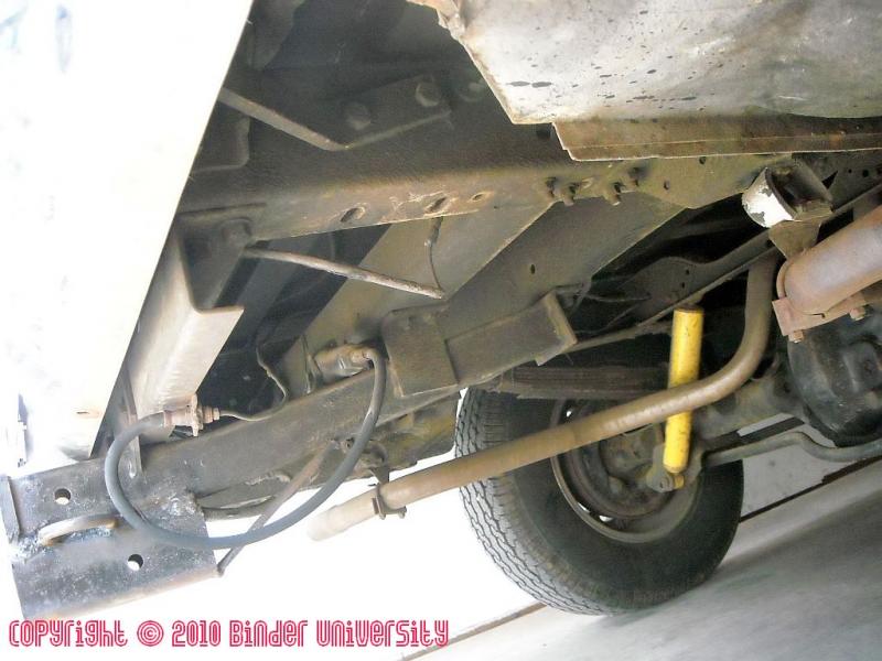

This rig needs to be capable of having multiple trailers connected and gone at a moments notice, so that area got some luv.

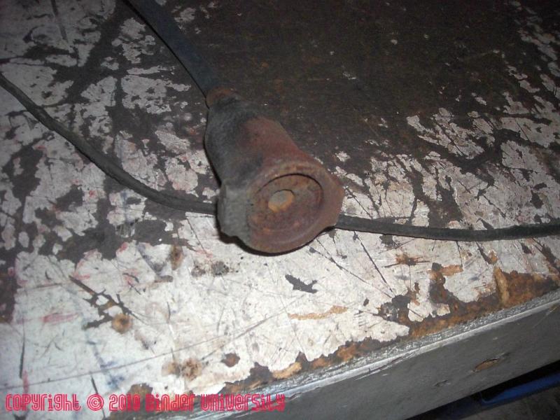

I have no idea what leads the po breed to do shit like this (or have done!). A second "receiver" had been booty-fabbed onto the primary using the wrong size tubing that was then "plated" on the inside to neck it down for a 2" stinger!
Also, in this pic ya see a "remote" hydraulic slave cylinder that was plumbed on it's own feed from the master cylinder at one time (not from the previously-installed kelsey-hayes oldskool trailer brake control). The slave is mounted in a "holder" made for that purpose to keep it out of the way until connected. This is a dry-break slave which pushes a "pushrod" on the mating actuator when connected with some sort of "gladhand" connector. I've seen these before on really old stock/horse trailers that had hydraulic brakes that were not "surge"-design actuation.
All this crap is now lying in the scrap pile outside the shop door to haul off to recycle.
The receiver system itself is part of the oem-option "towing package". This receiver is not of the "torsion tube" design prevalent over the last twenty years for receivers, this one mounts to the frame at three distinct points using two additional crossmembers. That oem-option receiver was not actually manufactured by IH, but is an out-sourced item from reese, still the big gun in the towing products industry.
Keep in mind, this ride was ordered with the "factory"-installed tow package. That means the trailer lighting connection point was integrated into the vehicle harness in a semi-engineered fashion. And back then, the typical nylon/delrin harness connectors we use today in towing applications didn't exist, the units were steel which rotted away quickly in salt-slush road environments, just like the rest of the IH stuff.
But, the oem connector has survived even though the mounting bracket had been scab-welded back in place a few times! And internally, it was totally rotten, no way it could be used.

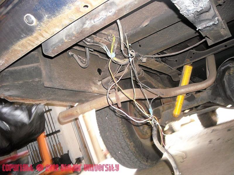

Because this rig had been shot with oldskool asphalt undercoat back in '88 on top of everything, it's a bitch to dig all the stuff out and make proper repairs. Once the trailer harness was dug out of the tar, I thought I'd find maybe a pristine, original connection point for the vehicle wiring harness, something I've never seen before...wrong! Like all other po virus-induced workarounds, this one has been botched many times instead of simply repaired correctly! Then swaddled in layers of electrical tape and shot with undercoat!
Let's see, there are three different types of crimp-on butt connectors, several scotchloks (those suk!), and some wire runs added that are duplicates of the what was already inside the oem harness. On top of that, the wire gauges used for the repair are all mixed up! The oem fusible link for the trailer battery(s) charging feed has been eliminated, resulting in no system protection for that wire run.
So all this shit was ripped out and the oem vehicle wiring harness prepped for resto. A fresh seven/flat rv connector has been properly mounted and will be wired in along with two new feeds from the engine bay once I've installed an auxiliary electrical sub-panel for connecting electrical add-ons. The feeds for the trailer brakes and the battery charging wire run will be protected by circuit breakers per standard practice.

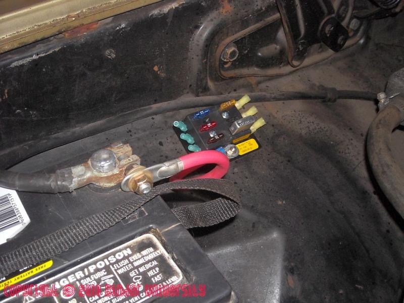

What are you going to use for your sub-panel?

what are you going to use for your sub-panel?
I think this item is the best bang for the buck, been using 'em for years.
N=6 atc fuse slots, rated at 30a max each slot, total panel ampacity is 100a simultaneous pass-thru. Connected with scrap 4 gauge battery cable, I don't toss out anything that has to do with wire! The buss p/n for this one is bp/15600-06-20.
Ihon also has the kwikwire version of a similar device available.
The electric brake control gets wired with 10 gauge and protected with a 20a circuit breaker (never a fuse!) for a dual axle/4 wheel brake set on the trailer. The charge lead back to the trailer connector for battery charging is also a 10 gauge run with a 30a circuit breaker. The remaining open slots can be used for anything up to a 30a load, one will be wired to a surface-mount 12vdc plug tap under the hood for auxiliary plug-in devices.

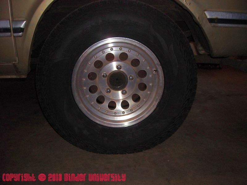

Got the kumho 265x16 snoflake meats mounted Saturday, ended up going with the load range "e" afterall. That way, if we end up not likin' 'em they will mount on the beater dually wheels. Shopped hard for meats, the kumhos are by far the most bang for buck out there right now, at least locally, the prices are all over the place when ya "shop".
The dude that slapped on the fresh meats at tire factory in springfield has just acquired a Scout II for a dd and it was parked in the back lot. So I ended up recruiting a new IHSTO member and I'm sure he'll pop up here on ihon soon too.
This ride will occasionally see trailertote duty, so "e" rated meats are imperative.
Now, the entire suspension/steering/axle sets/brakes/tires all have less than 3k miles on 'em since total refresh with all new parts. Even $230 (1988 dollars) for new warn premium locking hubs.
When ron at bisio's slapped in that d60 axle back in '88, I think he mounted it in the wrong spring perch hole, the wheel doesn't center in the wheel well properly, but I'll deal with that later. The rear springs were custom-fabbed items at that point also, it May be that they did not have the exact spring center location since these springs are not usually symmetrical (or they are turned around backwards/side-to-side).
The rear brakes are now fresh with new cylinders, when they were last done in '87, new drums were installed on the rear along with riveted shoes. A replacement new master cylinder is waiting in town right now so once that's stuck on, the brake work is done.
The tailgate system was totally refreshed yesterday. Mikee had already installed a manual window regulator on it which I adore! But the latches were frozen and the pull rods for the release handle rotted through.
When the rig was painted at some point, the latches weren't masked, so paint had really messed 'em up...but carb cleaner will remove anything. The tiny coil trip springs for the rotary latches were also rotted away so I fabbed replacements and made new pull rods out of welding rod.
Now the rear window and the tailgate operate just like a modern rig so we can hawl dawgs and groceries. And the rear cargo light works off the switch just like it's supposed to.
I do not think the rear tire was ever centered. Mine (1210 t/a) are not -- though I have new (20 years ago) "fabbed" rear springs, also.
The rear wheel well opening is not symmetrical...
Plus, the original h78-15 tires were only about 28" in diameter;:d the original 9.50 x 16.5 tires on my t/a were probably only about 29" in diameter.
