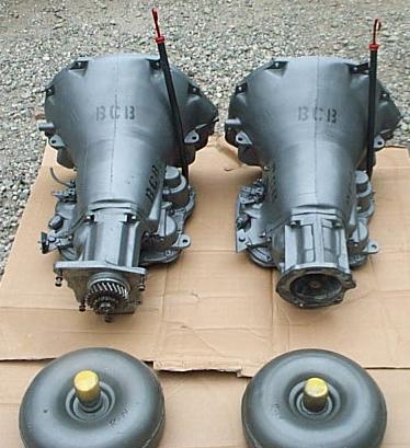

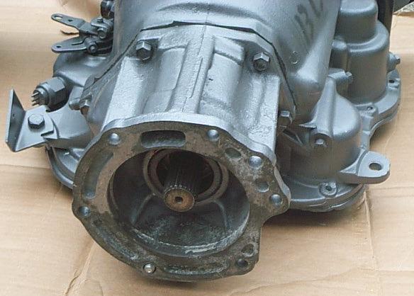

Quote from bcb's page:
"the transmissions pictured in the following photos are 727 internationals. The difference being the tailshaft bolt up adapter. The one on the left looking from the back forward is a stock Scout 2 727 with the texas adapter and bullgear for the Dana 20. The one on the right has been converted to a 6 bolt up style transfer case. Case that have 6 bolt up patterens include the most common but are not limited to a Jeep Dana 300, Chevy/Ford np 205, or the np-203. The one picture will be going in my traveler with a Jeep Dana 300 (2.63:1 low range)."
