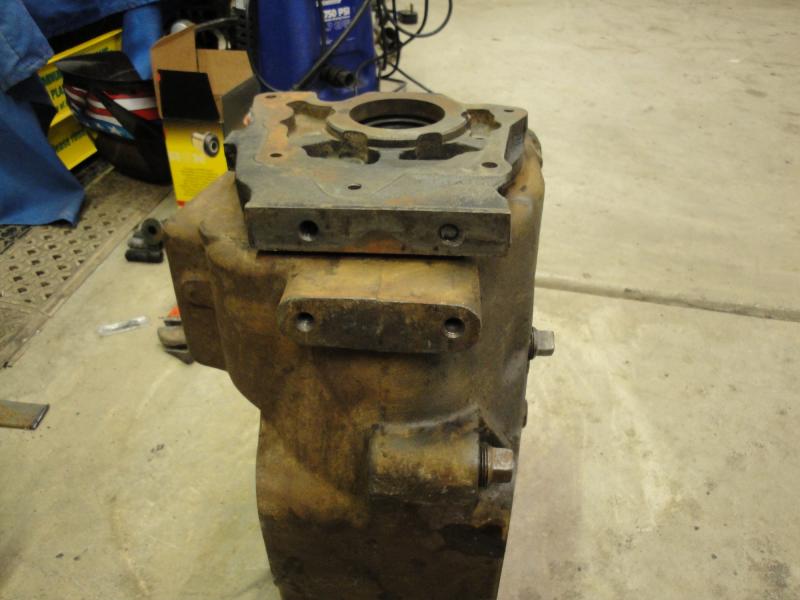

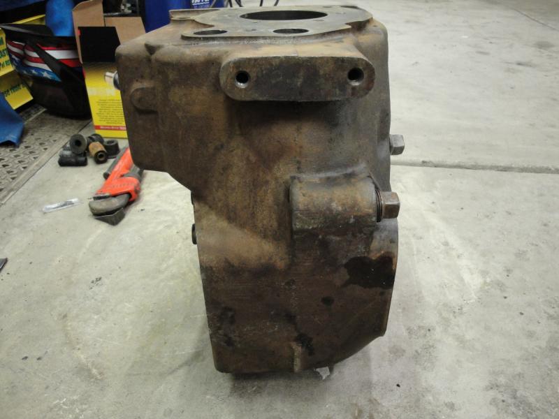

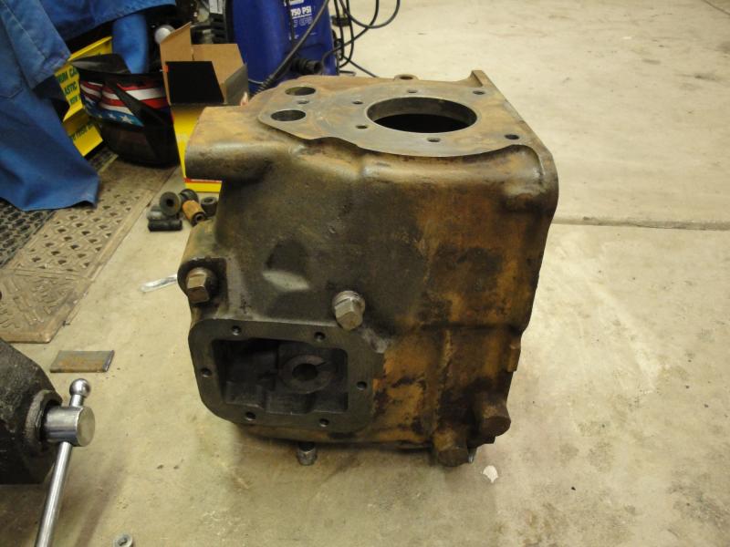

All of the t-19s I have seen have the crossmember mount cast into the tranny case. I will post some pics tomorrow.
This is interesting to know. I have a t-19 to swap into the Scout to replace the t-18 in there now. The t-19 has no t/c adapter. I had heard there were some "issues" with a swap. Are the tranny lengths the same?

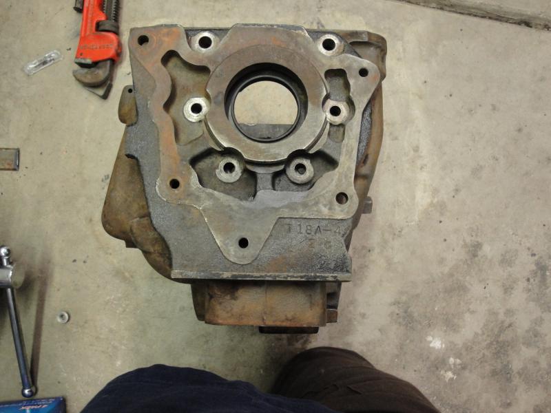

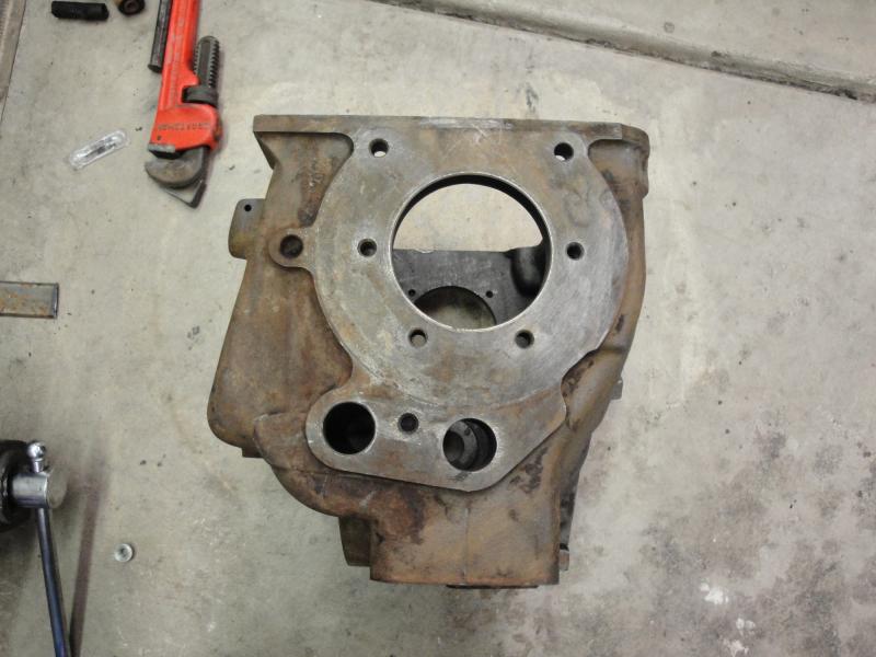

As you can see in these pics the cast boss in the t-19 is a bit close to the mounts in the t-18 t/c adapter and would make for difficulty in mounting. A t-19 t/c adapter does not even cover the ends of the idler shaft or cluster shaft.

Transmission lengths are the same but yes the adapters are unique to each transmission.

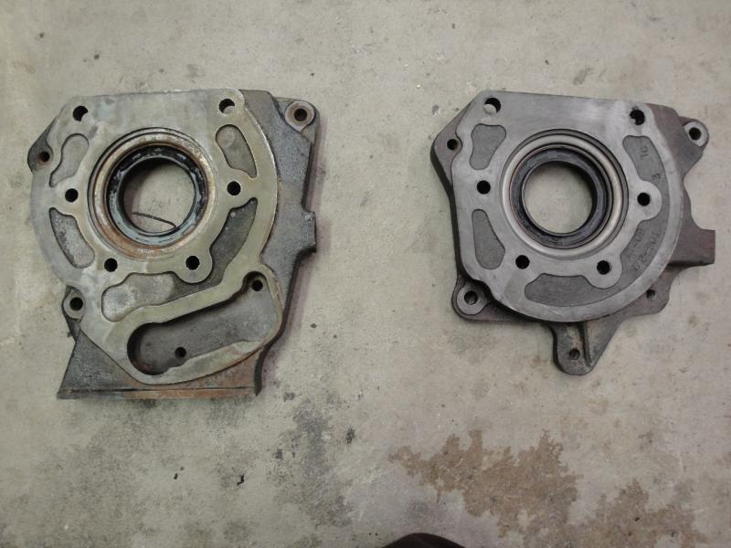

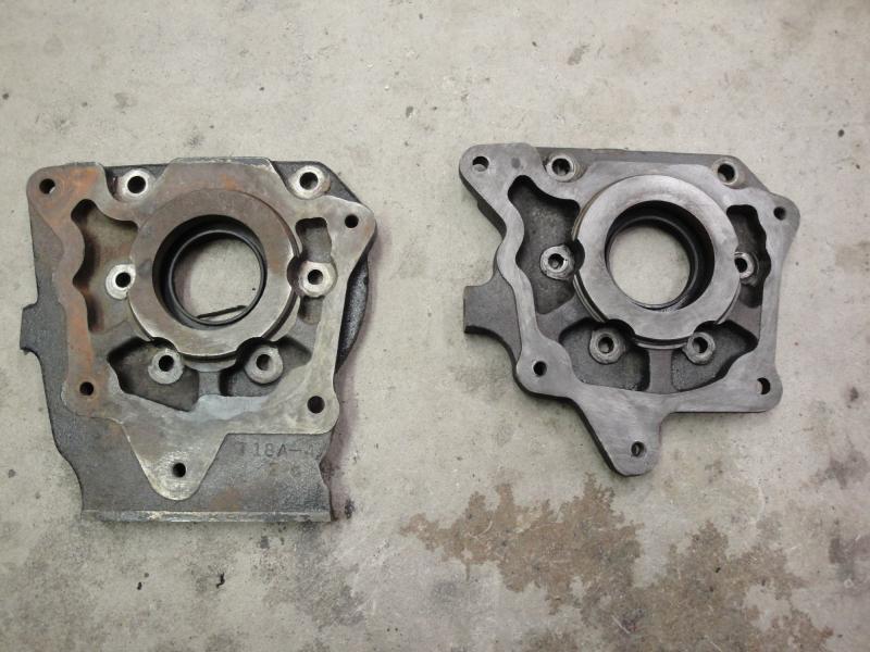

On the left is the t-18 adapter, on the right is the t-19 adapter.
