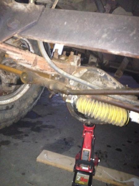

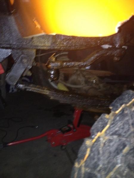

Hey everyone! Glad to be a member of this awesome community. I have spent hours digging through all the great information here. A few months ago I bought my first Scout from a guy(1978 Scout II with 304 v8 and 3/4 ton full length Chevy axles front and back). He only had it about a month because it turned out not to be what he was lookin for but gave me the # of the guy that had done most of the build work before him.
Anyways, here is my issue. When I got it, the power steering would squeal pretty bad and not really have any power when at a stop on pavement, driving around it would be fine. It had a leak out of one of the hoses, but didnt really think that was the issue. I tried bleeding it, only to overhear the fluid. After that, I figured the power steering pump was probably shot.
I then purchased a new pump last night, installed it, jacked the tires off the ground, topped off with power steering fluid and began the turning lock to lock bleeding process. (I forgot to mention I also got a new belt). It seemed to turn much easier, so I let it down, and went for a drive. The steering still squealed when at a stop and I have virtually no power steering when the vehicle isnt moving. I went back home, popped the lid and saw the liquid was somewhat foamy. However, when I jack the wheels up and go lock to lock, it isnt foamy.
Do you think there is still air trapped somewhere? Should I try a power steering pressure bleed kit? Or do you think it is binding somewhere or a bad power steering box? I will mention that they did a spring over, with somewhat of a dropped drag link (not a full z) and no drop pitman arm. I have attached some pics. I thank you in advance!!
