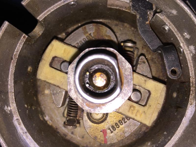

Just want to thank you all again for all your help. I am just waiting for parts to come in but in the meantime I took apart the distributor and looks a bit dirty inside so my question is should I clean it up and if I do what should I use without having to tear it all apart.

That look pretty normal. The springs look ok. The small amount of dirt looking surfaces are not going to hurt anything.
The one maintenance item would be the advance system. It turns about the top end of the main dizzy shaft. They are usually lubricated through the opening in the top of the advance shaft. There is usually a felt in there under the rotor. Apply a couple of drops of clean engine oil there and work the advance back and forth.
A drop of oil on the advance weight pivots too will be good.
