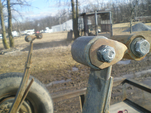

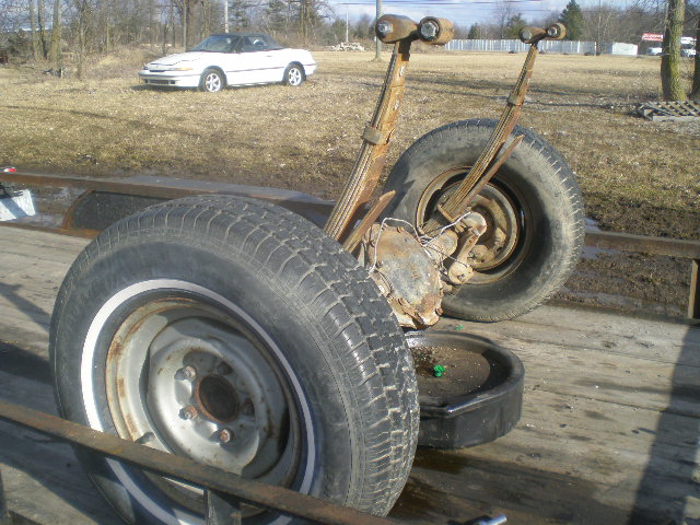

What year and model are you working on ? Rear end ratio ?Jeff
I've gotta heck of a good rear end here 3.73's,complete with spring's,bolt's,emergency cable's,will slide right under your's. $250. Came outa '70 1000 d model t' all.Jeff ( forgot,it's a d-60 )
