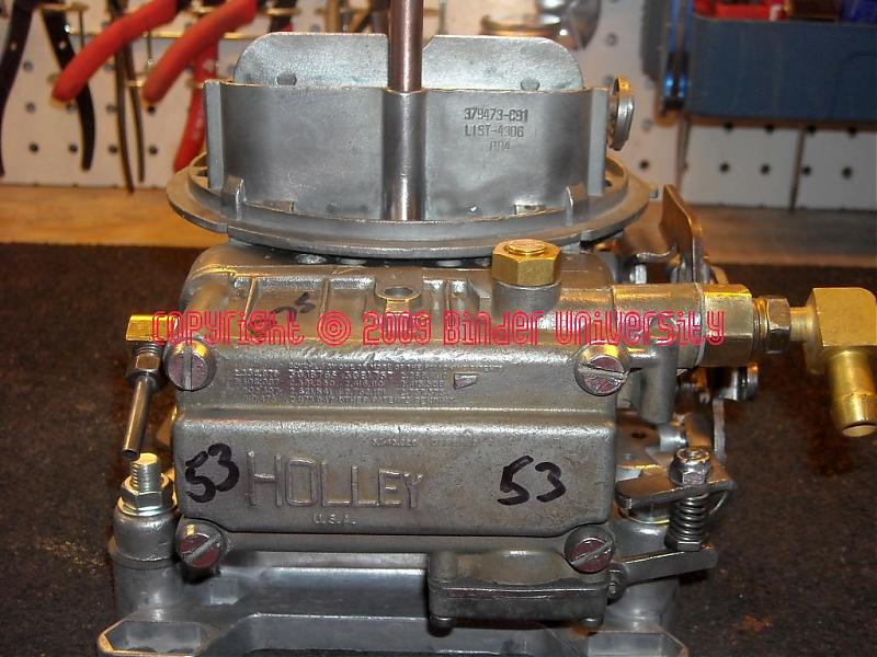

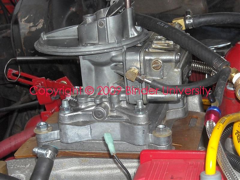

This pic is kyle's carb under discussion, an oem 2300 with manual choke and is not an oem carb on a Scout II app but is set up correctly per kyle's instructions for his specific vehicle. The vacuum tap shown is connected to the distributor vacuum advance can and is a "ported" source. Since at idle speed there is no vacuum signal present at that port, there is no need to disconnect for verifying base timing. Kyle's carb is actually "running" in that picture, can't ya hear the extremely nice idle quality it has???? And that is with the mixer mounted onna "adapter" which is not a good thing to do regarding idle quality!!!
This whole "timing" thing has existed since the beginning...that is just too strange to disregard. But without having the distributor on the bench for diagnosis, I can't say what the issue is exactly though I'm pretty certain it needs some basic luv (they all do!). I have six Holley distributors on the bench now for reconditioning, four point units and two gold box units,...they all have badly botched guts with multiple problems that can be corrected.
All Robert kenney's comments regarding vacuum fluctuation diagnosis are correct...and we know for a fact regarding the very common stuck valve/flat cam/bent pushrod syndrome has root cause in a non-oiling valve train assembly. And it's certainly not out of the ordinary to see this onna motor that anyone is trying to bring back to life...probably the most common issue we deal with here on the forum. This issue is always accompanied by a clicking/rattling lifter since valve tip clearance is excessive (unless the pushrod has spit or broken completely).
Compression testing will point to the "flat cam" (actually a valve timing anomaly) but can only be verified by either actual measurement of lift or lobe height, or doing a "leakdown" test also and comparing actual cylinder data with compression numbers to determine root cause of a compression anomaly.
The first thing to test regarding the distributor is the action of the advance can...it's either a 5* unit or a 7* unit...that has not real bearing on what is going on. But...if the vacuum can is leaking or is "in-op", then it does contribute to the vacuum issue.
If the mechanical advance unit inside the distributor is partially/fully scruud up (normally "frozen" or sticking randomly), that that will create the weirdazz timing numbers we're seeing...and no doubt someone in the past May have tried to "fix" this by wiring the plug cables into the cap incorrectly.
The first thing to do right now kyle...is to again...verify proper firing order for the plug cables vs. Cylinder numbers. I really think from your description now, you have a dead cylinder which is possibly because the firing order of the cables is out of synch (maybe just two cables swapped). I see this constantly around here because folks that don't know IH sv engine practices try and set up the distributor/cables/timing, et al like they are chevs!
So don't keep scruuin' with the carb, unless it picked up trash from a nasty fuel/plumbing issue, it's perfect! And the carb has nothing to do with the strange ignition timing situation...we gotta fix that now!
If it works best for you...when you have time to deal with this, call me (you have the number) and I'll talk ya through this in real time while yore leanin' over the fender!

As for the spark plug "color"...that carb is jetted #53 as you can see by what I wrote on the fuel bowl. If...the jetting is significantly "lean" at cruise...then the engine will exhibit a noticeable surge, as if it's running out of gas. It also has a #75 power valve installed...that would tend to mask a lean cruise condition once manifold vacuum goes below 8"hg, so when doing a plug color check, keep the manifold vacuum "up".
If you want to play with this jetting deal, then snake a pair of #56 jets at any parts house that has Holley stuff on the wall. If ya can't find 'em, then let me know and I'll send ya an assortment of jet pairs to try. To swap the jets, remove the carb, then remove the fuel bowl screws and bowl..the gasket should be reusable. The jets will be looking right at ya in the bottom of the metering block. When ya change 'em, they must be real tight!!!
Anytime jetting is changed, you must re-set the idle mixture screws after warmup..all fuel for all circuits (except accel pump and power valve) is pulled through the main jet feeds....and any main jet change affects the idle mixes also.
