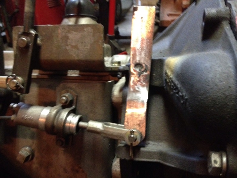

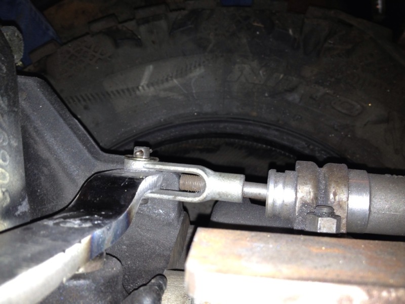

Here is my 1962 Scout 80 4wd 152 hydra clutch converted to a t18 4spd with d-18 in a d-20 case for od.
All components are stock IH 80/800 parts but the m/c used is from wilwood; something like a .68 bore and said to be a stock replacement. (same bolt pattern & stroke)
most of the fab work was done by jared (pyro3256) but I thought moving everything over to the passenger side would be best. So far everything works great.
The throw out arm still needs to be trimmed but you get the idea.
