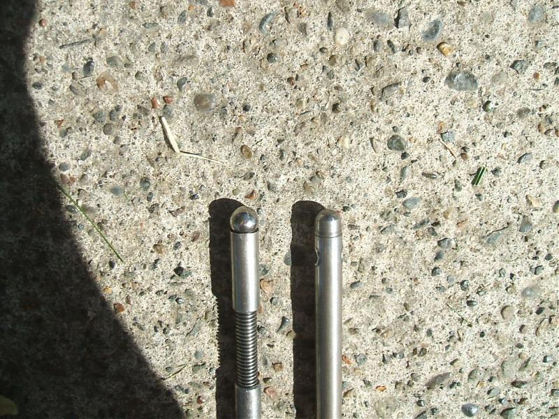

Here is the picture of the two different style of ball/ball pushrod tips I discussed above.
Both are the same to the push rod mfg. They are only built with different parts.
Easiest way to make sure you get the custom rod you want is to send an old one and tell them you want a relative length change of .0xxx".
They will do all of the needed measurements. I would leave .025-.075" preload.
From manton order a series 1 in 3/8 x .058 wall. No oil holes.

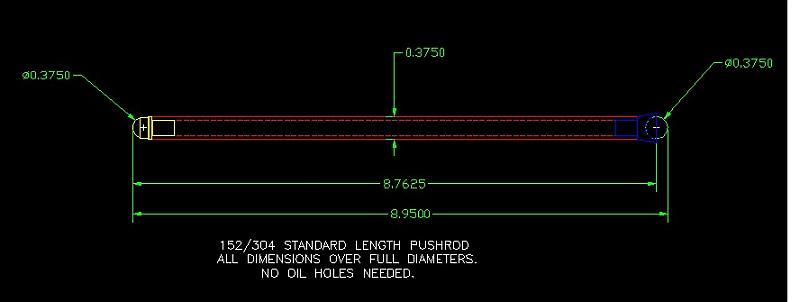

The attached image is typical for what I supply to the mfg to ensure I get what I want for any part this includes pistons, connecting rods, pushrods, valves, springs guides, etc

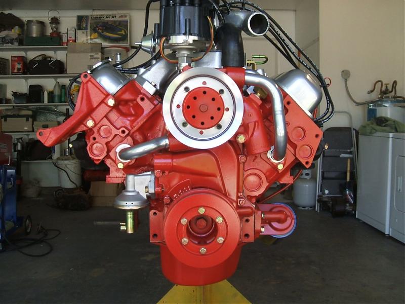

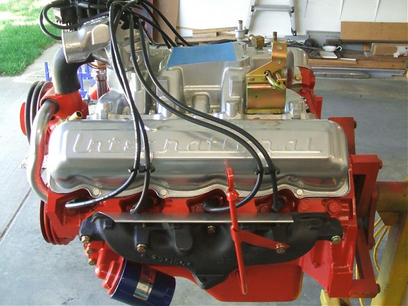

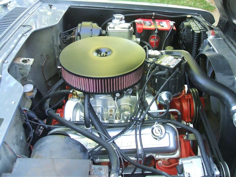

I've decided to install a Chevy crate engine, which is what I should have done in the first place. :yikes: the engine I am looking at is fuel injected, weighs 300 pounds less than my 392, and produces more horsepower and torque at all rpms. I can't turn my back on that. I'll also be dumping the torqueflite (I'm tired of trying to adjust shift points), and replacing it with an nv4500.
Don't be me wrong, I love my Scout, but I just don't have the time or the patience to go through this 35-year-old-800-pound-fickle-gorilla again. I do sincerely appreciate everyone's assistance.
Parts from this engine (dui, powder coated aluminum intake manifold and valve covers, etc.), or the engine, will be available after I remove it in a month or two.

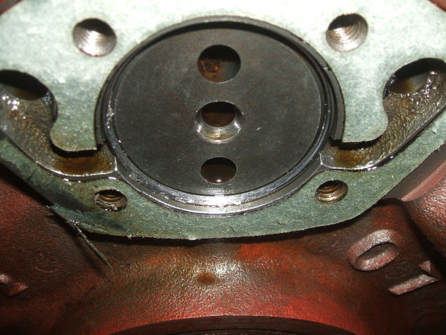

Well, after waiting about a full year to tear into this engine again, I have an update. I wasn’t able to much for the past year because I bought a new house and this has a way of depleting ones bank account, but a couple months ago, I had the time and money to get back into it. I pulled the 392 out, not marking anything, because I fully expected to be putting a chevrolet back in. I had the engine, transmission, adapters, etc. All picked out. Once I had the 392 out, I took off the rear cam plate and this is what I saw.

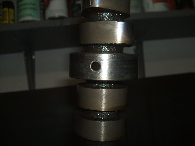

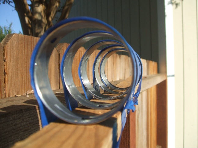

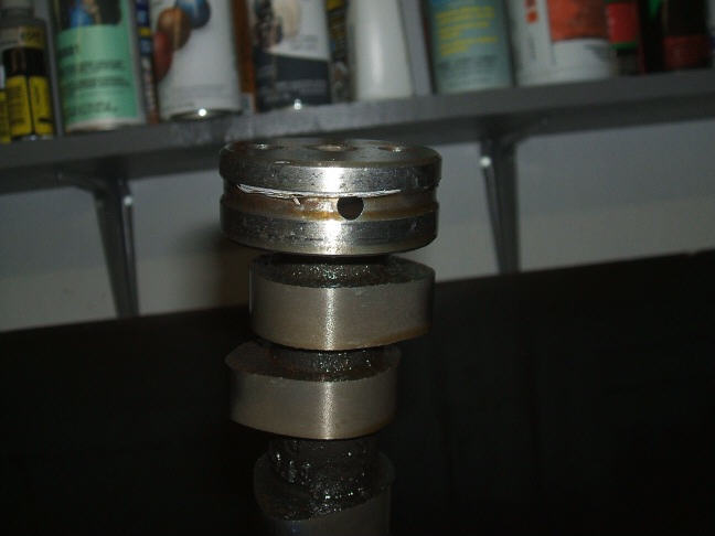

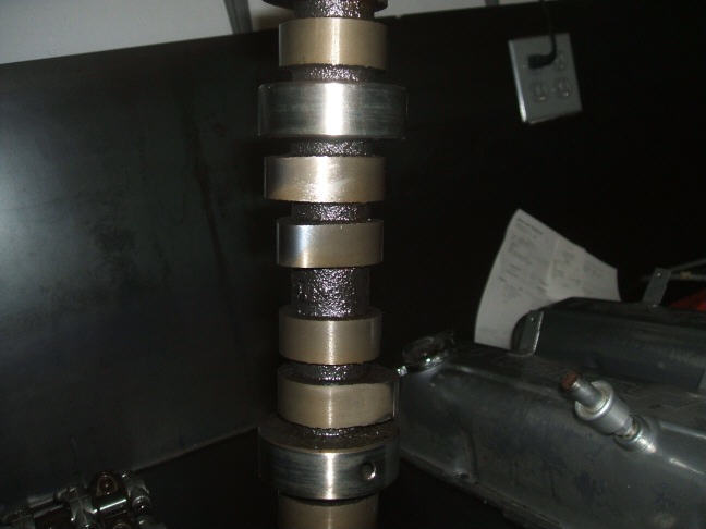

After the swearing stopped, I decided that since the engine was out, I might as well pull the cam out. And this is what I saw when I looked at the bearings. Note the babbit smeared up the sides of bearings 2-5. (I have removed the bearings and taped them to a stick so I could take a picture in the sunlight.)
Note how only bearings #2, #3, #4, and #5 shown extreme wear. I called Robert k, emailed him the pictures, and after a couple more conversations, we figured that the problem was probably improperly finished cam journals. The only bearing that did not show extreme wear was #1, and that was the only journal that had a nice mirror finish to it. All of the other journals were rough. Here are a couple pics of the journals. Note the pitting on #2, #3, #4, and #5.

This was a new cam from camcraft. When I got the cam from camcraft, I had noticed the lack of a mirror finish on journals #2, #3, #4, and #5, but they had a good reputation, so I put the cam in anyway. It’s easy to say now I shouldn’t have done it. One of the most frustrating things about building a vehicle is that it seems about half of the stuff you buy brand new is still junk.
After a lot of thought, I decided to try a new cam, lifters, and bearings, rather than go straight to the Chevy. I bought a new competition cams 252h cam, comp lifters, and durobond bearings. I put it all back together, installed the engine, primed the oil pump while rotating the engine, started it, and….no lifter noise.
I then drove it to the Sierra Fall Rallye and won best engine, best 1971-1975, and best in show.
I now have over 1600 miles on the engine and I have had no lifter noise other than an occasional very quiet ticking for the first few seconds at start up. Nothing like the cacophony of clacking that plagued the camcraft set up.
I figured that if I got past 1000 miles, I would know if I solved the problem, because it took about 1000 for it to show up on the camcraft setup. Since I now have 1600, I think it is safe to say the problem was a poorly finished camshaft. I changed nothing else.
I have sent the cam back along with the bearings to camcraft. I’m waiting to hear back if he is going to refund my money for the cam, lifters, and bearings.
