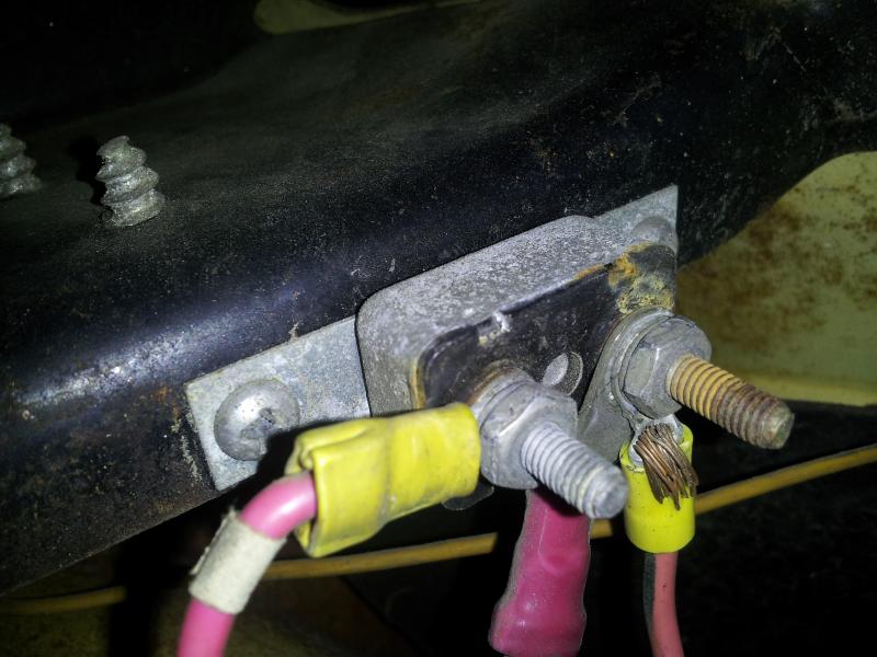

Hi guys 63 Travelall 2wd and im trying to find out what this part that seems to be a hub that my power rear window wires are connected to. It is located under the driver side.
Circuit breaker possible. All the early IH's did not have fuses, a relay was used. They pop like a fuses and reset in a few second/minute. Don't know the part number or exact name for it. If it is bad you can replace with a fused link.
